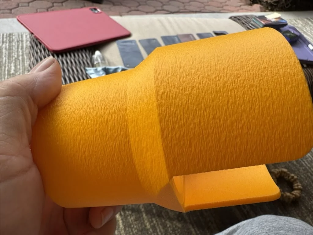

Did you use "fuzzy skin" to get the texture? I worried about PETG here in Los Angeles County area and so far it has held up printing that same Hydro Flask adapter. I've also printed a few parts for my work car out of ABS and ASA , which are holding up pretty good. I like the idea of the HT PLA, but at what cost, when other materials that will work are dirt cheap. The exotic stuff gets real pricey real fast.
Yeah, I have a really nice fuzzy skin sample kit so I looked for one that would be "car like" in appearance. It looks good in the car.

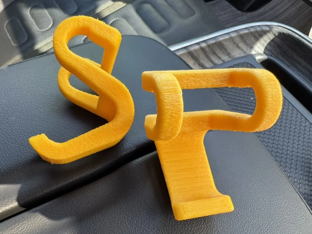

I also wanted to point out that given the layer lines on your hooks, they won’t be super strong. I printed them that way the first time and they snapped with only moderate force. Printing them in their side produces a drastically stronger print. Not sure it would help with heat creep though. And if you’re only hanging stuff like a hat, this won’t matter… but put a full water bottle in one and it might crack/break.
Those aren't layer lines, and I've completely solved this for my prints, but it's worth talking about for others who may be interested. I've printed (and broken) at least 15 iterations of those hooks in every orientation, fill, wall count, joint scarfing, etc. It's hard to get good looks and strength together. The ones you see are strong as hell; you'd damage the car before they break. What you're seeing are a combination of the remains of supports and the fuzzy skin running predominantly in one direction. Fuzzy skin can actually add strength, not just looks and friction (so things don't slide off).

Well, those are definitely layer lines I see, especially on the hook on the right indicating that you're printing them as it's seen here with the hook upright and the bottom of the hook on the bed. That's awesome that you've got strong hooks, but I suspect that's more because you're using PA-CF or because you've dialed in your PA-CF printing to have very good layer adhesion. I've never used it, but maybe it's able to melt between layers better than other materials so orientation is less important? I mean, it's some pretty strong stuff, so maybe for this application the orientation matters less than wall count and other aspects. I hadn't thought about how fuzzy skin could help with strength too. That's cool. I just pointed this out because if someone prints them in PETG or even just plain ASA/ABS I've had these split somewhat easily. Printing them on their side solves that for me. That said, I did recently just buy some PA6-CF and PC-GF to see if I could find a better material for inside the car (notably up on the dash where sun exposure and higher heat is sure to happen).
