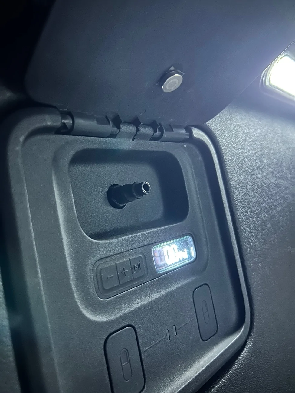

Print a strong latch for the compressor cover in the R1T. I bought an after market one online and it broke into 4 pieces first time I pushed it into the slot. The plastic was brittle and honeycomb, not solid or strong. Rivian did not make a good latch so the cover is often open and subject to getting broken off.

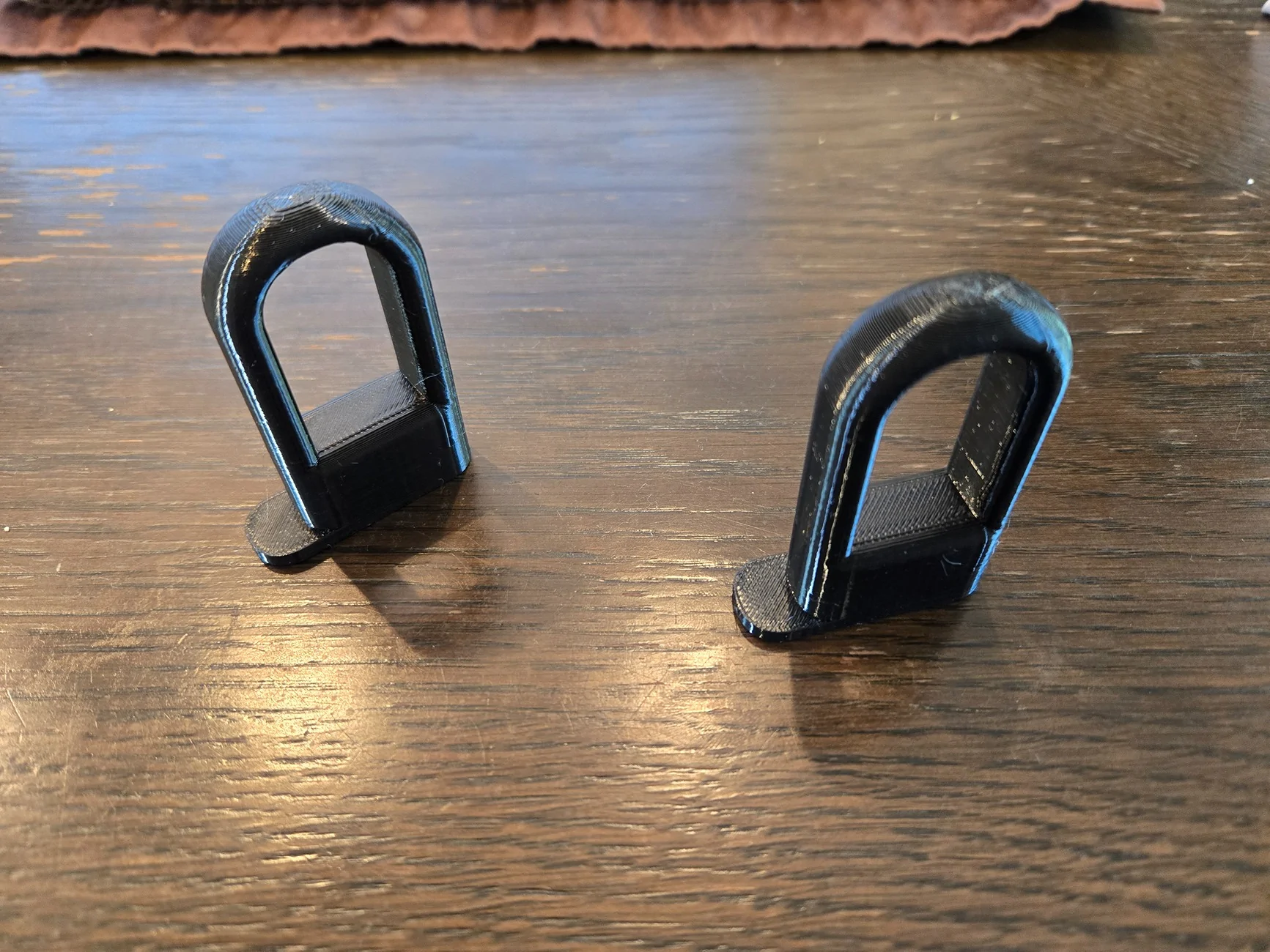

Is this the one you bought? These have a shackle loop that go into the cable lock receiver and hold the door in place. A lot of the printed parts you buy online have a very low infill percentage value to save money on material. I'd probably print something like this at 85 - 100%. I consider you one of the OG's on this board, so I'd print you one for an emailed or snail mailed return shipping label. I don't have an R1T, but can try it across the street at my neighbors house.
https://makerworld.com/en/models/1468006-rivian-r1t-compressor-door-lock#profileId-1531687

You are correct, having the right material is just as important as layer thickness, infill %. I'd probably make that part in ASA for the UV resistance, but PETG would also probably work, since that part really isn't seeing any kind of force placed against it. I ordered a large format CoreXY printer, that comes with a heated chamber. I have a couple items I want to print in Nylon with CF and my current CoreXY is kinda limited with exotic materials.

not to break up a friendly forum deal, but a simple glued neodymium magnet on the lid has worked perfectly to me. I’m an avid amateur 3d printer myself (following this thread in the hope that OP @trez63 will send out that coveted .stl file :cool:) and love some custom 3d printed solutions, but in my experience this simpler approach works great.

The magnet thickness needs to be how thick ? ?
It can vary because the lid is on hinges. The magnet I used is 1/8” thick. I placed it on the compressor nozzle, then (I think) used a small square of that “alien glue” tape. I put the double sided tape on the magnet while it was on the compressor nozzle, closed the lid and held firm long enough for the magnet/glue to seal to the lid. It’s been on more than a year now, maybe more.

As part of the R&D department for Rivian related prints.... I took upon myself to print the RIT compressor door locks, even though I own a R!S. If you bump the infill percentage from 15% to 85% in PETG, they are strong enough for government work.
If the OP posts his STL file, I will provide my testing services.

I'm not sure why that was in response to my comment, but...I have to note that PETG does not survive inside the truck in Phoenix. I talked to Polymaker's chemistry engineer and he said he was blown away, but they are in New Hampshire. The weight of just sunglasses will make your sunglass clip sag and drop them in our heat.
I've made no-load parts from their PLA-HT-GF which works great, and is nearly the perfect color for Rivian accents.
