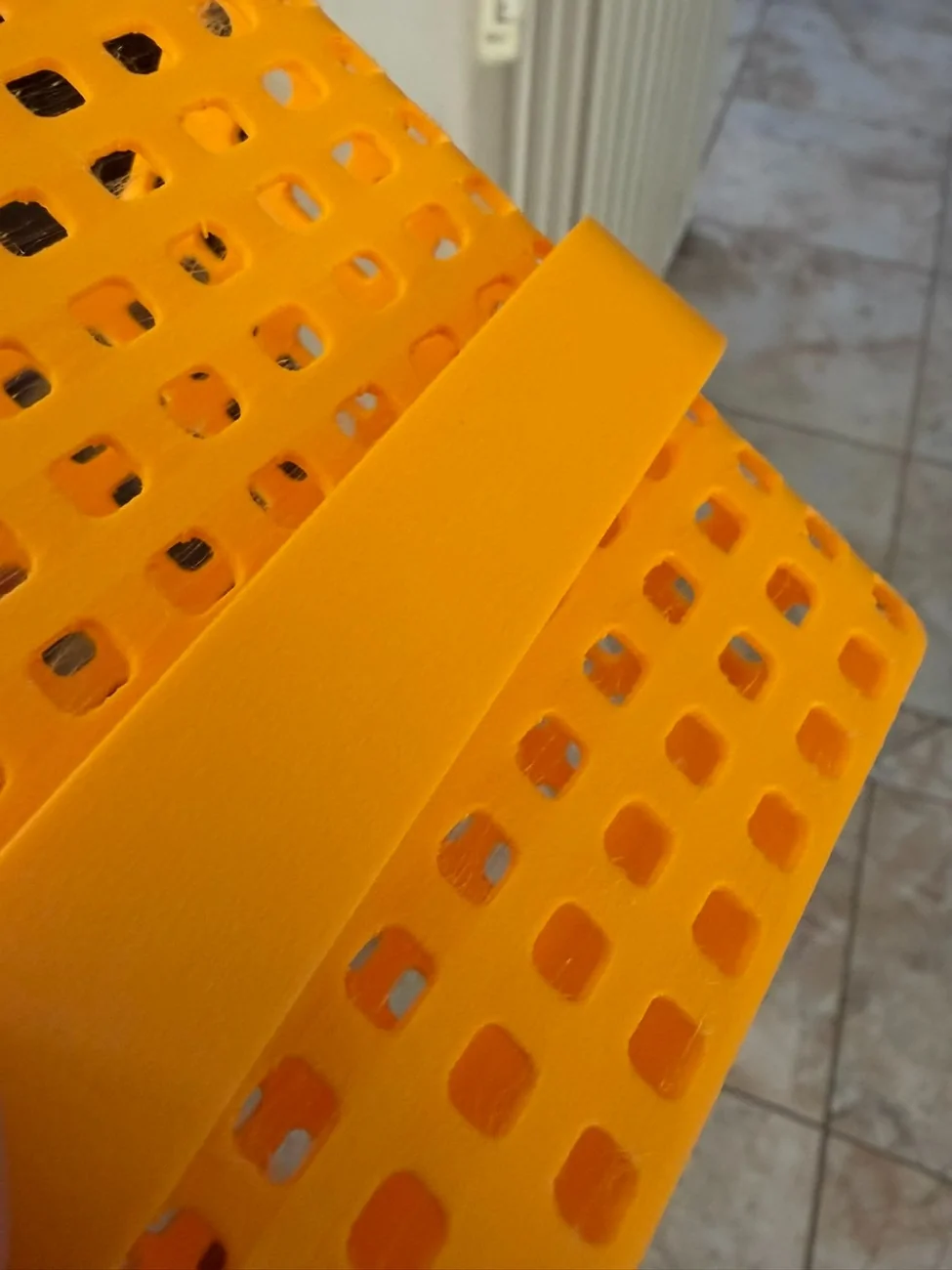

Carbon is black, so all CF is black. Glass is clear so there are a lot of colors. PA is off white, so anything other than white is possible, and maybe someone has come up with a white, but I've never seen it. Speaking of which, Sunlu Easy-PA in natural color is a wonderful thing to work with! And cheap. Just not pretty, but great for mechanical parts in the shop.
And mentioning again, this stuff is nearly identical to Rivian yellow (within a few RGB points). Super easy to work with, great surface (not slick or shiny, nice car surface).
https://amazon.com/dp/B0DZNH3MKV

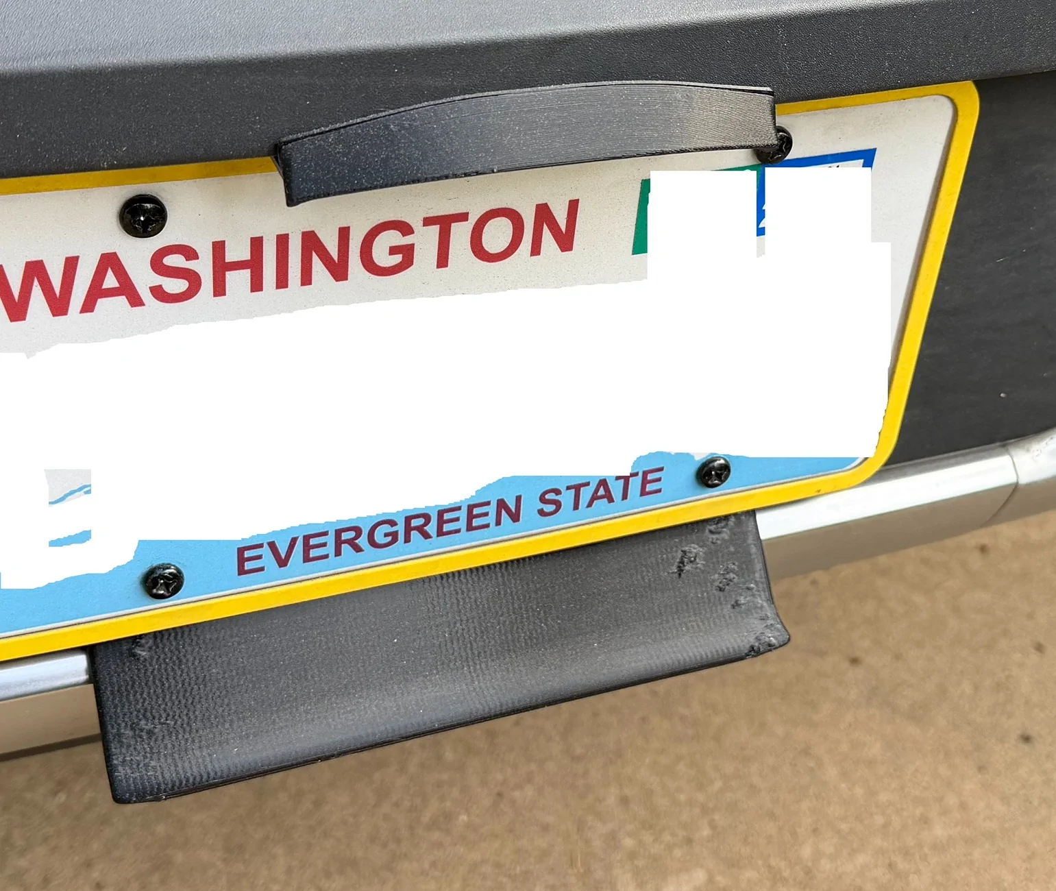

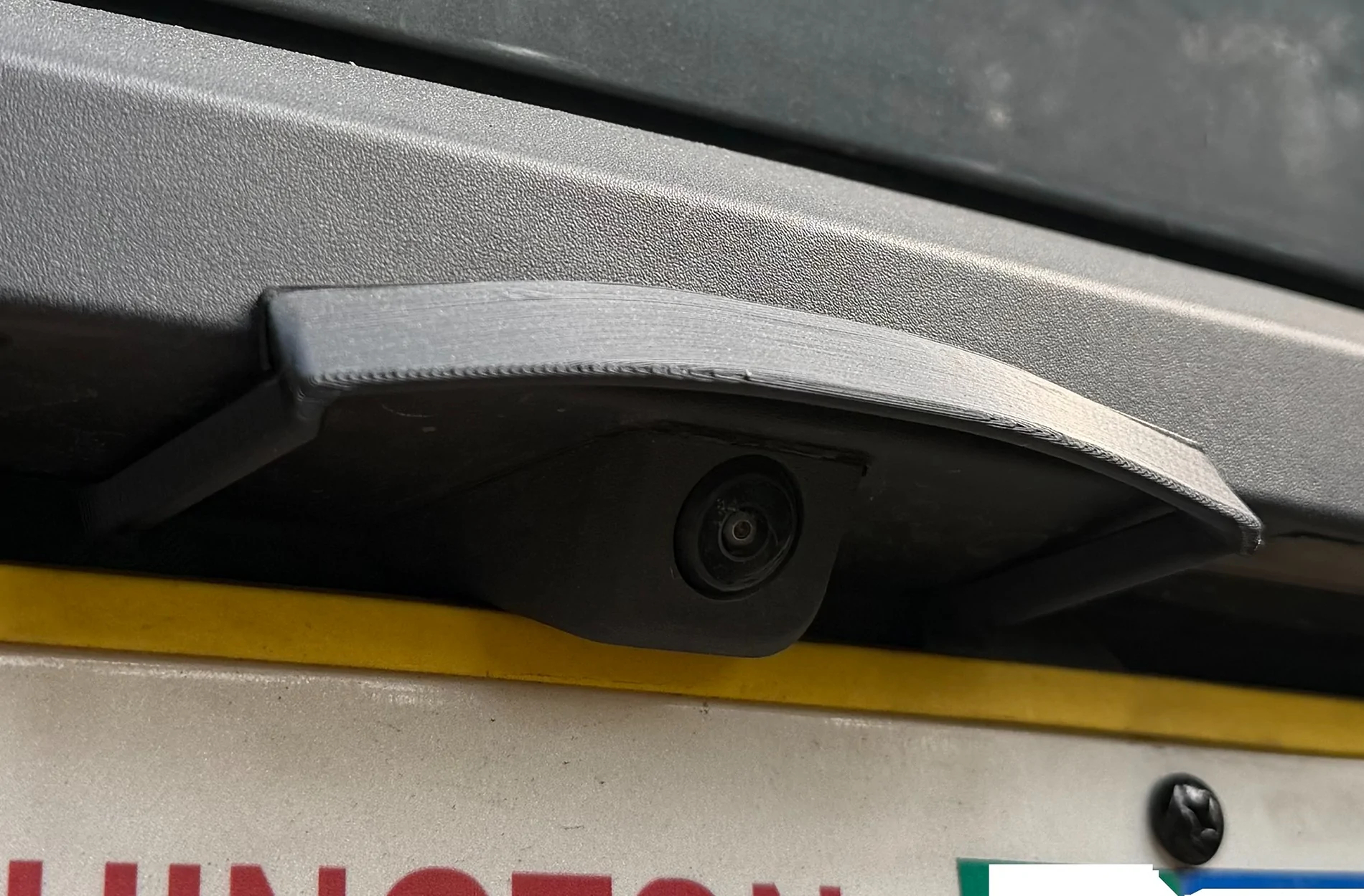

Just wanted to give a quick update to anyone following this thread - I ended up making my own rain cover; shout out and credit to @trez63 for the inspiration.
Rivian R1T R1S I designed a rain cover for the reverse camera IMG_4414
Rivian R1T R1S I designed a rain cover for the reverse camera IMG_4415
I made a few revisions to the design since I put this one in the picture together, but it's mostly the same. I moved to a 2-piece design using a rigid material (ABS or similar) for the main cover part, and a flexible material (TPU) for the "gasket" piece. The gasket is ~1.5mm thick so it you don't want to print that little piece, thick tape or gasket material should do the job.
I'd recommend putting something back there not just for sealing purposes, but the print isn't 100% smooth and may leave small scratches on the bumper. It's a couple cents of insurance...

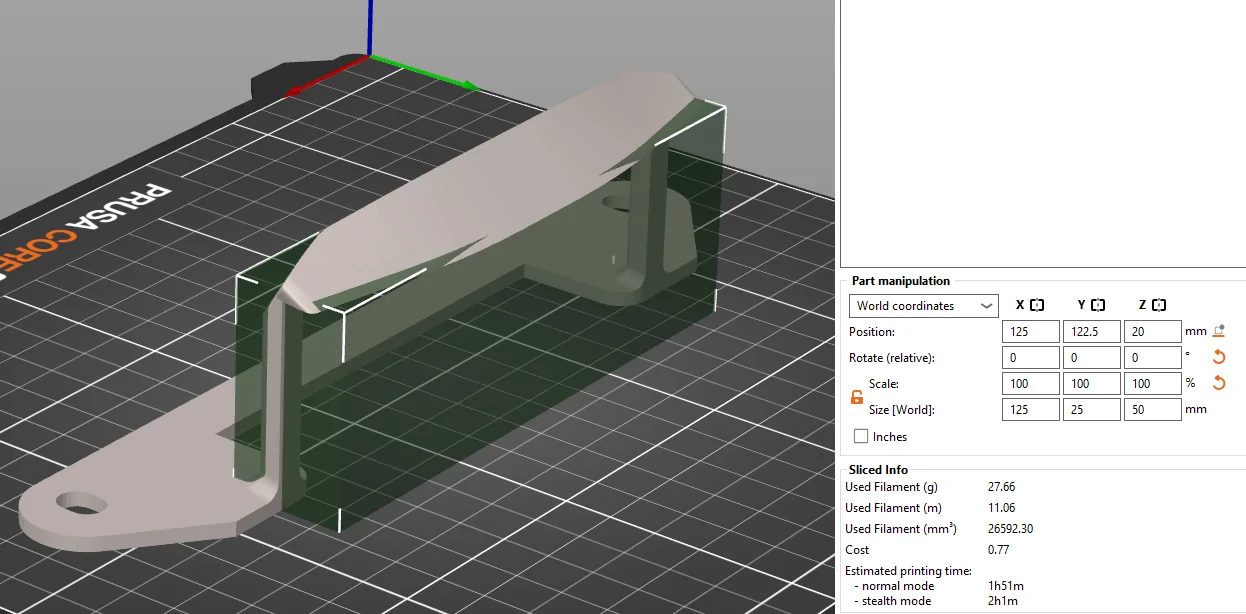

Printing specs were 0.20" layer height at 20% grid infill.

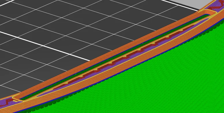

I've had the best results printing the cover oriented with the mount portion down and using supports. If you have the option to choose support surfaces or limit support contact points, I suggest you keep the support material out of the gasket groove in the back; it's just easier to clean up. If you run a Prusa, I've included the support coordinates below and a picture of the gasket groove without the material (the inside of the groove is rounded so it doesn't need support).

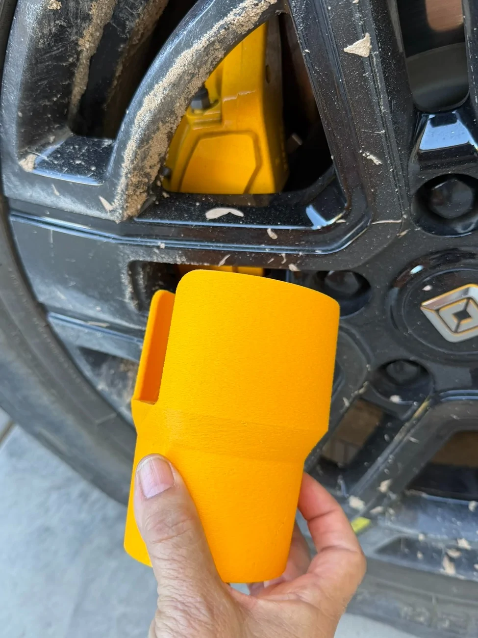

I'm also playing around with a "diffuser" add-on (the other printed thing in the photo) after my CFD buddy said a lot of the dirty droplet build-up could be wash from under the car. It hasn't rained enough recently to test it thoroughly, but if I notice any improvement, I'll post an updated, less obtrusive design.
