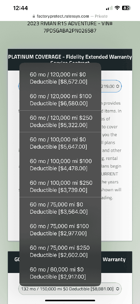

I don't do extended warranties, but I wonder what a 1 year extension would cost for one of these things?
Here you go. $3,300 for one extra year and 20,000 miles with $0 deductible. Subtract $500 - $750 for 10,000 extra miles.
prices increase every calendar year and as you add an additional 10,000 miles.
cheapest pricing is buying the warranty the same calendar year as purchase and before 10,000 miles driven.
Very interesting! Thanks for sharing!!
