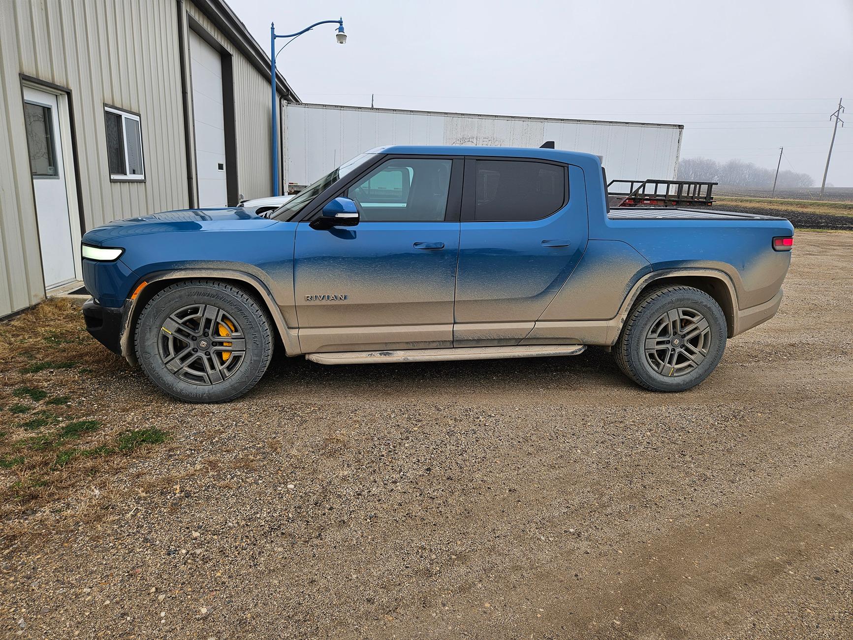

Wash? This is my truck after one day. I can't drive gravel roads and keep it clean. I gave up and just wash it when we go nice places.
