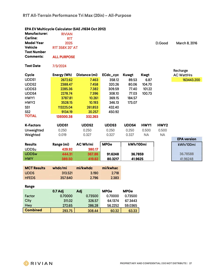

We traded our three-year-old 2022 canyon red R1T in on a 2025 tri max yesterday. I think we got one of the last 2025's and it had the promotion with free paint, off road all terrain package and max pack all included. My question for all of you that have had these for a while is the range shows 293 miles at 100% in all purpose. On the website it shows 329 for 20 inch wheels at 100%. I asked the salesperson and he said it would come up with my driving habits. It was 1 decree out so I thought that might affect it too. In our 2022 at 100% it always went to stated range of 319 in all-purpose with 21 inch wheels regardless of temperature. Is this normal and will it adjust as I drive more?

Normal. There is no 329 mile range driving mode, see here for an explanation with 22" wheels - but the same applies for all sizes: https://www.rivianforums.com/forum/threads/mkbhd-gen2-r1s-review.40386/post-728366
Also rivian as of today makes NO adjustment for driving habits etc - it's all just a fixed multiplier for a driving mode against the SoE in the battery. The reset button in the energy app only puts a timestamp marker on your telemetry - nothing more (confirmed in writing Q3 2025, however of course this may change in the future).
Edit: see page 27 here for where the 293 you see displayed comes from: https://dis.epa.gov/otaqpub/display_file.jsp?docid=61445&flag=1
