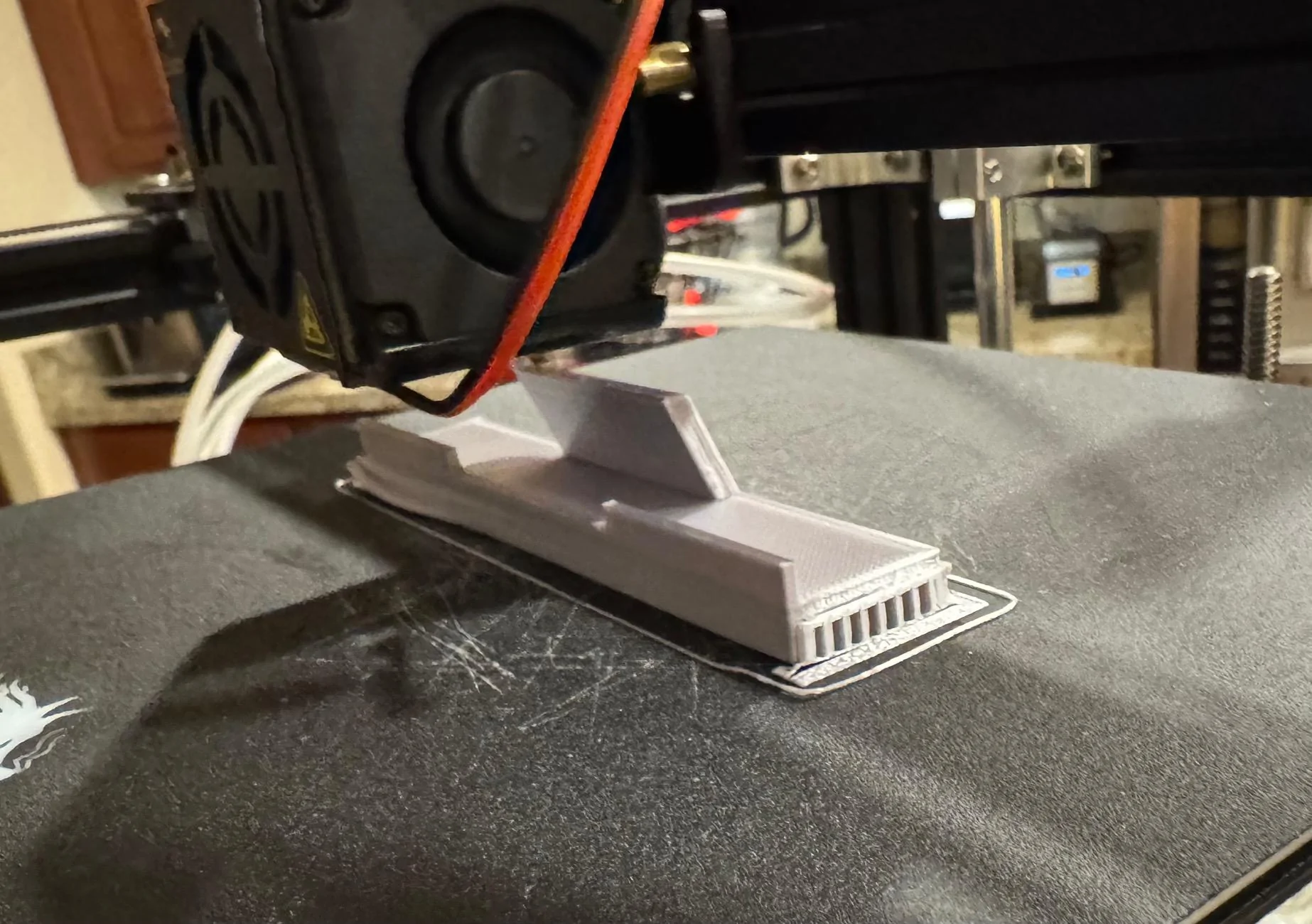

Printed another one, that I like a lot more...
Rivian R1T R1S New device providing Carplay for Teslas - Teslogic Screenmate 1729525409232-so
PLA is useless for this, I think this might not even survive a test fit. It's so brittle. I need to get an enclosure for the nylon-carbon, and have some other upgrades coming like hardened nozzles.

PETG should work well with 30% infill. I've made quite a few automobile related items in the past, PETG easily survives cabin temps without distortion for years. No special enclosures or nozzles needed, and it's dirt cheap.

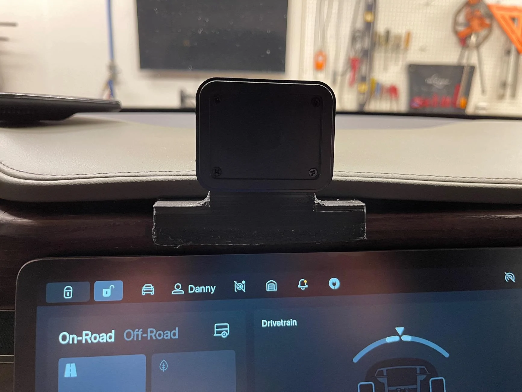

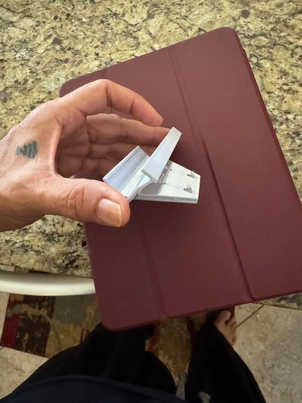

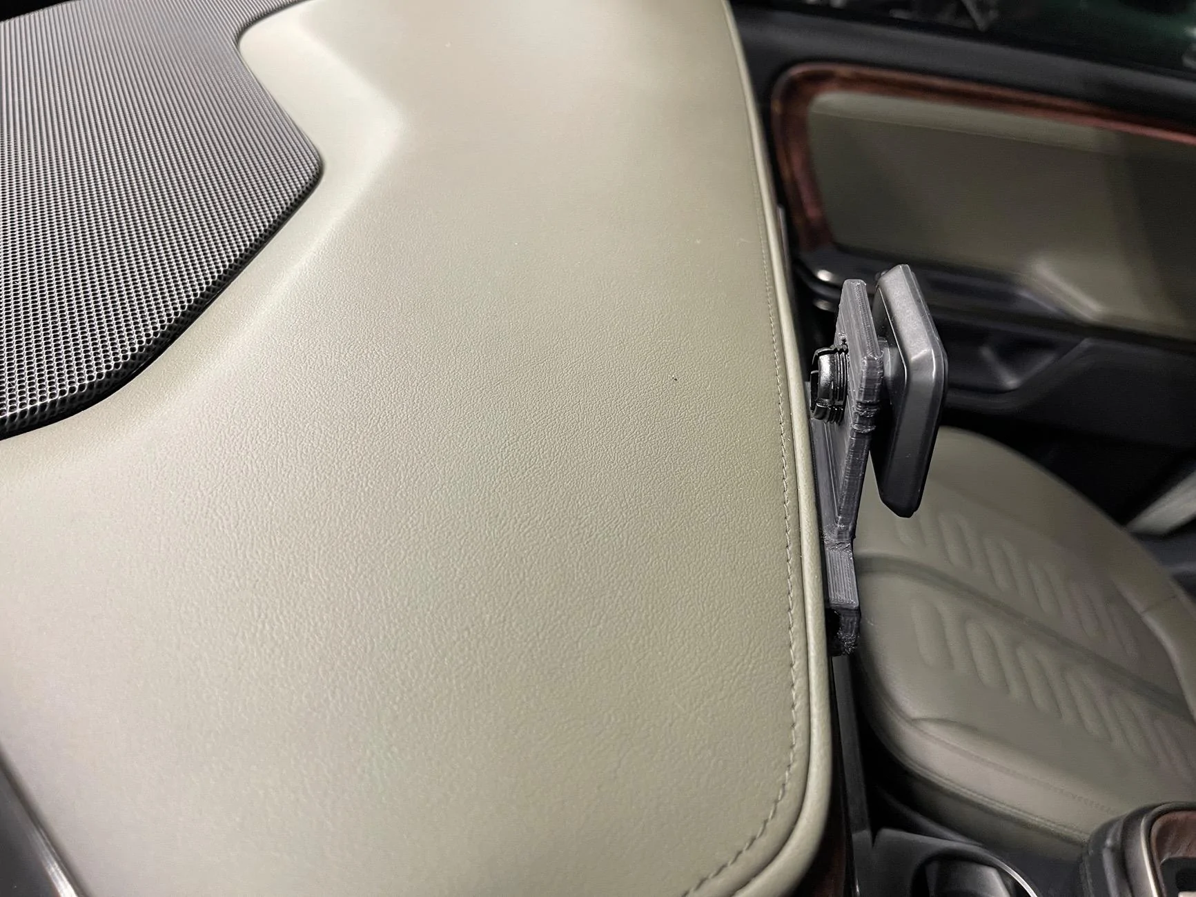

I too tried PLA at first, just to get in the ballpark for the design since that’s what I had handy. I did get it to work okay but the sun beat on it good and it bent it.
I was going to try ABS but read up on others having luck with using ASA for automotive parts. It definitely has held up to the sun better, but is a pain to print reliably (at least on my printer). I should try out PETG next time.
I would like to try a CNC at my work sometime and get one made out of aluminum! Not sure that’s worth the hassle since I got my ASA one to work pretty well so far.

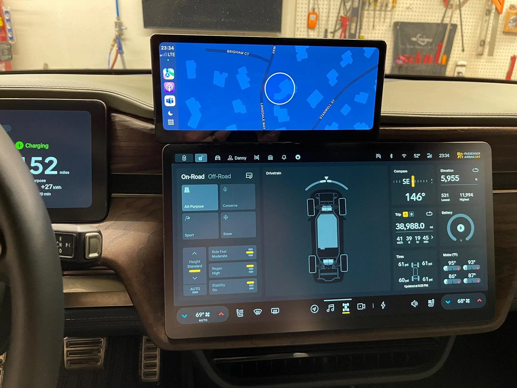

of course starting just this weekend, I’m now having connectivity issues with the screen ?‍♂
