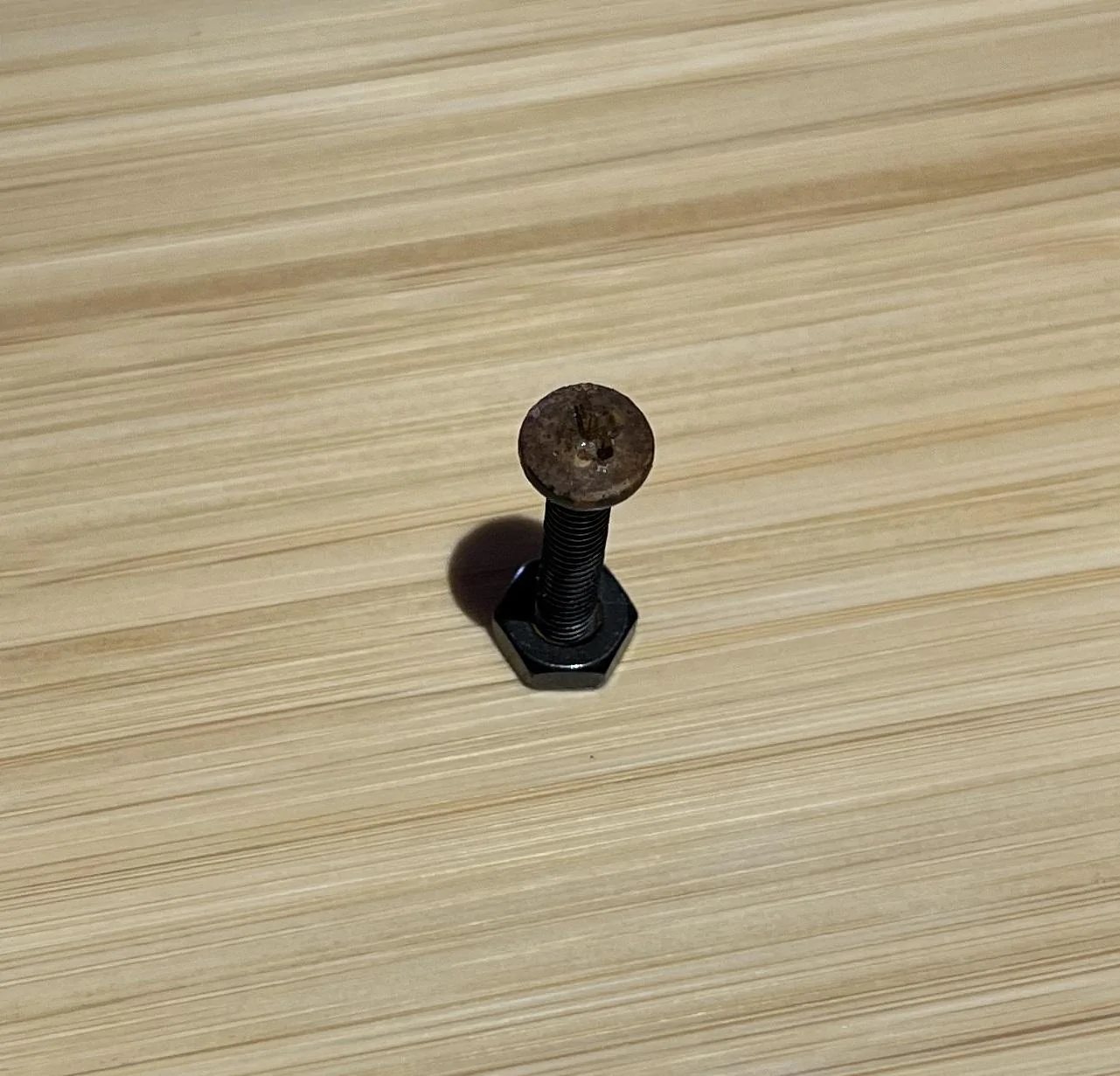

The brainexploder one is holding up well after several months. However, there's one issue. The main mounting screw (8-32 x 1" machine screw) head was covered in rust and the nut below was starting to rust also. I replaced both parts today with stainless steel versions w/ a torx drive.
Rivian R1T R1S New front license plate holder r1tplateold

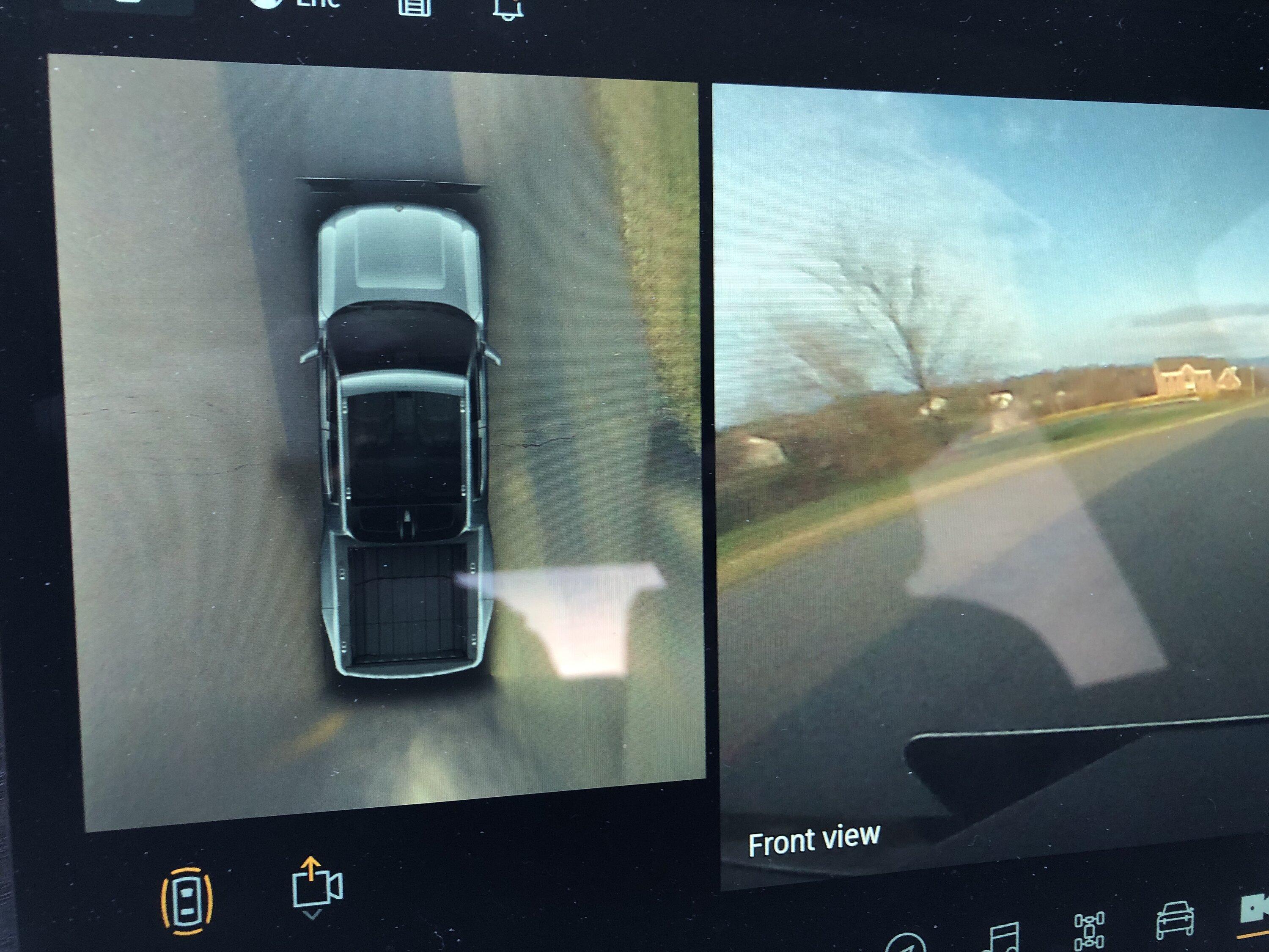

Seems that every image shared of the overhead view shows what looks like a snow plow in front of the truck (the camera sees the very edge of the license frame and assumes it's the full width of the bumper rather than just being a few inches from the camera and only the width of a license plate. Can you show a screenshot of your overhead view?
Rivian R1T R1S New front license plate holder IMG_3378
Maybe that is bothersome to some...but it is obstructing about 1" from the front of the bumper which might translate to a foot or two on the ground.
