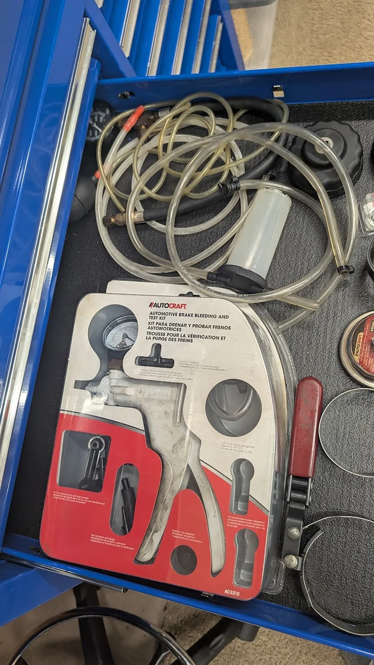

Back when I was doing a lot more of my own car maintenance, I'd take a turkey baster and siphon out all the brake fluid from the reservoir and replace it about once a year. Cost about $5 and took about five minutes. Was it as effective as a complete flush? No, of course not. But better than nothing I suppose, right? It'll all mix in there eventually. (yes yes, I understand about pressure meaning the fluid at the far ends of the lines probably never cycles through). 🤣🤣

Not as important on an EV as an ICE car but the fluid that is in the chambers of the ABS system, master cylinder and the calipers needs to be changed as well. You did the first part right...just need to attach a pressure bleeder like the Motive and bleed the fluid out of each caliper until you see new fluid.
I would stick to 3 years but if you wanted to stretch it, get a brake fluid tester pen that tests for water content. Change before it reaches 2%.

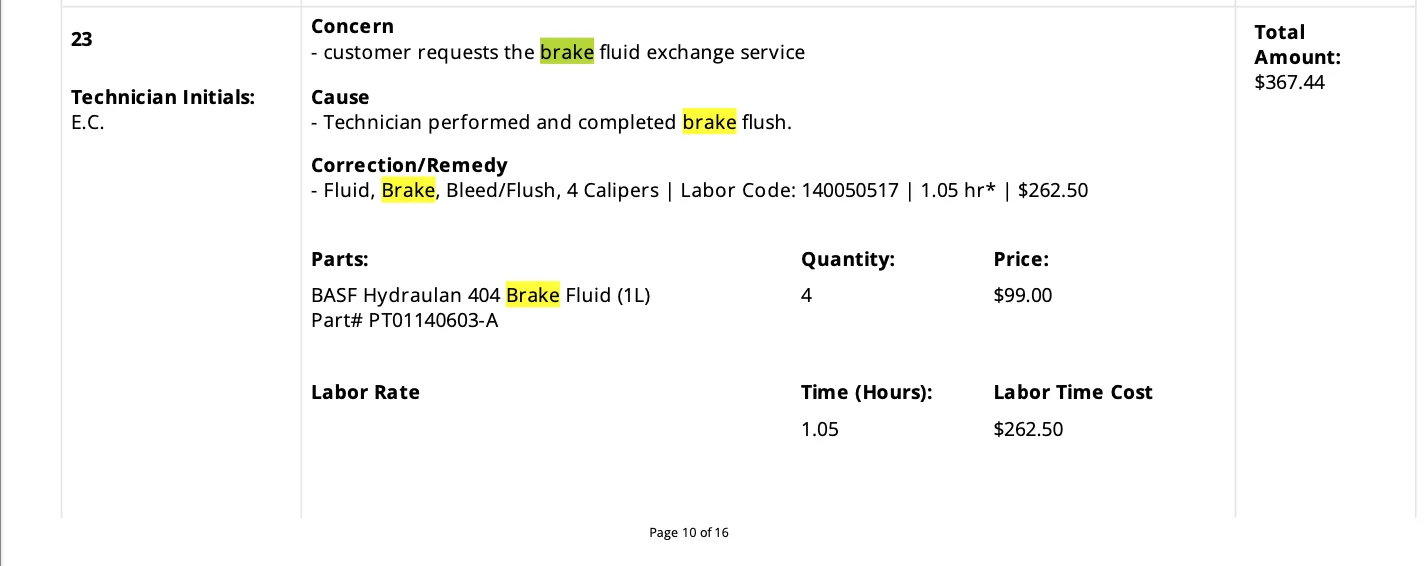

I don’t mind having the brake fluid changed every 3 years. The motorcycles get new brake fluid every year. I wouldn’t mind a little goodwill now and then...
Rivian R1T R1S New R1 (R1S / R1T) Maintenance Schedule Screen Shot 2026-03-23 at 3.26.20 PM
Receipt is from the Gaithersburg SC.
