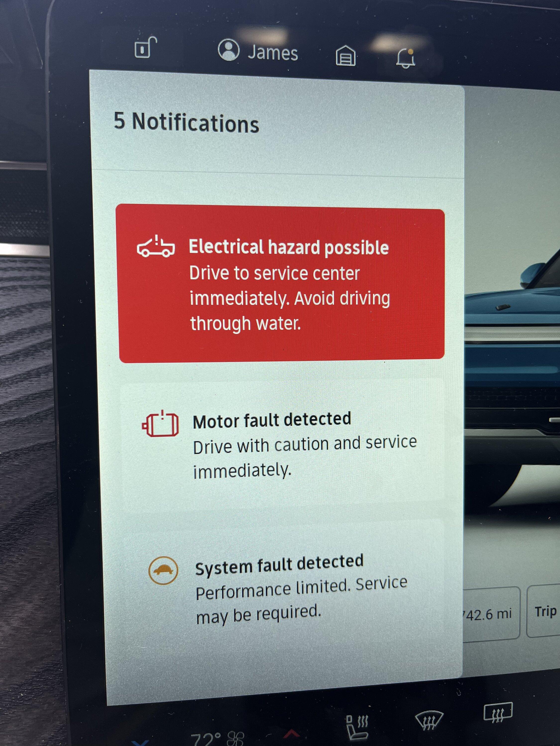

My truck is broken again, first my phone was unable to connect with the truck as a key and now I have errors in the motors and suspension. Speed is limited to 51, Front Wheel Drive only, service suspension soon all lit up. Yay.

If the suspension is not functioning and the speed is limited they have to tow it
I’ve done three hard resets. Each time the errors clear but return again shortly. Sometimes just one then others later. Sometimes all at once.
Just went out again and they had all cleared. It did not sleep after the last reset. So confusing. Really damaging my confidence in the truck.

Truck is now bricked on the side of the road with what looks like a motor failure. Sub 800 miles. So disappointing.
