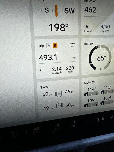

I'm close to 500 miles on my Terra Grappler G3. They are the 275/65R20 116 version. There has been a significant improvement on my range within the last 150 miles. My average is now at 2.14. Which is my R1T life-time average. The tires are inflated to 48psi cold. After driving around for a bit, the PSI will raise up to 49-50psi. Curious to see what another 500 miles will bring. Don't be discourage if you average is low when you first get them. I was contemplating switching to the Toyos. Glad I stuck with the G3.

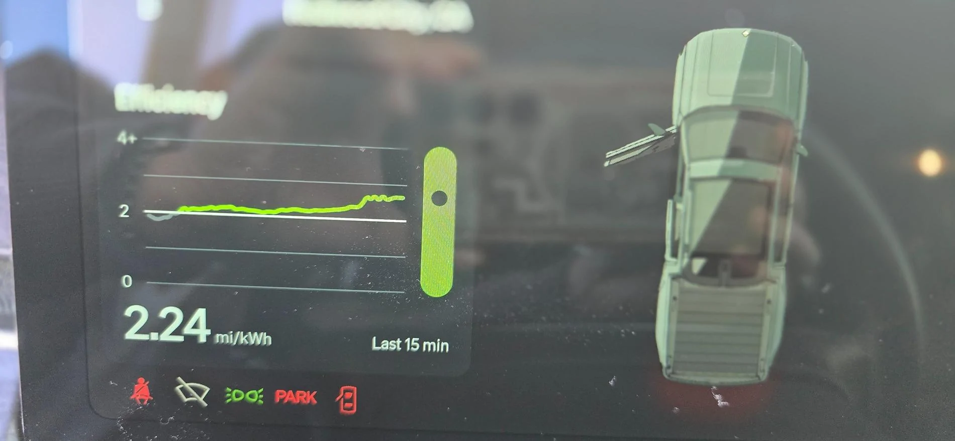

nickatnitetonite
Nick
Nov 26, 2023
San Francisco Bay, USA
Finance
Did a drive down the 101 in SF Bay. Elevation change along the route was negligible (10-50 ft difference) and was traveling between 60-75 mph in AP mode. Last 15 minute chart is giving me optimism but I only have 250 miles on these tires.

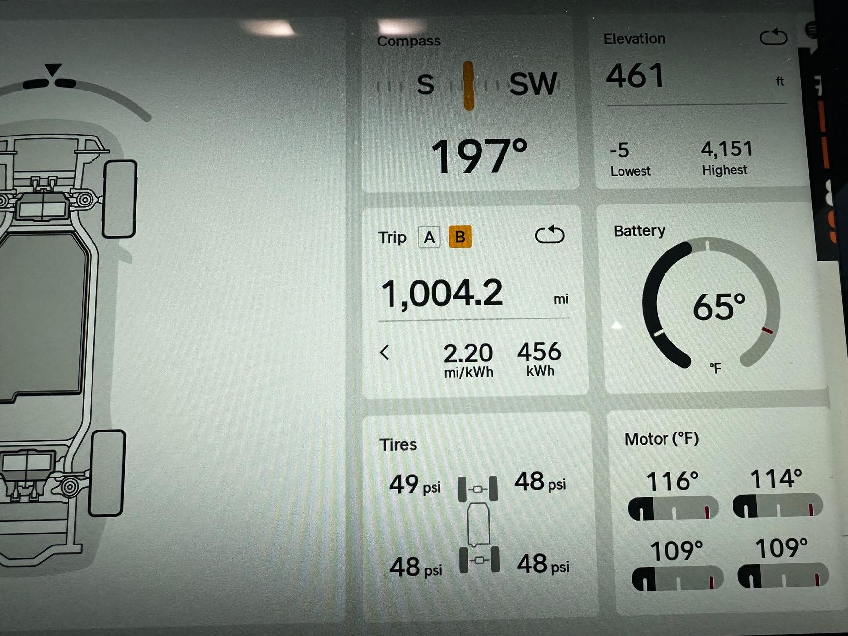

Looks like efficiency is maxing out at 2.20. Here is my 1000 mile update. Only drive in AP mode. Very little HVAC use (waiting for SC to fix it. After my previous service it’s not draining so it smells like moldy water).

It took more than 800 miles for my tires to hit max MPK. Is your cold tire pressure at least 48 psi? I would double check to make sure, I usually see 50-51 psi once the tires warm up from driving…you also might reset to get a better idea of what your efficiency is, colder weather prob. dragged MPK down a little too…
Jason C
Jason
Oct 21, 2020
372
336
Redondo Beach, Ca
Rivian R1T Gen 2 Tri
I’m going to check my tire PSI tomorrow morning before I head out. I’ve notice 1 or 2 psi on these tires make a huge difference in efficiency. Due to the colder weather we are having in SoCa, I had 2 tires at 47psi and 2 at 46psi this morning.
