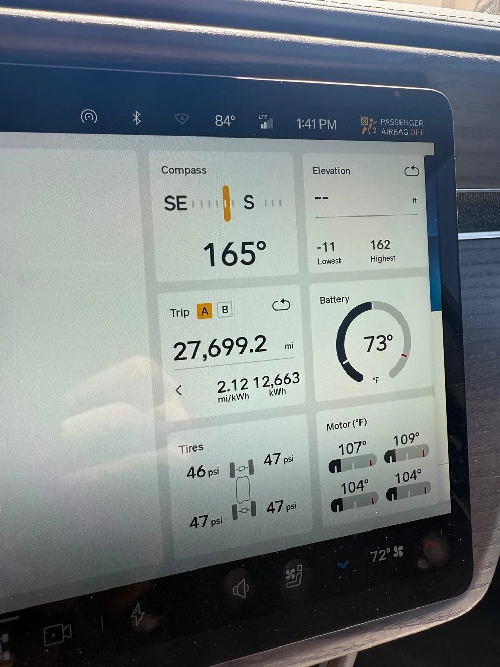

So just a follow up from this post:
The deed is done.
I went with the bland side out! I actually like the look…not sure what that says about me but my wife says my favorite color is taupe.
Driving is real smooth on them. Very quiet on normal roads but a bit of hum on the interstate. Hopefully they will wear in…still quieter than the pirellis.
I checked my efficiency stats right before they swapped them out:
(Please forgive the dirty, smudged screen!)
I will report back after my upcoming road trip!
I just took a screenshot of my efficiency and I am happy to report that after 2300 miles I am still right about the same as the pirellis.
Rivian R1T R1S Nitto Terra Grappler G3 tires available IMG_0458
please keep in mind I just got back from a 3 hour (each way) drive to Orlando and back and I am known not to drive too efficiently on the interstate (85-95 mph) so that may be skewing the results a little!
