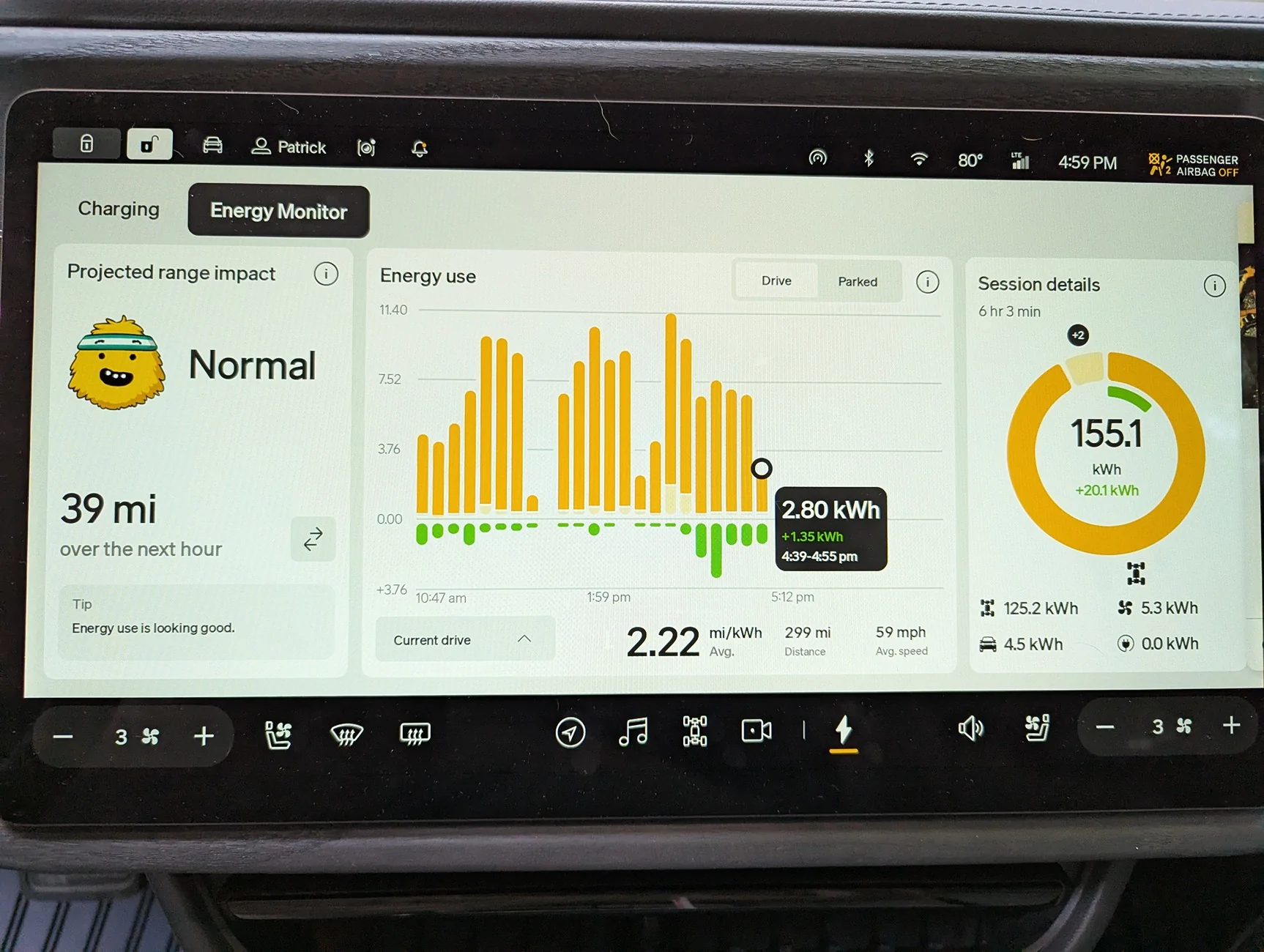

Checking in after about 5k miles. My lifetime average efficiency sits at 1.75 however I haul a motorcycle in the bed on most longer trips which tanks the average quite a bit. I have the Grappler G3 XL, 275/60R-20.
On my trip over the Labor Day I had pretty optimal conditions weather-wise and no bike in the back to give a better idea of the tire's efficiency. Tire pressure was 48 cold / 51-53 warm. The trip report was about the same both ways (0.01 difference):
Rivian R1T R1S Nitto Terra Grappler G3 tires available PXL_20250902_205909473
I wanted an AT tire with snow capabilities and good road handling, and I'm pretty happy with them for my purposes. Though I have not tested them in deep snow yet.

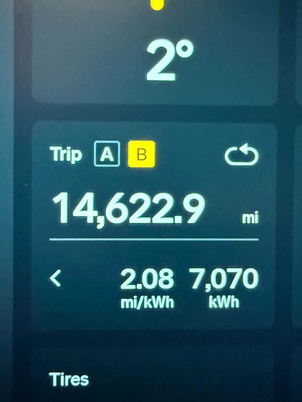

I'm at 2.08 with over 14,000 miles on these tires. Tread depth is around 10/32. That's better than my OEM Pirellis at the same mileage. Those ended up getting 42,000 miles on them before changing to the Nittos.
Rivian R1T R1S Nitto Terra Grappler G3 tires available IMG_2309

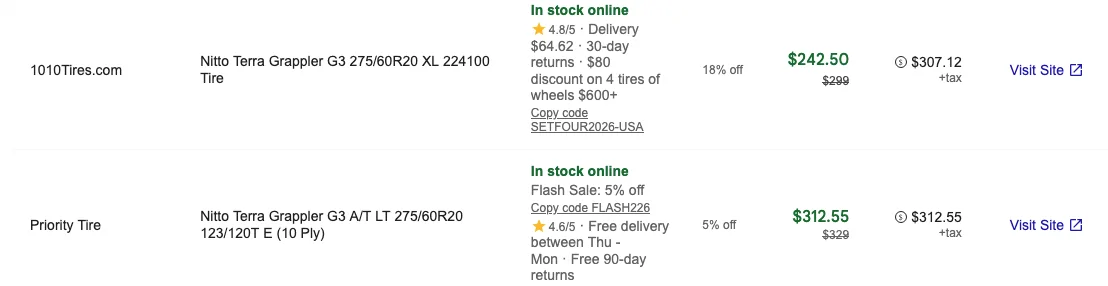

Found a great deal on these online, and Discount Tires is matching the price, so tomorrow I should be riding on 275/60R20 Nitto Terra Grappler G3's for $1096 out the door!
CarRamrod
Aug 23, 2023
Minnesota
I am in the market for these as well. Where did you find the deal?!
Would love to get discount to match. Was that on the LT 126 tires as well?
70
9,088
12,552
Google. Compare prices option. Multiple results. Same way I found Black Rhino wheels for way less than usual retail price.
