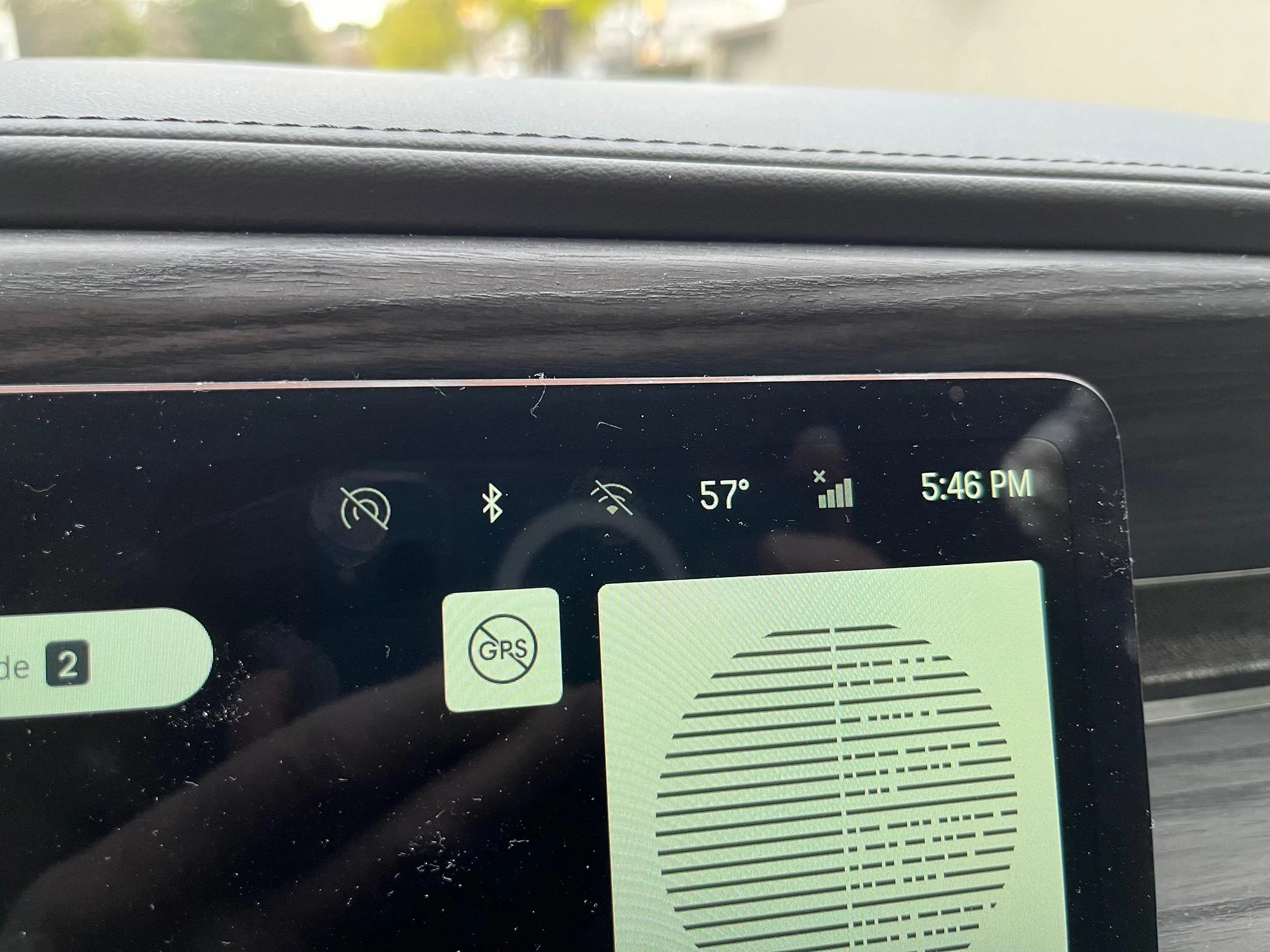

No cell, wifi, hotspot or GPS.
Software reset didn’t work.
Called Rivian and vehicle restart didn’t restart the vehicle. Advised to wait through sleep cycle and try again.
Anyone have similar experience?
This exact same thing just happened to me. I can't restart the vehicle and it won't connect to WIFI or the mobile network. I have an appointment with Rivian service on Wednesday.
How did yours get fixed? Did it start working on it's own or did you need to have a part replaced?
