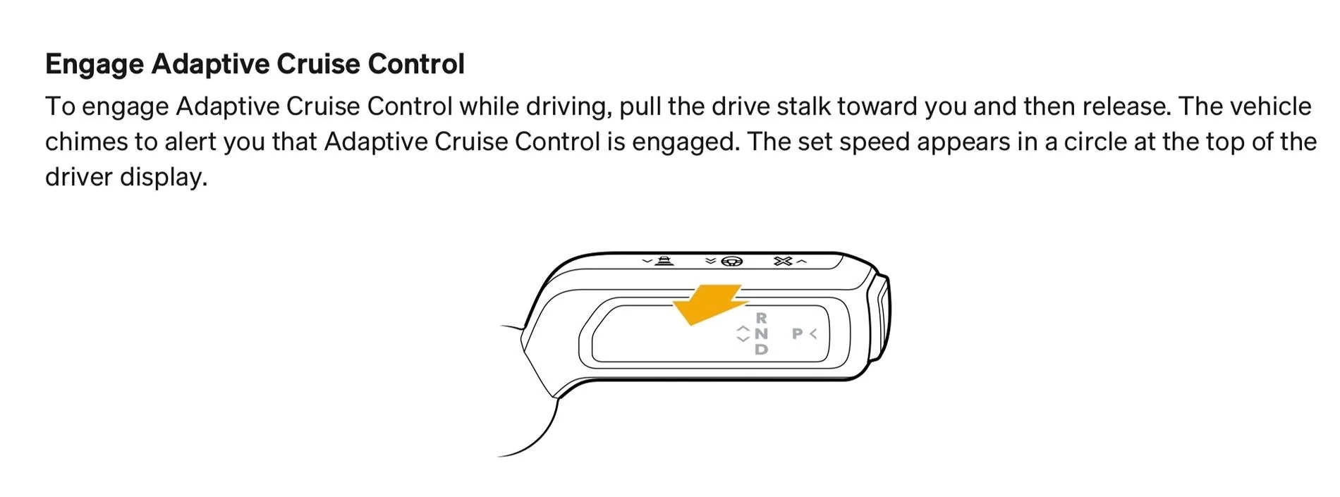

On Gen1 you should be able to tap the lever down twice (not back like Gen2) to engage. Worked for me on the highway. Worked great!
