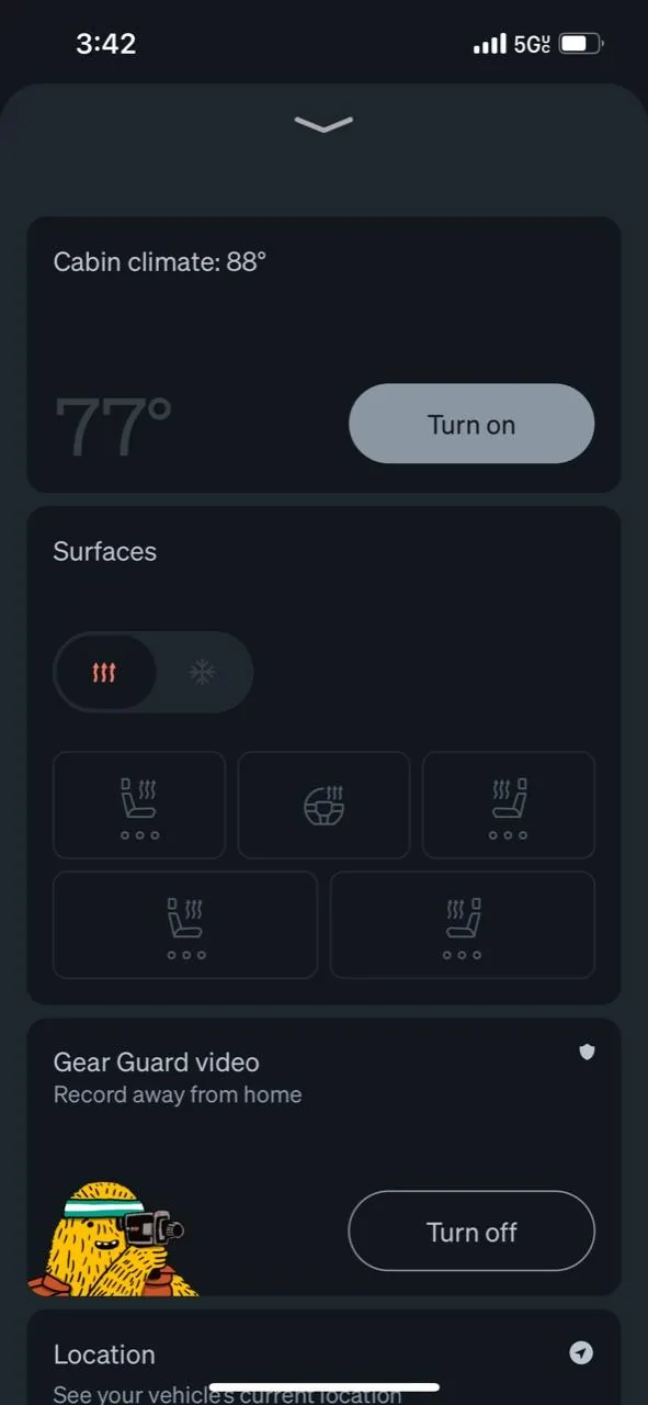

Rivian R1T R1S Normal HVAC behavior? 24D56951-9DCF-4257-B10B-2BCD9446F8EF
45 windy and some snow in Los Angeles and I’m driving around with the windows cracked because it’s hot as fuck in this truck.
