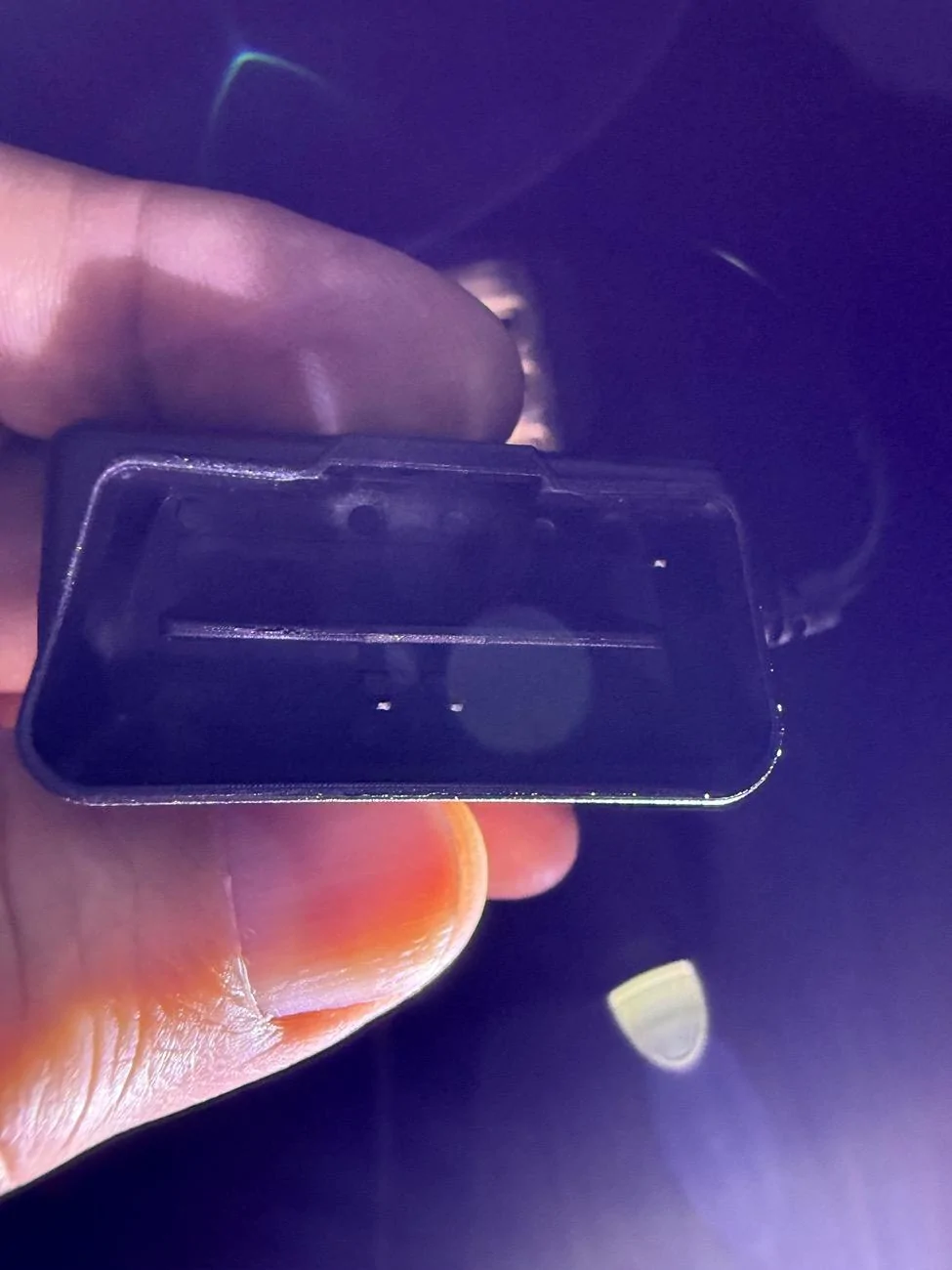

For the Gen2 the EVsporline MagSafe charger comes with an OBD2 adapter. My understanding is the fuse box is not there on the G2. The OBD2 adapter is supposed to shut off after 20 minutes with the switch in the O position (ACC mode) and at 11.6 volts with the switch in the - position (surveillance mode).

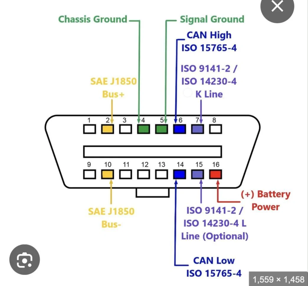

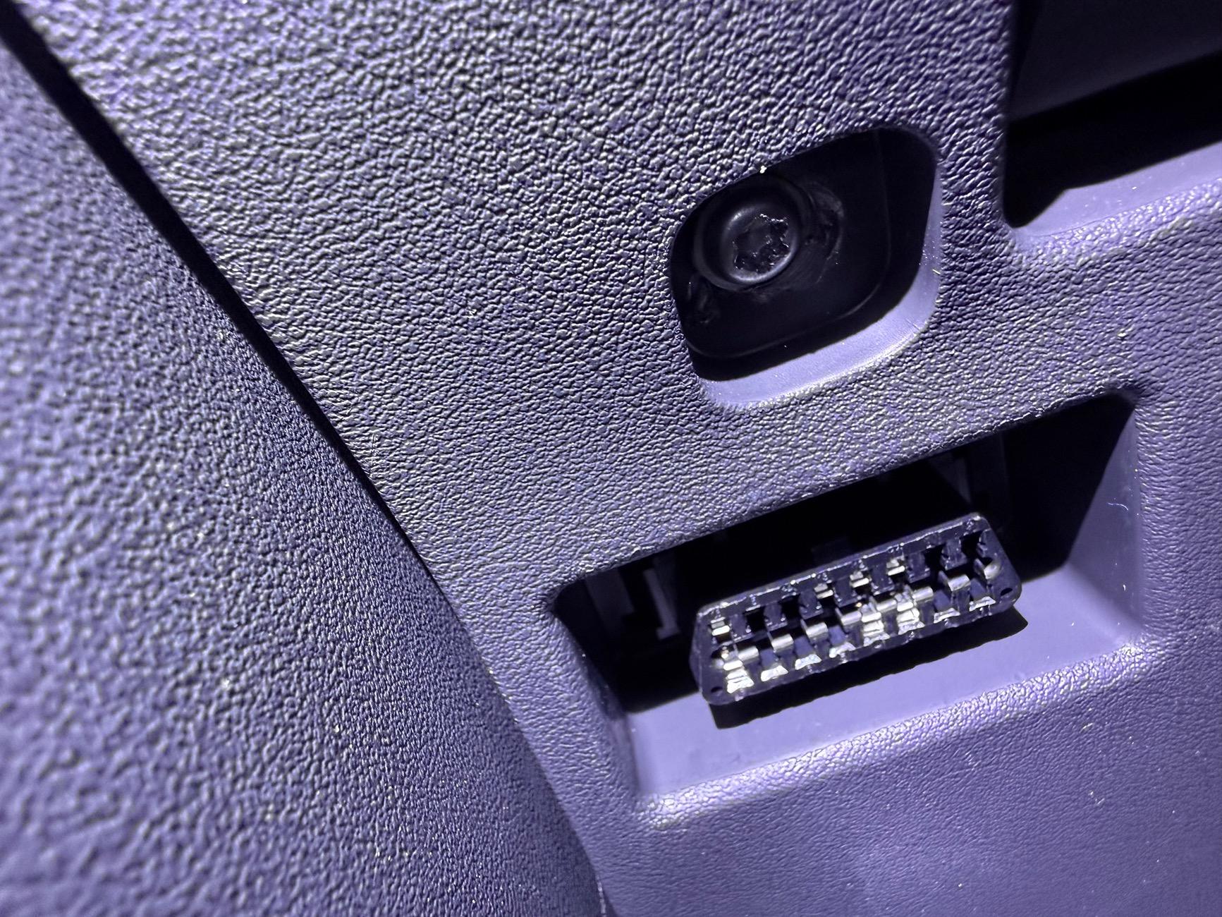

I checked my OBD2 port with a test light and only pin 16 has 12v power. Pin 5 is "signal ground" on an ICE OBD2 port and that pin is not populated on the Rivian.
So my best guess is that there is no way to shutoff the phone charger without an OBD2 adapter specific for the Rivian. I have no idea if any of the other PINs on the Rivian have the signal that a dash cam OBD2 adapter is looking for.
I'm guessing the Schosche adapter would shutoff the charger when the Rivian sleeps as it's looking for just a dip in voltage (12.6v) but that the charger would come on every time the truck wakes to charge the 12v up. Seems like the perfect radar detector power source for an ICE vehicle.
Here are some photos in case anyone has any ideas.
EVsportline adapter:

G2 OBD2 port:
Rivian R1T R1S OBD2 on Gen2 R1T IMG_0391
OBD2 pinout diagram (ICE vehicle)
Rivian R1T R1S OBD2 on Gen2 R1T OBD2 ICE pin diagram

Did some further testing. None of other PINs go to ground when the truck sleeps. All I have is constant 12v on PIN 16 and constant ground on PIN 4. So unless Rivian changes something with a software update I don't see any cheap OBD2 adapter ever shutting off when the truck sleeps.

From various reading I have done over the years, I'm pretty sure that the pin 16 constant (never switched) 12 VDC is required by OBDII spec. The other protocol lines, if implemented, must follow that protocol spec as well and it would be unusual for a protocol to sink to full ground. The one possibility is that pin 1 is used by some manufacturers to indicate if the ignition is on or off, but it is "at descretion" of the manufacturer. You may have already seen it, wikipedia has a detailed description of the pinout functions.
I don't know details, so don't ask me, but from what I've heard EVs aren't required to adhere to the full OBD II spec because a lot of it doesn't apply to EVs and they have other diagnostic tools. Tesla doesn't even have a user accessible port at all. You have to plug in to a harness behind a panel.
Yeah, OBD is really two standards - hardware/protocol and diagnostics codes. The same code for an ICE cat converter sensor failure will be returned regardless of manufacturer. I have read that EVs are not required to support the full OBD. Makes sense because 95% of the OBD Standard codes are irrelevant since they are ICE troubleshooting information.
But it seems most/all EV manufacturers have wisely chosen to not completely re-invent everything, and just use the existing OBD hardware standards. That's wise also because existing OBD tools could implement the EV codes just with a software update, if the manufacturer provides the details.
