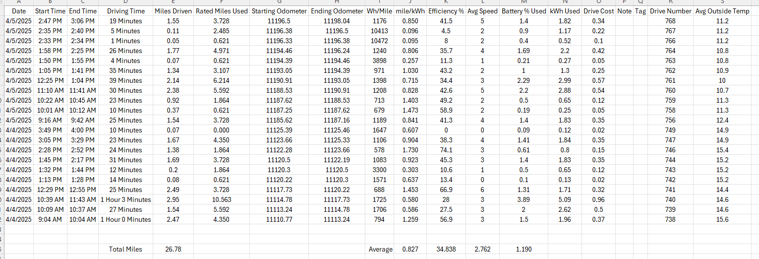

I did an off roading event with NERC over two days in spring of '25. This was in Northeast PA, was pretty technical and with a big group.
Here's the pictures. https://photos.app.goo.gl/1YEWz43h2shdjfoX6 You should compare these to what you'll be doing. I suspect it's more technical than you're describing, so slower speed/more torque, but only you can judge that.
I averaged 0.827 mi/kWh while going 26.78mi off road. Roughly 158mi range with my dual motor (non-performance) on a full 131kWh charge. It took us two long days to do 26mi, so it was largely a non-issue in terms of capacity vs journey.
Here's the data.
I've done this trip 3 times, and logged all of the data. Be happy to pull other sessions if there is interest.
Also, check out this guy on YouTube. He has some great videos on range and being offroad. Likely a better fit for what you're asking for.
