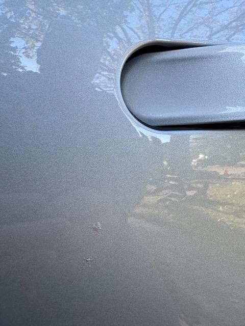

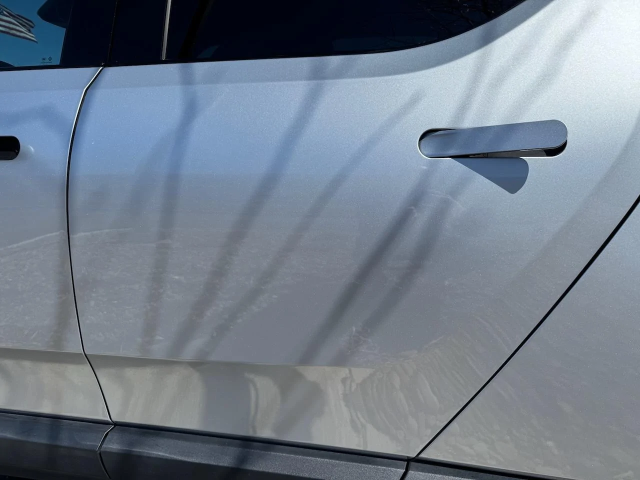

Just had a couple of similar spots show up on mine. Left rear door by the handle. 7 months in, were not there at delivery and didn't notice anything all summer.

Oh, man. That sucks!
The good news and I mean this, do not worry. Yes, it took a while, but Rivian and the Rivian Service Center I found and went to did a stellar, beautiful job. Cannot tell it was repainted. Will update.
Please let us know how it goes.
The Rivian-certified Repair shop had a sign in the lobby that said Relax, we'll take it from here. They mean that!!
Good luck. Stay on top of Rivian.

Follow up; Just got around to dropping off my R1T. The body shop and SC were pretty backed up over Xmas so I waited for a quieter time. The bubbles in my above photo did continue to expand (about 2x) Since the Fall.
SC said they’ll put a factory new door on and paint match it. Will share later how it goes.

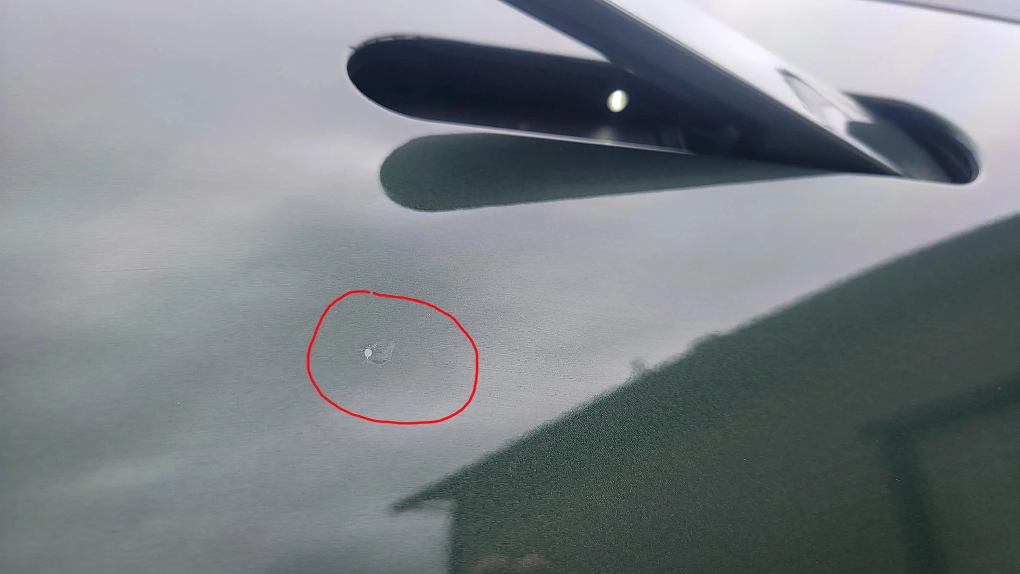

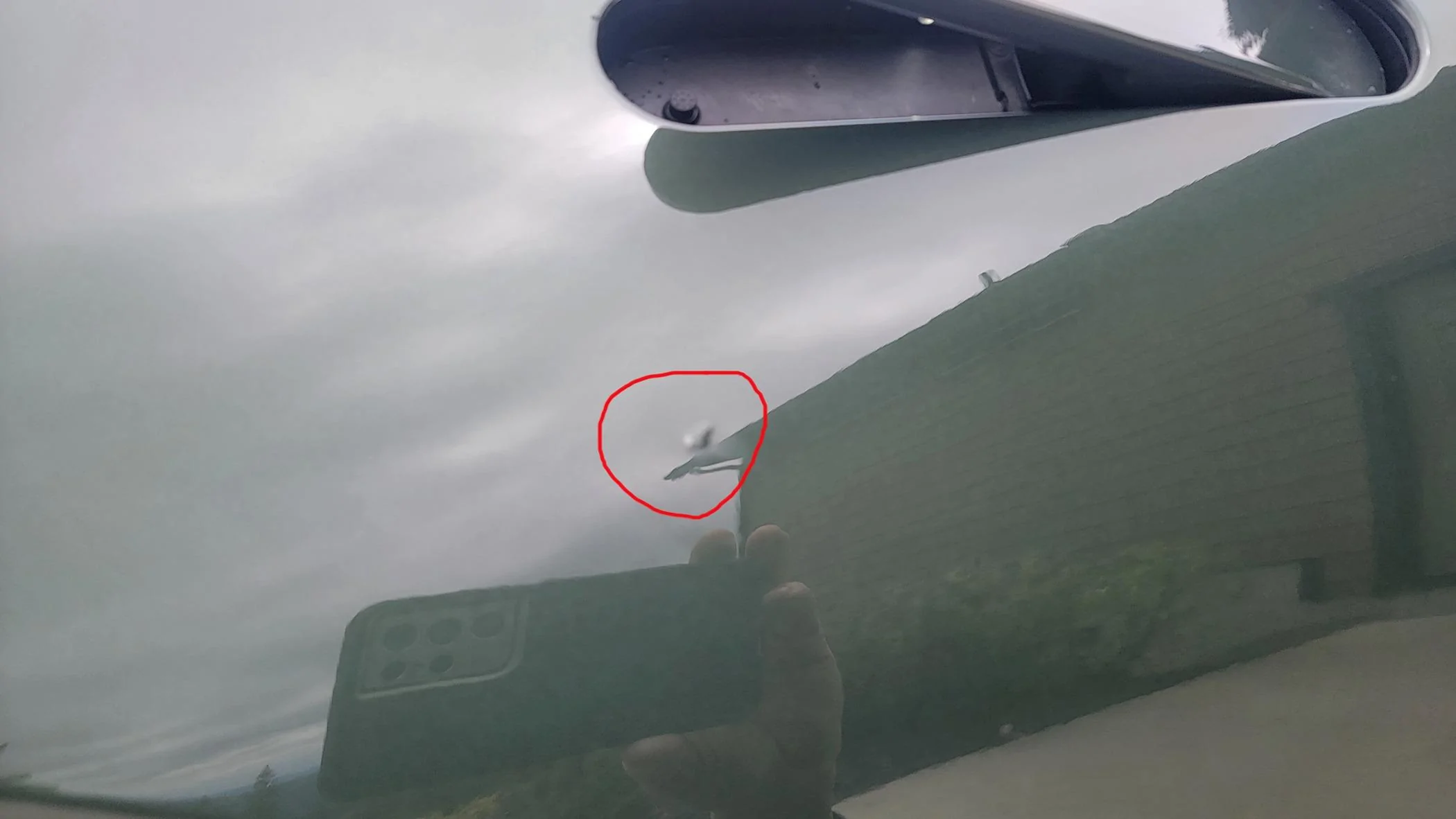

Hello,
Took delivery of my R1S in January 2024. Sat in my garage for three weeks waiting for full XPEL and Opti-Coat Pro+ ceramic coating.
This week, I noticed a small paint bump, ~ 0.25 in. on the rear passenger-side door below the door handle.
I would appreciate if you could let me know what you think this might be, or perhaps some of you have noticed this in your Rivians also.
The background:
The PPF and ceramic coating were done by what I consider a master installer. Should see his shop, nothing but high-end cars waiting for him to do his PPF magic, as close to perfect a PPF install as it gets.
My R1S was fine for a while. About a week ago, I discovered the bump. It had not seen it before, and I check my R1S constantly.
In my mind, this was just a bubble developed in the PPF and was actually thinking of ignoring it or having my PPF installer take a look at it whenever, no rush, no care.
Was in his neighborhood today and decided to stop by and have him look at it for a really quick fix. One of his master assistants came out to take a look at it first. "Buddy, this is no bubble. It is a good thing you brought it in!," his first words upon checking it out. Feel it, he said; it is hard, it almost looks as rust like what you see in older cars, and told his boss that he had to come "see this." Uh-oh, alarm bells went off in my head.
Both of them are scratching their heads. Could not believe that it would be rust, but that something definitely is going on, and IT IS NOT the PPF or because of it (taking that with a grain of salt). At any rate, he suggested that I take it in for them to remove film off the door and determine what is going on before I contact Rivian.
The PPF installer comments:
" We will not need it overnight or anything like that. Our plan is to just remove the film off of that door and see what we can find. After you left I was thinking back about a situation that was similar to that. But it was a custom car and whoever built it put a screw through the door panel on the inside, and the point of the screw was resting against the inside of the door skin. Eventually started working its way through with Rust. It was the screw that was rusty. I am quite curious about what is going on with your Rivian. I have never seen it on a modern vehicle."
Again, I would appreciate your insights, and will update this as needed. Thank you.

Update 8/12:
After 80 days of many calls, repeated e-mails, messaging through Rivian app, and Rivian apparent foot-dragging, Rivian Support finally stepped up to the plate and made things right.
Rivian will pay to repair the so-called "blemish" (corrosion) on my R1S door, provide rental car, Uber credits (very reasonable) and pay for the reinstallation of XPEL 10-mil PPF with ceramic coating as well by my PPF installer. And after insisting repeatedly that I take my R1S to the nearest SC 300 miles away to fix a driver side fitment issue, Rivian Support finally also agreed to have its Rivian-certified collision center also perform that repair while the R1S is getting repainted. Repair shop is 40 miles away.
Thank you very much, Rivian, for doing right by your customers.

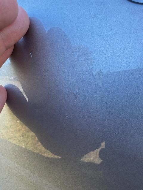

Hey man I just noticed a spot on my 23 R1S it sounds a lot like your e act issue I never saw it and I was my car all the time I just noticed it like 2 weeks ago and it seems to have grown already it’s on the passenger side rear door below the handle my vehicle is the same color as yours the adventure package what to do

Boy, you are the third one with the same problem at same place. Pinhole in door skin; water draining down into door from window; moisture gets in under paint, voila! corrosion.
No worrries, it turns out. Rivian will replace the entire door for you under warranty and give you transportation. If mine is any indication, once finished your Rivian will look as if it just came out of Normal factory. Beautiful.
For me, Rivian also replaced the paint protection film. The door, the front door and rear quarter panel will be repainted to blend in the replaced door.

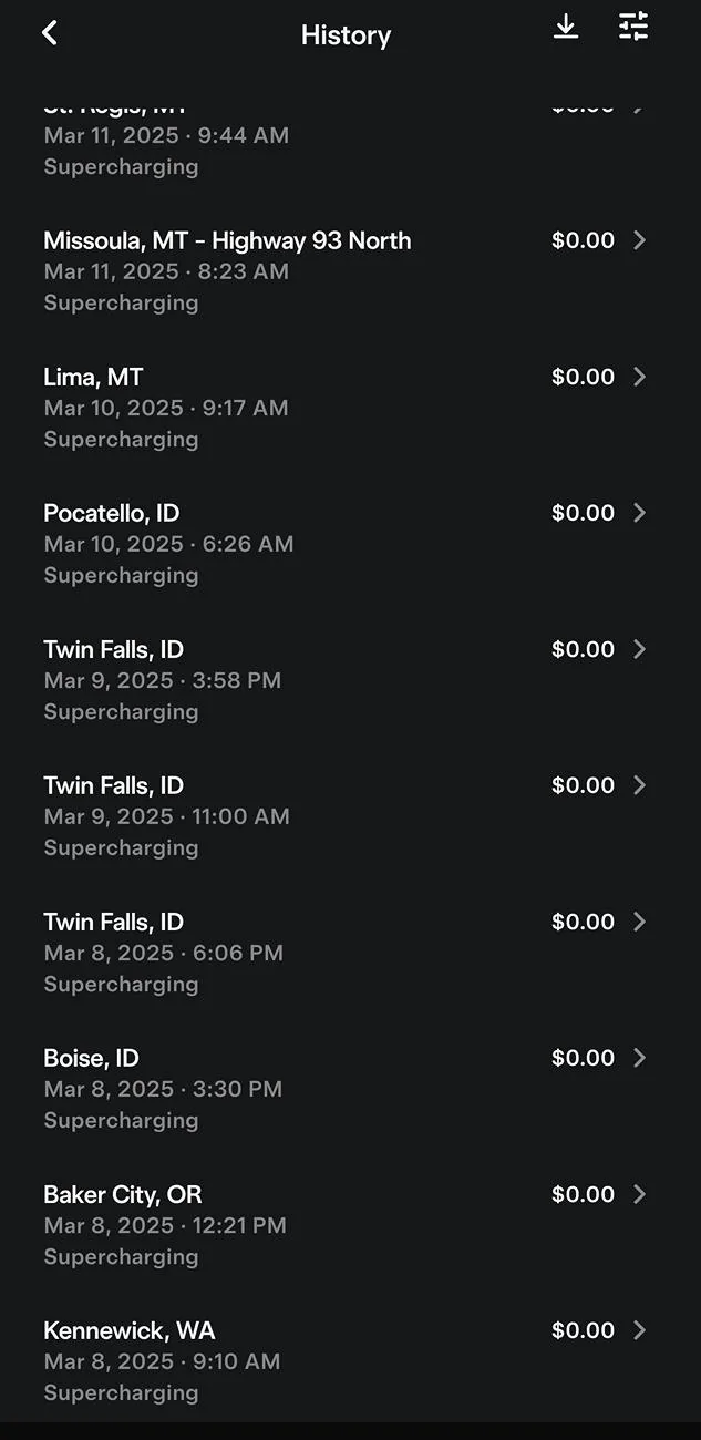

As much as I like my R1S, my glorious Tesla Model S is my go-to vehicle for long trips for many reasons including tech, handling, response, FSD as imperfect as it is, etc. But more importantly, because Tesla gave my Model S free/zero/gratis electricity at Tesla superchargers. For life.
It is so refreshing to pull up to a Tesla supercharger and see the meter frozen at $0.00. Indeed, I just completed a 1,400 mile trip with my Model S. Total energy cost: $0.00.
