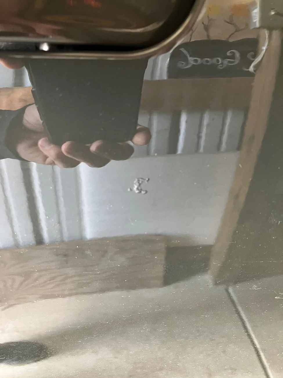

Add me to the list. Thanks to this site I have been able to identify this and the HVAC drain plug issues. Is it only occurring on Launch Green R1’s?
Mine is a 24 LA Silver so I dont think its limited to a specific color. Currently at the service center going on a week now for the repair.

What the experts at the Rivian-certified shop that fixed my R1S said is that there must have been a pinhole in the door skin. Water on window glass draining down into door started working its way through that hole and voila, paint started to bubble up.
Even though already repainted at barely 4 months old, the repair looks great; largely impossible to tell from the original door.

I took mine to the service center in Shepherdsville KY. They took it to a collision center that fixed the corrosion. Unfortunately the service center’s communication was lacking and I’m not sure how they repaired it. I know they didn’t replace the door. It looks like new but I am concerned that it may reoccur. They had it for nine days.

No the communication was horrible but I’m not sure there were any parts involved. They did NOT replace the door. That’s what has me concerned about it reoccurring. The invoice is two pages long.

Just got updated on mine that they are replacing the door and all this time they were waiting on the new door that was just delivered Friday.
