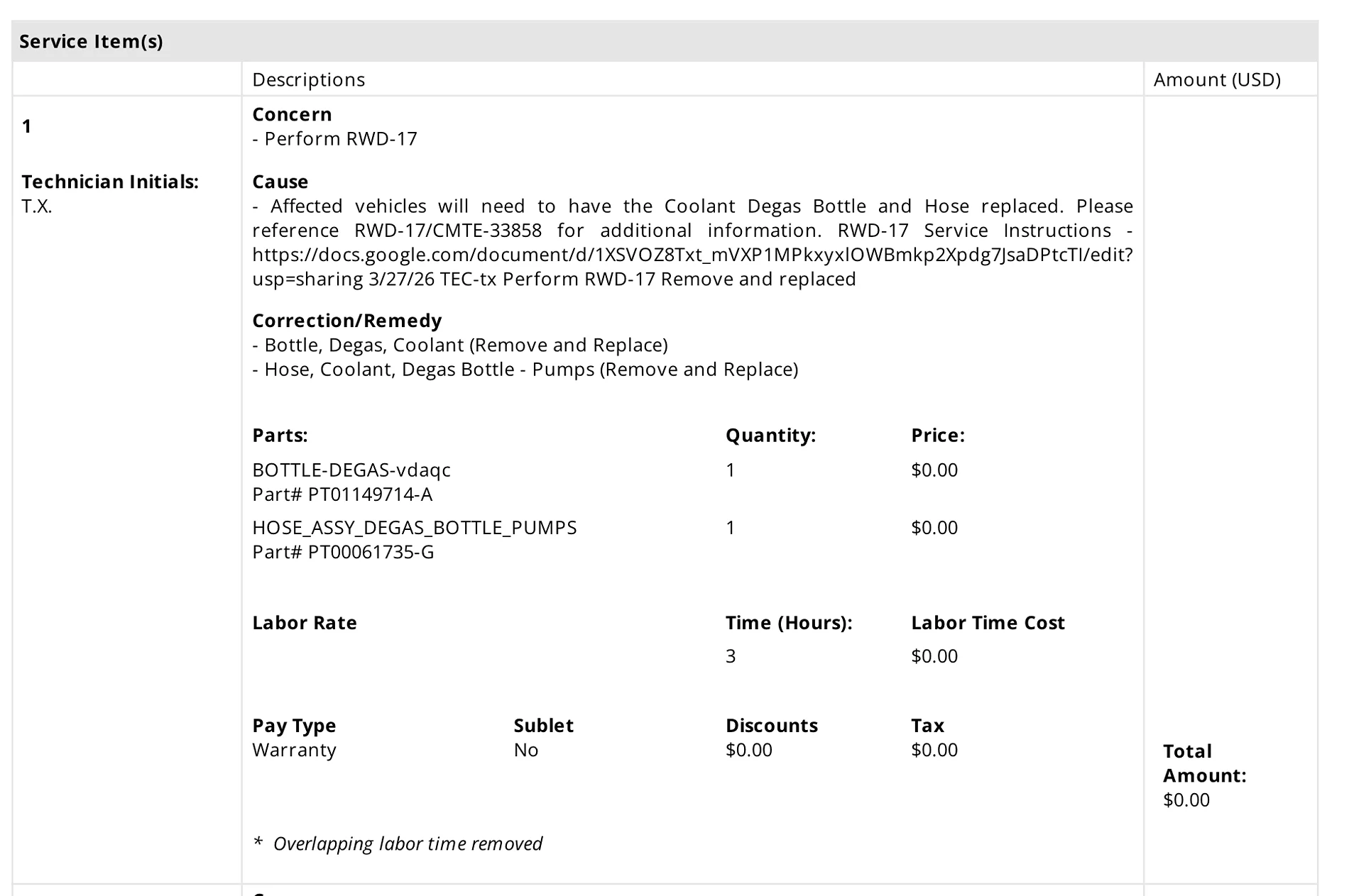

Got a call today too. Scheduled a few weeks out, they said it's some sort of coolant swap...

Interesting, wonder why ours need a coolant swap for? I haven’t had any overheating issues.

Just had my done on Friday - took a few hours - here is the invoice for what was done
