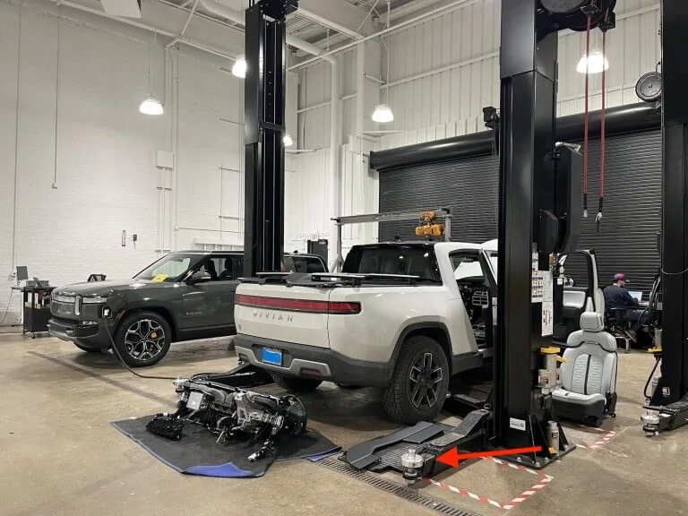

One thing I recall--the service centers use a different lift system than the standard "soda can jack pucks" most of us have. They're on horizontal arms with integrated, wide jack point adapters. So it's definitely possible that some sliders/boards may get in the way, and if so, that really can't be on them.
Rivian R1T R1S Running Boards Service Question. 00E3YFpTlSoxiHFy8ov1ohT-23.fit_lim.size_768x
FWIW, my truck has had EVSportline running boards, AND the aluminum aero covers, and has been lifted up at the local Rivian service center 3-4 times. I've never once gotten a comment about the boards.

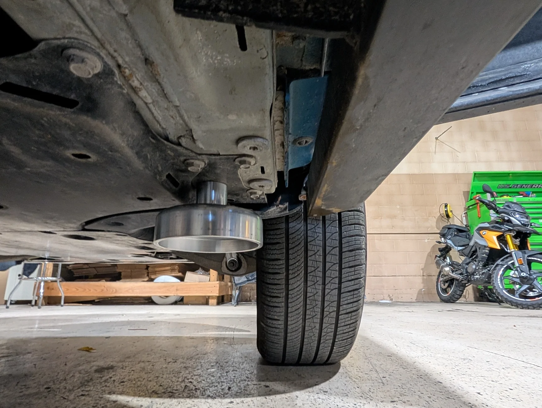

I have a set of RealWheelsEV running boards that I love and highly recommend. Last month the Seattle Rivian Service Center rejected my R1T, saying they couldn't lift the vehicle with the running boards attached to service the right rear bumper sensor. I contacted RealWheelsEV and they stated that you can absolutely lift the vehicle with standard pucks. They have only heard about this issue (Service Center rejecting a vehicle with their running boards) maybe three times in total. Sounds like the issue is not with my running boards but with the Service Center in South Seattle. Short of removing the running boards or driving to another service center, was wondering if anyone else has had to deal with this situation in the Seattle area?
I have same running boards with r1s. I have been to seattle and bellevue service centers, they never raised that as an issue for service.

Yep, I asked if I bring extended pucks, would they use them? NO! I guess I'll just remove the running boards the next time I bring it in for service. Thanks for the info.
The OE pucks slip over the lifting mounts on the arms. They are very secure compared to pucks that just sit on top of a pad. Basically impossible for a lifted vehicle to slip off.
