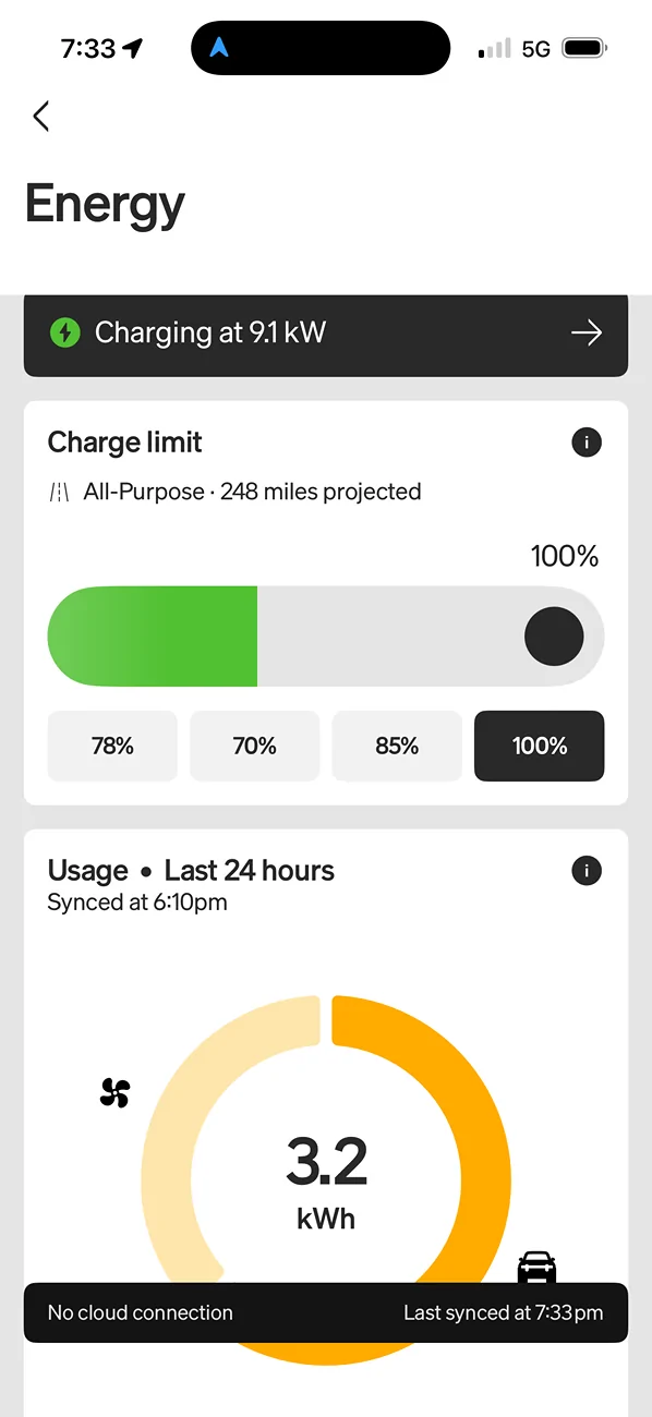

I apologize in advance if my message shows twice I just posted and all I see is the picture or not any of my text
take 2, I purchased a Used 2024 Rivian with 17,000 miles from Rivian four days ago. They told me the estimated range would be 290 miles. I asked why it wasn’t 310-330 like the other 2024’s on their site, all of which had more miles and they said because I have the 20 inch all-terrain wheels. A 50 mile drop seems a little excessive, but whatever, it’s not my question. I’m charging right now for the first time and it’s telling me if I went to 100% I would only have a 248 mile range in all purpose mode. Is this normal? when people say they’re getting 290–300 are they only using two motors or should this be achievable with quad? I can return my truck up until Monday but I really don’t want to because I’ve traded in very expensive vehicle which I won’t be able to get back but if there’s something wrong with this battery, I’d like to address it now.

248 is the 85% number for a Gen 1 quad with 20” wheels and OEM tires in all purpose mode.
I suspect your app is just out of sync with your car - you maybe selected 85% first before you selected 100%, and the miles is still stuck on the 85% value. Check in the truck, and restart the app.
100% range is normally 284 in this configuration.

You should sign up on Rivian Roamer and see what it says about your battery health. Your R1S is probably fine. You want to see close to 130 kWh usable capacity on the battery. If so, it is fine. As others have said, this configuration is EPA rated in the 270-280 miles range, but that 248 number is supposedly a projection and could be wrong for several reasons.
As long as your battery is fine, which it probably is, you can swap the tires and use conserve mode and you will have very good range.

Thanks all, I appreciate the advice. I’ll see what it says in the morning. I have it set to 75% right now. If I returned it, I’d lose 4-5k in sales tax from my trade-in, that vehicle is already at an auction house. I can still track it, start it, etc from my phone. :)

That doesn't match any numbers Rivian has ever published for a gen 1 quad. I would ask them for a report on battery health.

You may want to go in and reset the range estimates as they are based on recent driving history data. It is likely since it was at a dealer for a period of time that they did launches of harder acceleration more frequently than normal which will certainly affect those readouts… you should be seeing somewhere in the 270-280 range assuming unusual battery wear isn’t the culprit.
