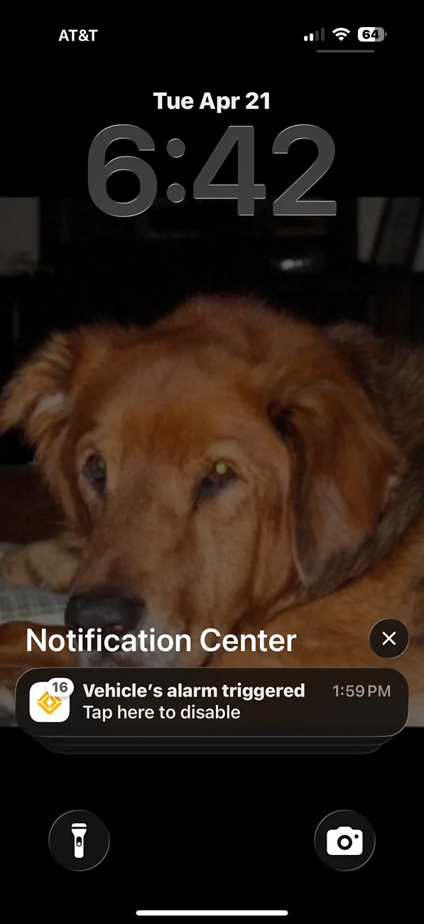

I’ve been getting dozens of push notifications that the alarm is triggered on the app, mostly while parked at work. As far as I can tell, the alarm itself isn’t going off (I’m frequently close enough to hear it, and my assistant’s desk is literally 10 feet from my front bumper when parked). It has occasionally happened at home, but my motion triggered garage cameras don’t pick up noise or flashing lights (they will trigger for lock/unlock chirps reliably)
it has happened occasionally for a couple of years, but lately has been much more frequent.
I have a service appointment for this in a couple of weeks, but wondering if anyone has any insight. I’m hoping they reach out before the appointment and maybe look at the logs to see what the specific trigger is.

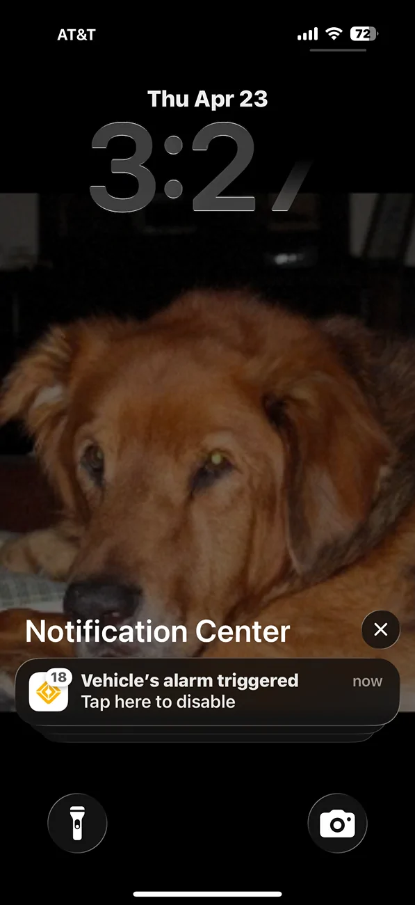

Another flurry-18 alerts since I returned to the office from lunch
another now while typing this

My service appointment was delayed (the “diagnostic guy” was out sick, but I think I’ve figure it out, at least partially.
It reproducibly happens when my phone Bluetooth is on, the car is locked, and I’m walking around near the edge of Bluetooth range (roughly 45-55 feet through a few walls). It stops happening if I move to the back of the building, or if I turn off the Bluetooth.
As soon as I turn on the Bluetooth is starts back up.
Same behavior at other sites, as long as I’m walking around near the maximum Bluetooth range.
