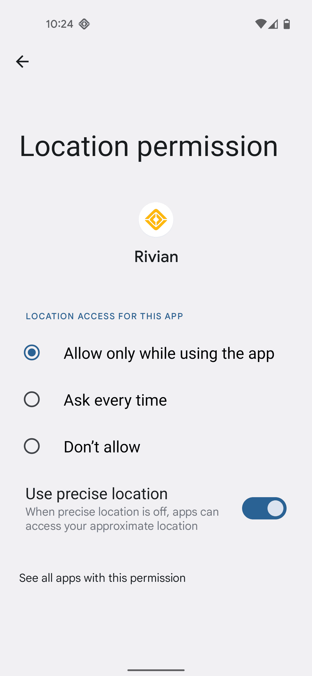

Make sure Location services is set to "Always" in your phone/app settings.
On Android (Pixel 4a), I am only able to set to "While using the app"
Interesting. Yeah I'm almost certain that was the case on iOS until a couple weeks ago during the snafu with vehicles dropping from accounts and people losing PAAK functionality. A few hours later I got a screen within the app itself asking me to change to "Always" to optimize PAAK function. I swear that the highest level when setting it up in early June was only "While using" as you describe. The screen said that it would mean that the app didn't need to be open/running to function, but now with the 1.4.1 update, it now gives me a banner notification if I close the app telling me that it will prevent PAAK from working if I do so.
So, I don't know what to believe. I'm pretty sure that it was working as a key even if I had force closed the app before. I'm also not sure what constitutes "using" the app. Does it mean actively open on your screen, or just running in background and not "closed out"?
My guess is that the 1.4.1 update for Android, when it is released, will unlock that higher level permission.

I hope they do fix this. Mine Galaxy S20 has only same level permissions...highest is "when using app"...
