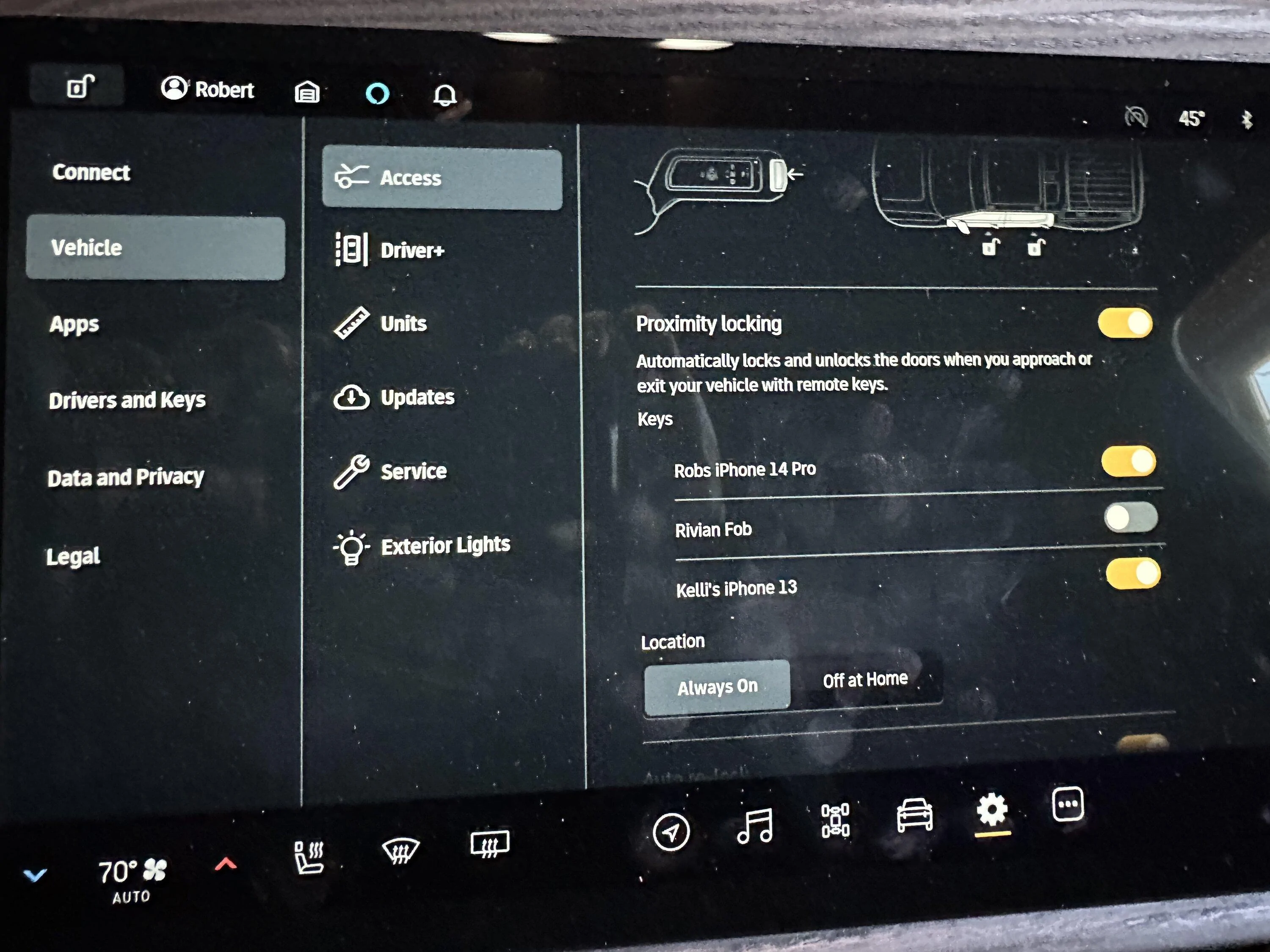

the_mace
Apr 8, 2022
414
343
Boston, MA
Tesla Model S75D, Ford F350 Diesel, Mercedes GLC30
CTO
You can disable auto-lock/unlock when the truck's at home?
Yes its an option in the truck, see this screen:
Rivian R1T R1S Phone as key issues IMG_1074
Havent decided if I like it yet as both the Rivian and the Tesla keep waking up when I walk into the garage. And the Rivian is very chirpy. The Tesla is at least quiet about it.
Ah right, thanks. I was more interested in disabling home proximity locking only for my phone. I often walk near my truck, phone in pocket, and get annoyed by my truck "waking up" every time. Don't mind always keeping it for the fob. I'm probably just being an unreasonable end-user here, though. ?
Yes, that's a feature i'd like too. The truck will mostly be me wife's to use so I dont need it waking up for me all the time. I guess I could disconnect the phone and use a card or the fob but that's less fun. Perhaps Rivian will give us the option in the future.
