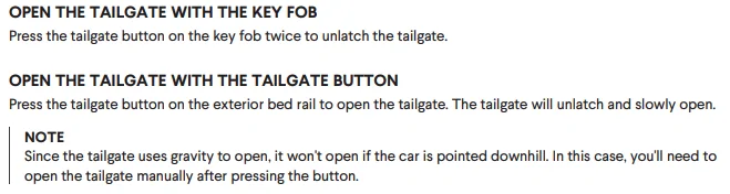

My tailgate .... that is another story - it will not open
Sorry for digging this back up, but I'm curious what you mean by this. Do you mean to say that when you push the button to open it, it doesn't automatically lower? Or that when you push the button you can't manually lower it?
If it's the first thing, that's because the tailgate is powered by gravity. It's not a powered lowering mechanism:
Rivian R1T R1S Poll: Does your tonneau cover work? Screen Shot 2022-08-06 at 1.36.51 PM
(page 148 of the owners manual).
If it's the second thing that's way more concerning and I would be getting Rivian to look into that!
NOTE: Since the tailgate uses gravity to open, it won't open if the car is pointed downhill. In this case, you'll need to open the tailgate manually after pressing the button.'t open if the car is pointed downhill. In this case, you'll need to open the tailgate manually after pressing the button.
apparently one of the latches (driver side) wasn't working - tailgate would not open even if pulled - new part ordered and mobile repair will come out and replace it when it is received by the service center

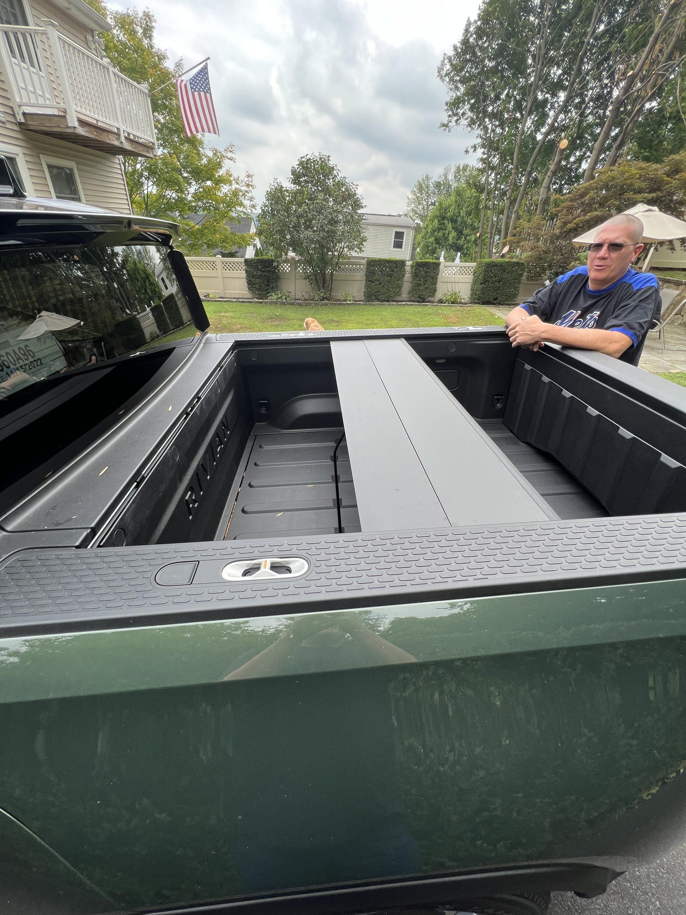

So this happened today:
Rivian R1T R1S Poll: Does your tonneau cover work? 92FC74A1-36DF-4328-8E31-4823ECA83C7A
I pushed it back into the slot and now it will extend those two panels and stop. Thankfully it will actually retract them as well. Maybe if I’m feeling brave I will run a calibration.
This is maybe the 5th time I have attempted to cycle it, I’ve been mostly leaving it open but was showing the truck to a friend. Literally was saying “and this is the worst part of the truck” as I was pushing the button, that’s probably where I went wrong.
