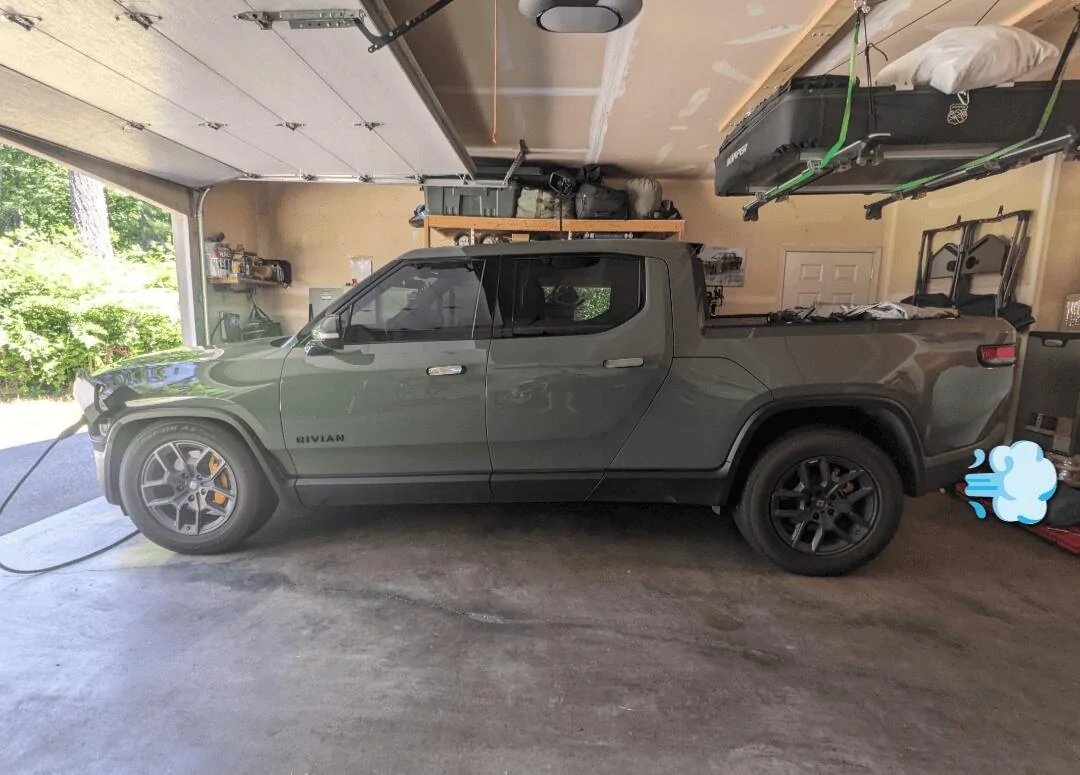

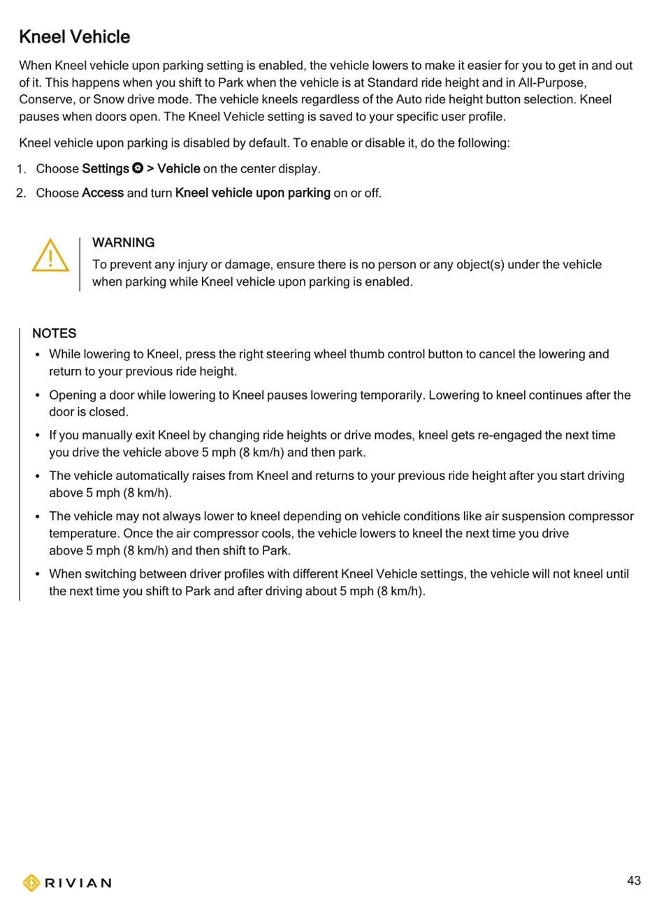

Please, don't put in a ticket for this. It is more common than these folks make it sound. My truck has been doing it for the last 57k miles and it's very normal. No, I don't have kneel on, and it doesn't get as low as kneel height anyway. No, there isn't a way to make it stop or prevent it. Yes, it happens at stop lights and when I get out at various points of the day.
Why does it happen? Speculate away, but here are my theories:
-Adjusting after high-speed aero shifts
-Gyro detects unlevel plane, pre-programmed to correct for whatever reasons
-It ate a big burrito when you weren't looking and had to let out a mean one (see below from over the summer)
-Letting out built-up air in the bags to prevent blowout when it's hot outside

Kneel mode is not on. The suspension adjustment occured about 20 seconds after I parked, exited the vehicle and opened the frunk. My vehicle always makes random height adjustments. I could be stopped at a light or parked on the side of the street. You can hear the suspension adjusting and feel the height on certain corners lift or drop. It literally occurs on almost every drive. But this time it occurred after I parked exited and turned off (auto off by exiting) the vehicle. Never noticed it adjusting after leaving the vehicle before but that's maybe because it wasn't attacking my knee.
It sounds as if there is some kind of a setting on Auto somewhere. My R1S very seldom makes any hissing noises or height adjustments; everything suspension set to off and permanently crazy-glued on All Purpose, standard height.
