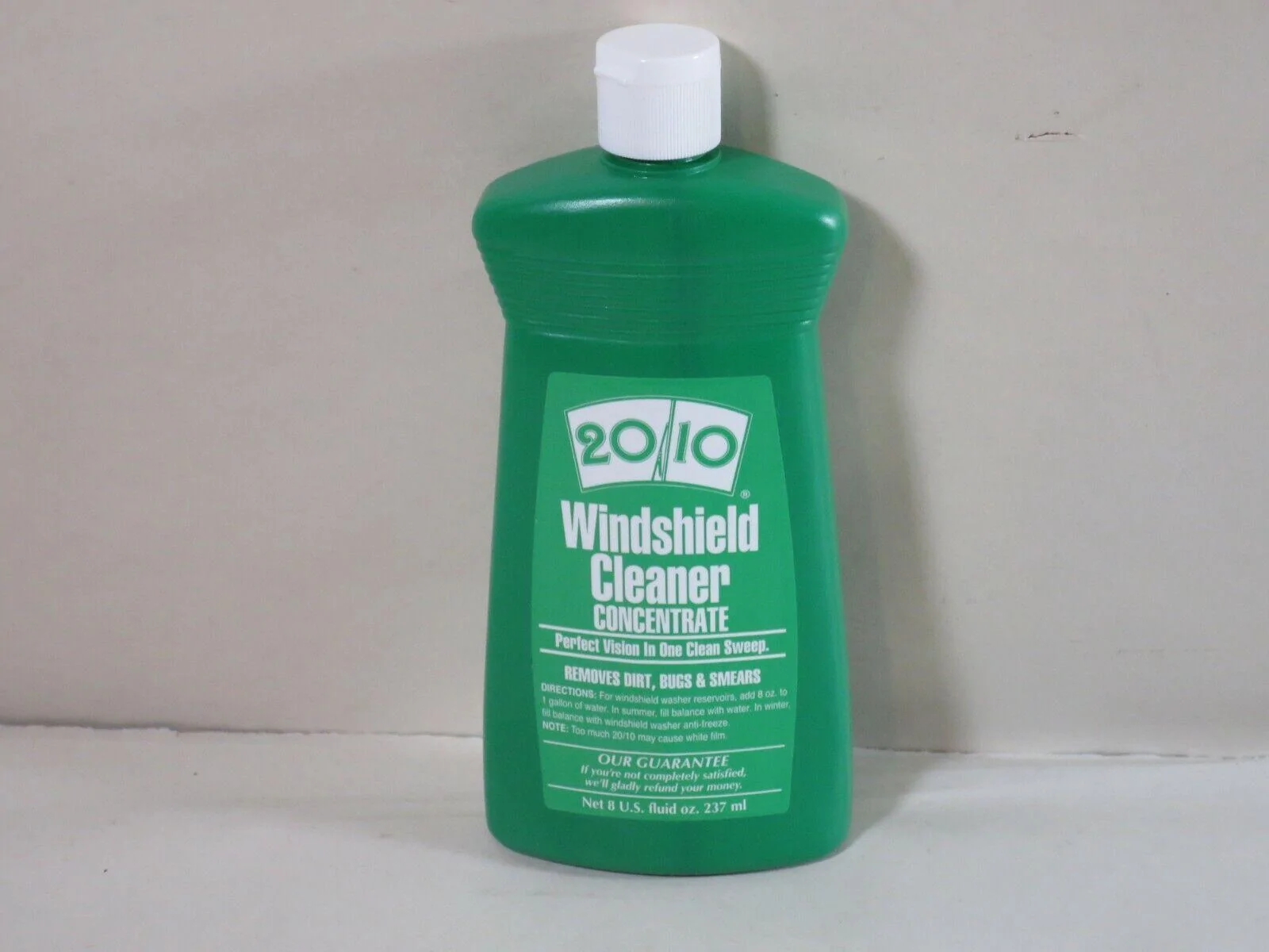

So what were you using for washer fluid that caused this problem? Were you using a product you purchased or some homemade science experiment?
The fluid, itself, didn't cause the problem. Just the fact that it wasn't a de-icer. I live in AZ, so the warm water eventually harbored some sort of something.
But, to answer your question, I've been a life long 20/10 fan. I used to use their de-icer, too, but it's really hard to find. I settled on the 20/10 super concentrate that requires a 1/2 teaspoon per gallon or something. Great stuff.

I think you did not follow the instructions it says to use 8oz per gallon on the label so I am guessing it was too diluted to stop the funk from growing. 1/2 teaspoon is 0.086931 oz. 8oz is 1 cup.
BTW I use have been using this concentrate for years on my other vehicles and in the Rivian as well with no issues when used according to label instructions.

Wrong concentrate. It's this stuff
Ok so now we know what concentrate to avoid.
