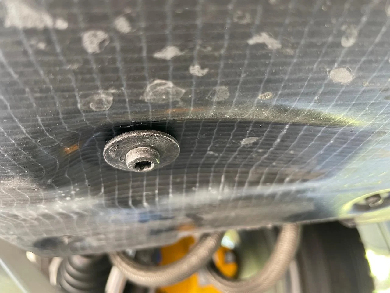

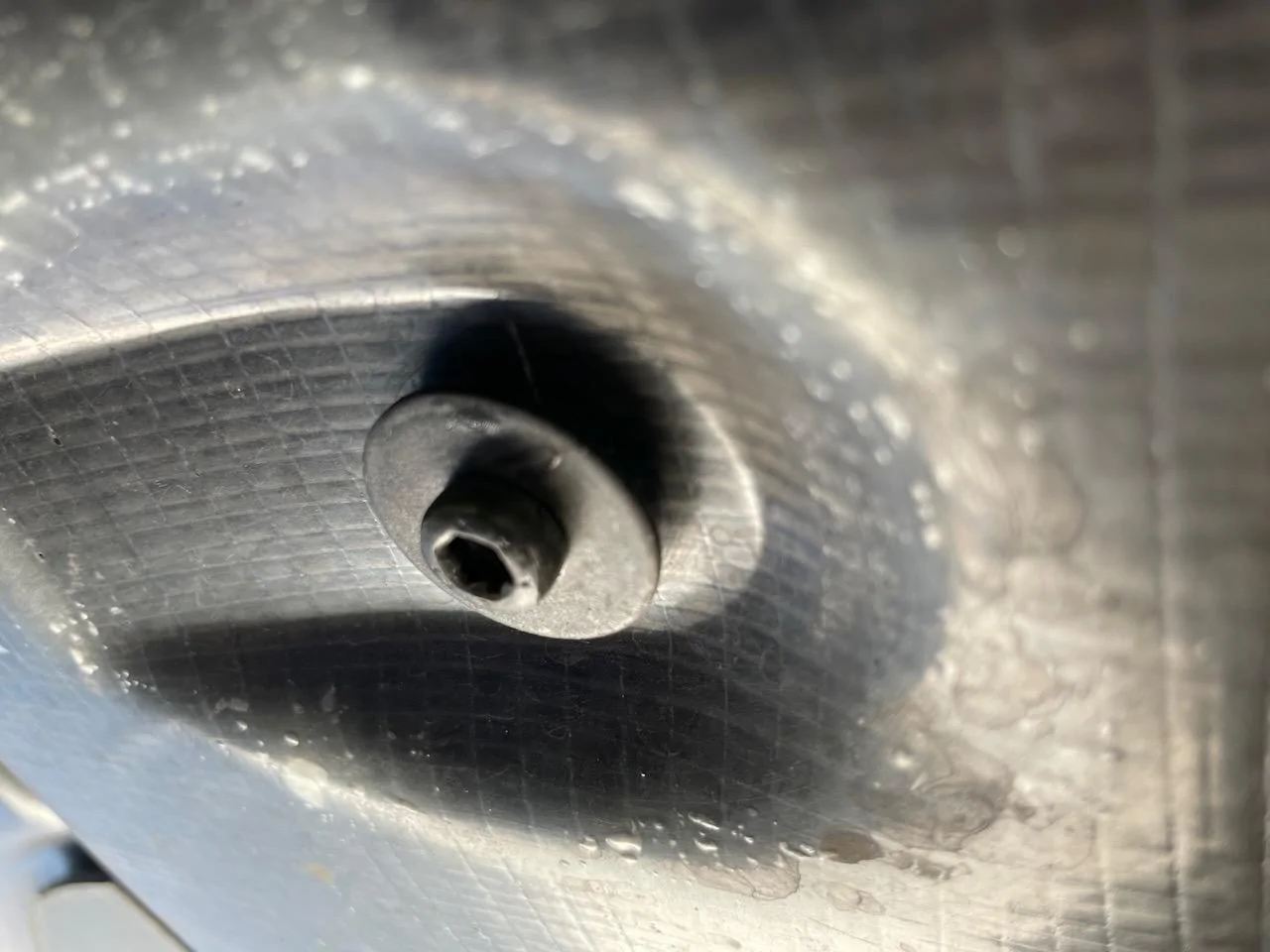

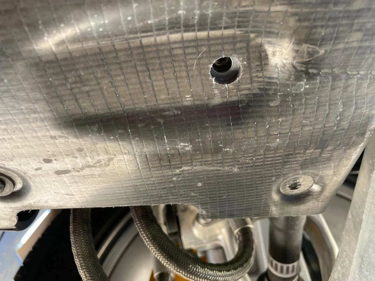

I had to change a flat tire today (picked up an allen wrench on the road somewhere that punctured through the tread) and while I had the truck at its highest setting I looked underneath to check all the bolts. I found one missing, two about to fall out, and several that were loose.
I'm going to report to service since I have other things for them to fix. My VIN is in the 7,000s.
