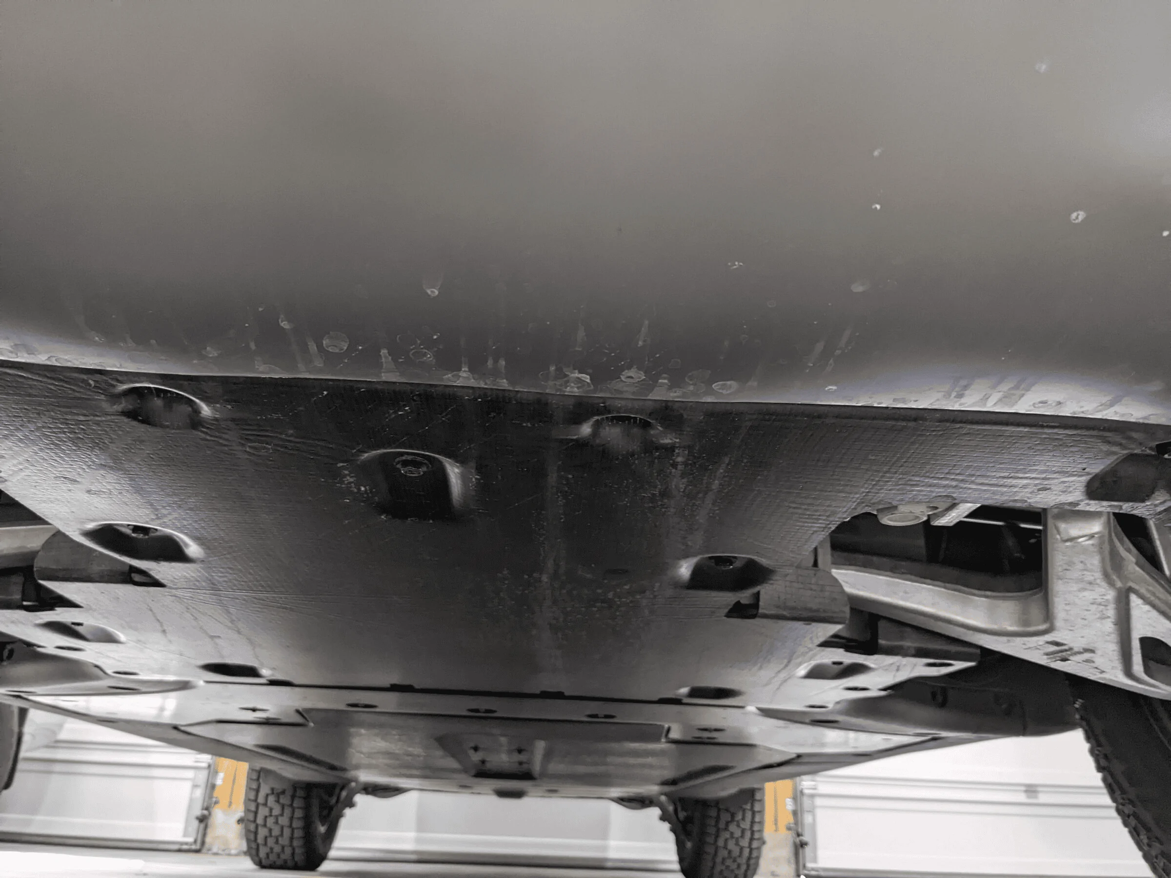

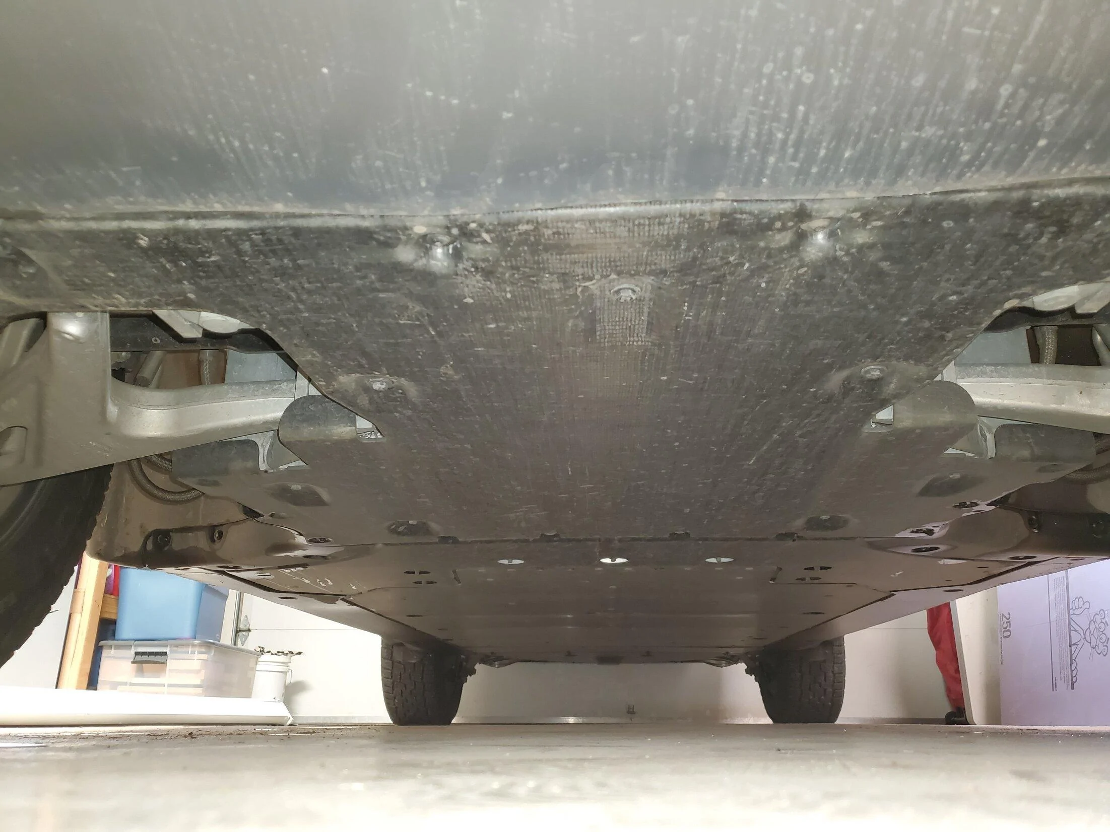

We shall soon know, when a member posts a photo.
Without the underbody shield courtesy of @Delusions of Adequacy:
Rivian R1T R1S PSA on Loose Underbody Shield Bolts 1667602001722
And here is mine with the underbody shield:
Rivian R1T R1S PSA on Loose Underbody Shield Bolts 20221104_155211
Some slight differences for sure (that may be due to production dates), but both are flat and covered and without gaps.

Yep, and there is that center groove I first mentioned... Similar to RUS, but not the same.
