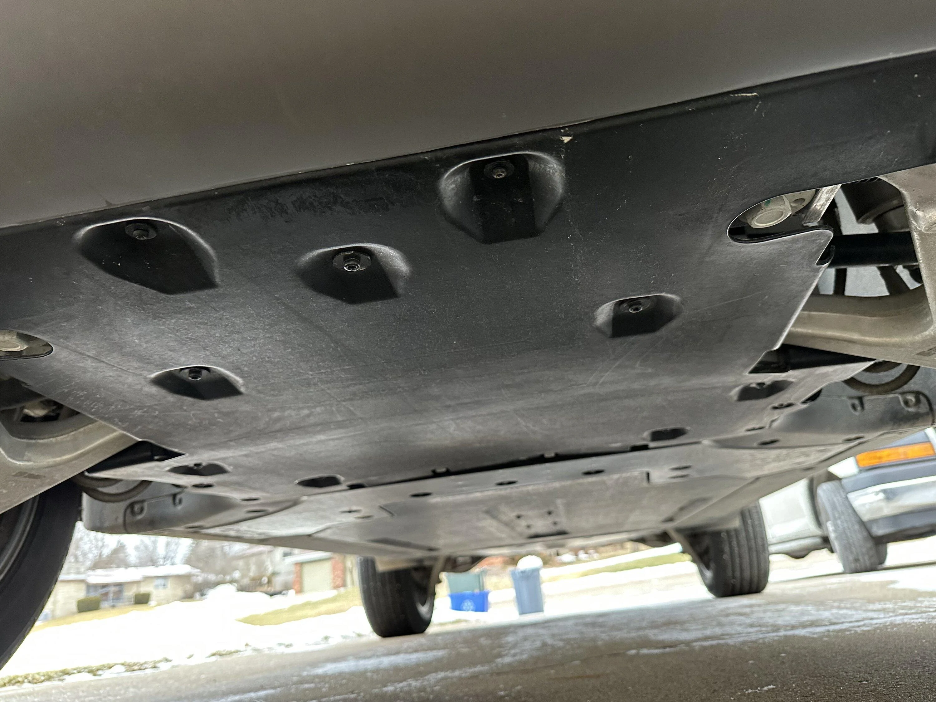

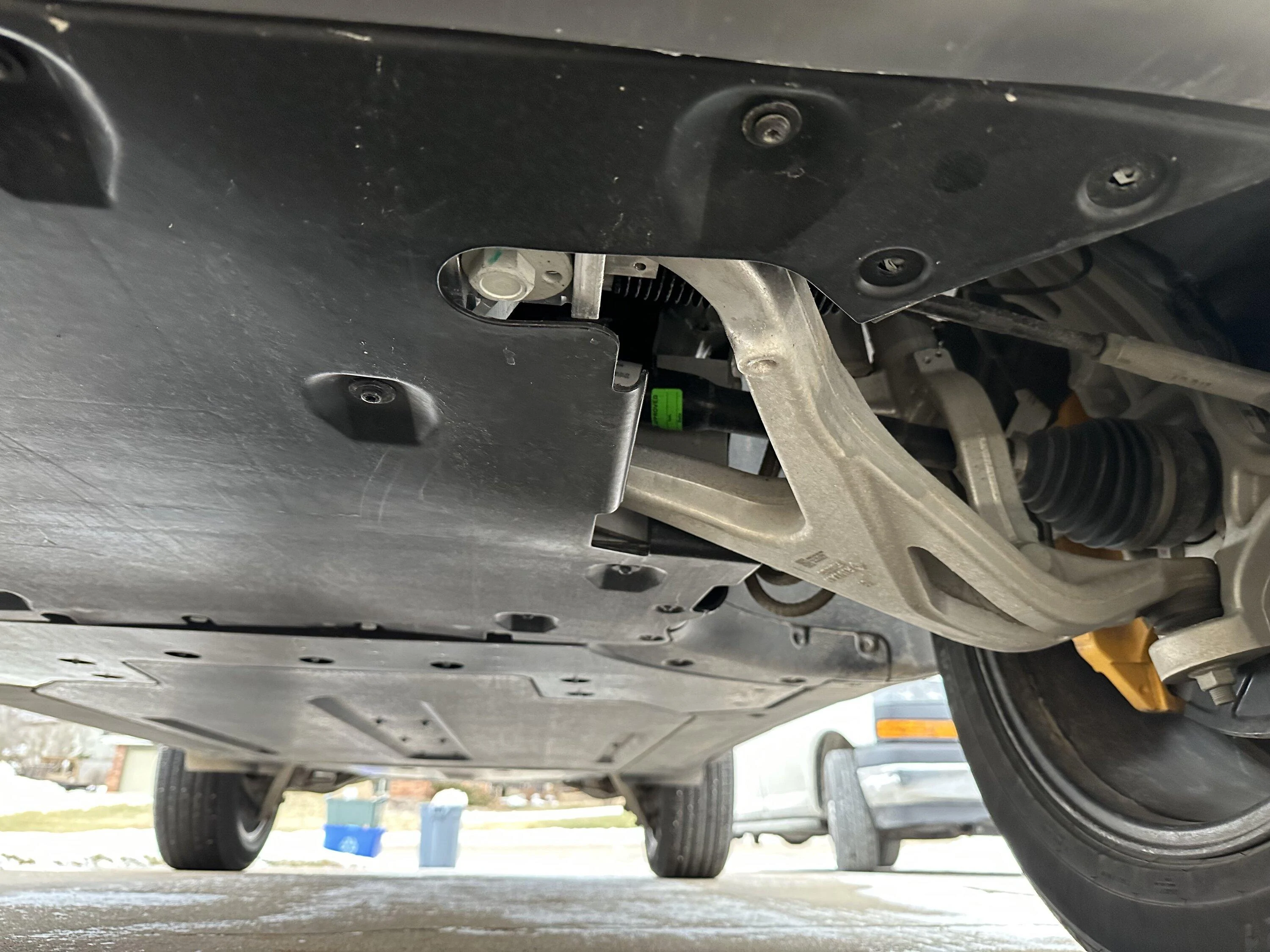

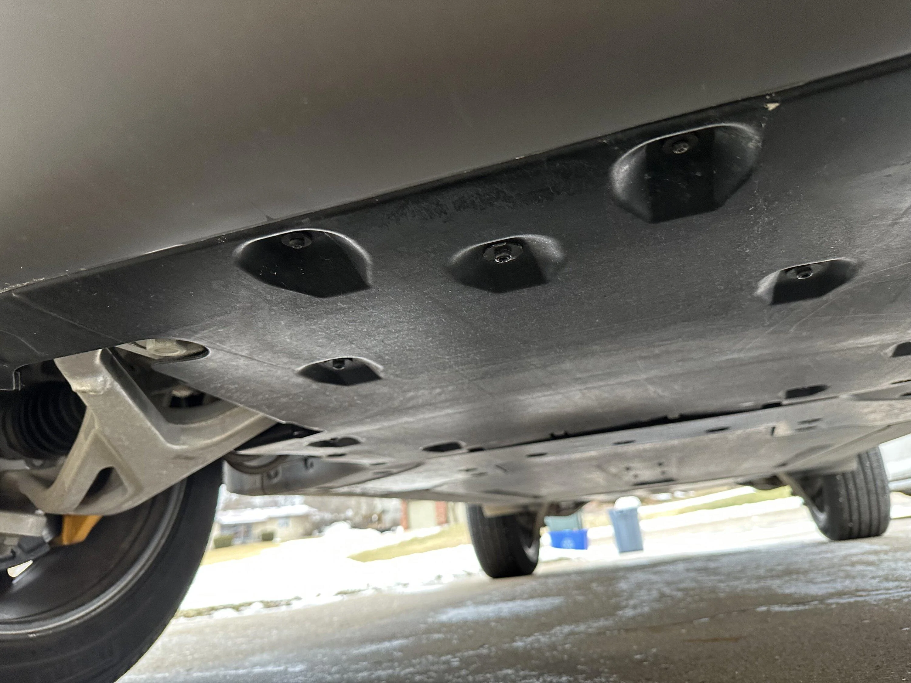

Both, it seems. The problem may be worse for the standard panels since there seem to be more of them, so a couple missing bolts is all it takes to lose a panel on the highway or while crossing water (see forum posts about this). The RUS appears to be a larger contiguous piece that might withstand having more bolts loose or missing.
Cool thanks! guess I need to climb under mine and see what I can see
Thankfully no jack is required unless you're a huge person. Set the mode to Off Road and the suspension to Highest. I love this truck!

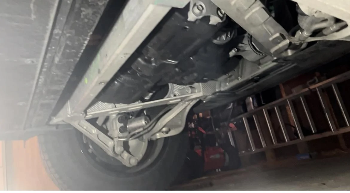

I think I may have lost a piece…. Vin is 1360x
I put a video on a Facebook group since they’re too large to post here

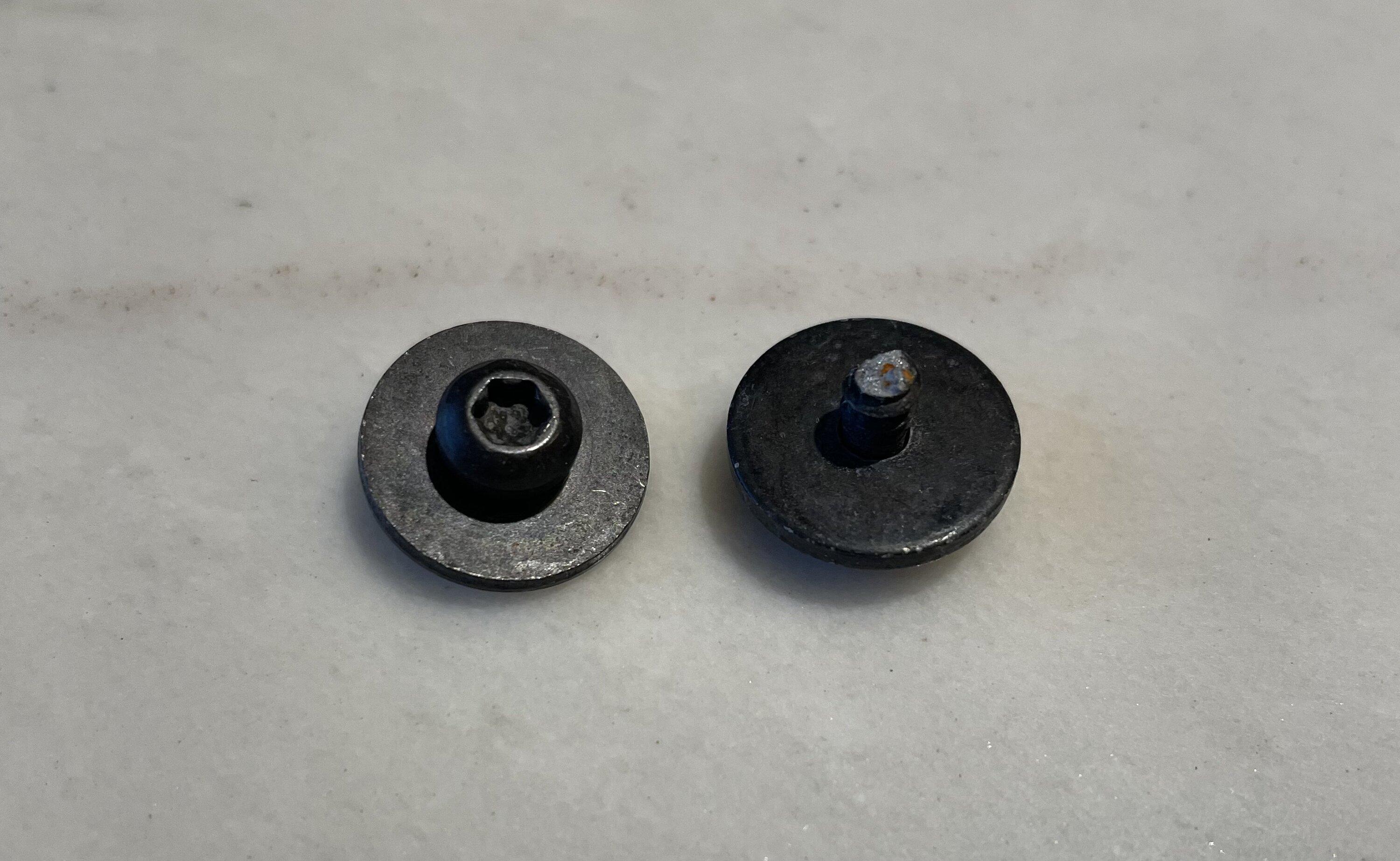

Also look at the plastic trim pieces behind each rear tire. This is where we had several screws sheer off. We’re not the only ones. Rivian is aware of the issue. Literally happened on the third day we had the truck.

sweeping out my garage today and I found three sheered off screws from my R1S.

mobile service scheduled... and only 2 weeks out.

Well now that is just pure BS!!!!
also, they only sent three fasteners when more were needed but tech thinks "the missing ones probably won't matter on securing the panels"
ETA: how the hell don't they have a huge box of all possible fasteners in their service vans??????
