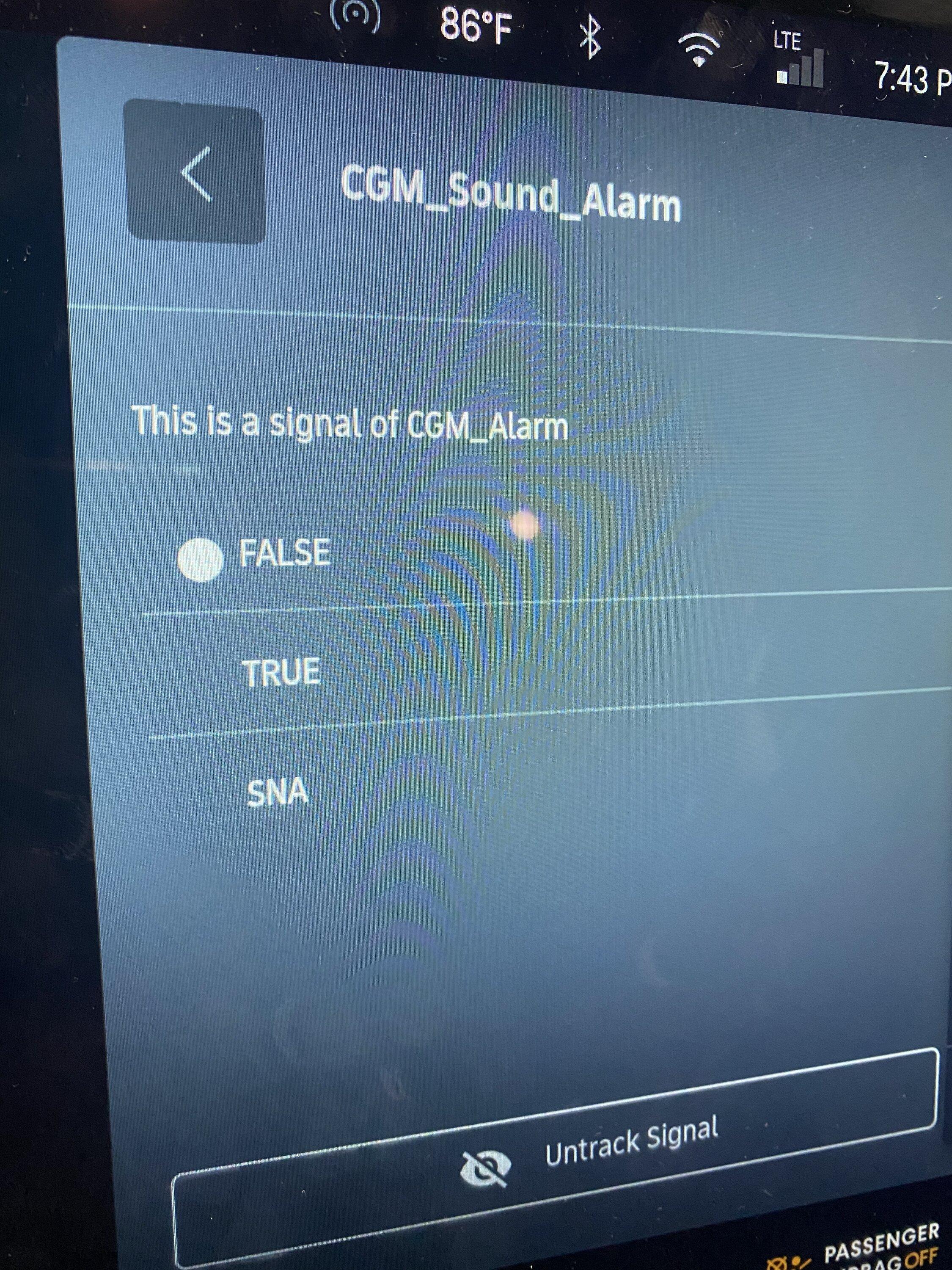

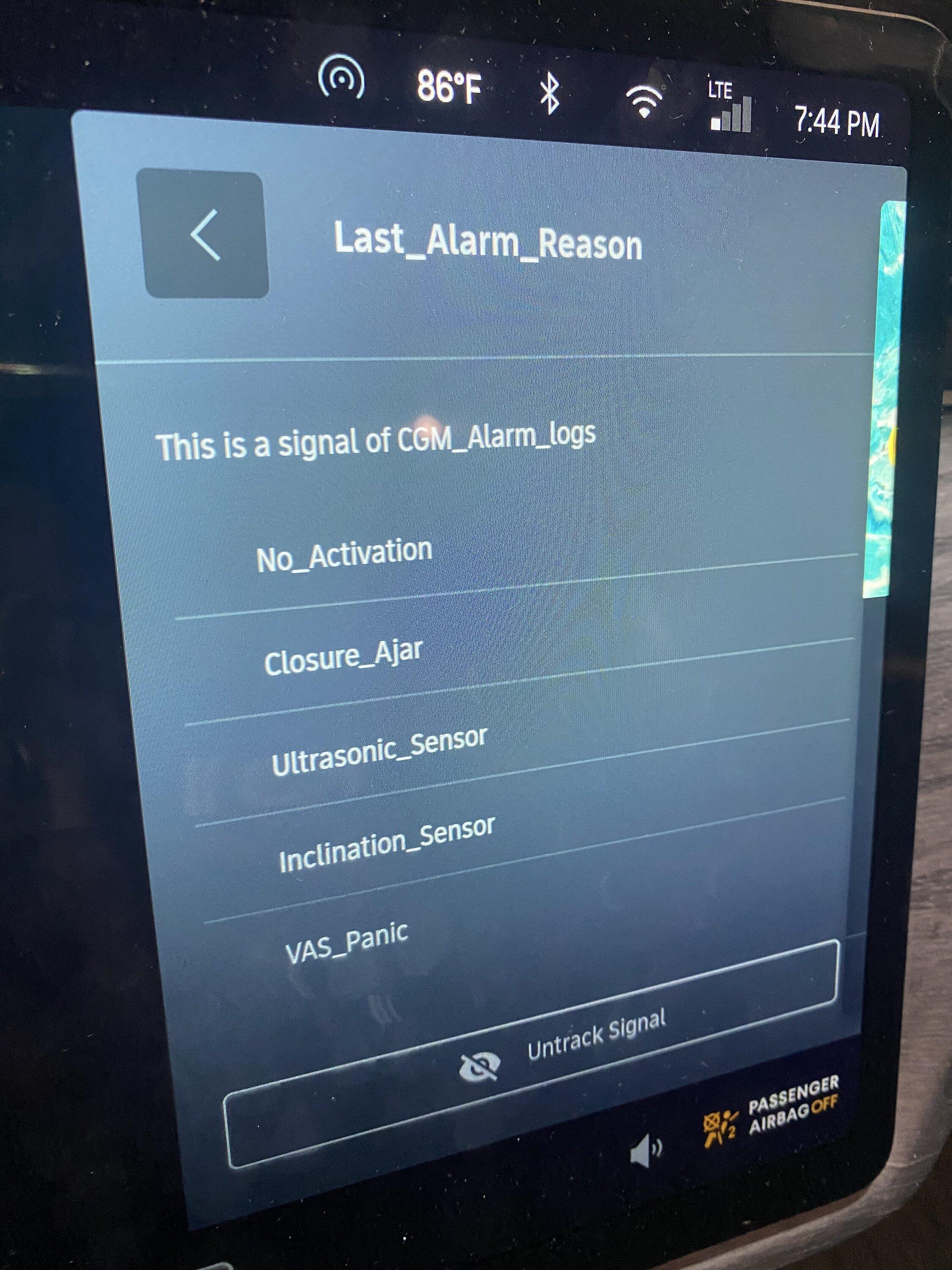

Garage door opener works upon breaking into the car.
I was able to trigger a visual alarm by sitting on the floor, having wife lock doors from outside with fob, and waiting until the gear guard animation played on the screen.
Then I opened the door and the exterior lights started flashing, but no audio.
All options in center screen were available to me including unlock , which released the gear guard cable in the bed.
Gear guard does not have an alarm event recorded.
I also found some interesting items in the service menu.
This may indicate that the audible alarm is off.
