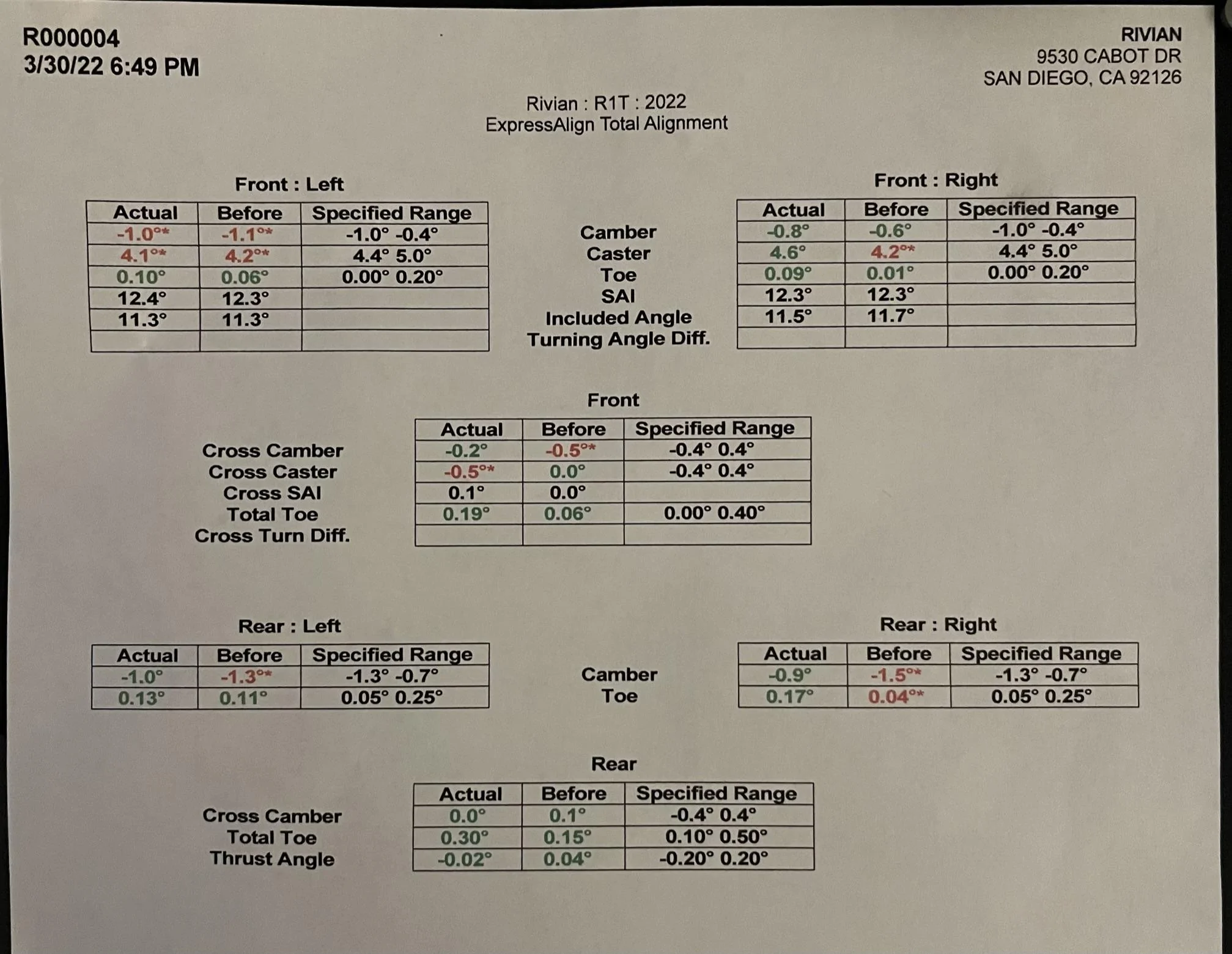

Alignment issues - here is the official spec and Rivian’s first attempt at fixing it. They left the camber and caster way out and tried to tell me it’s not an issue.
Tech said he was trained to set the toe and let ‘em go….

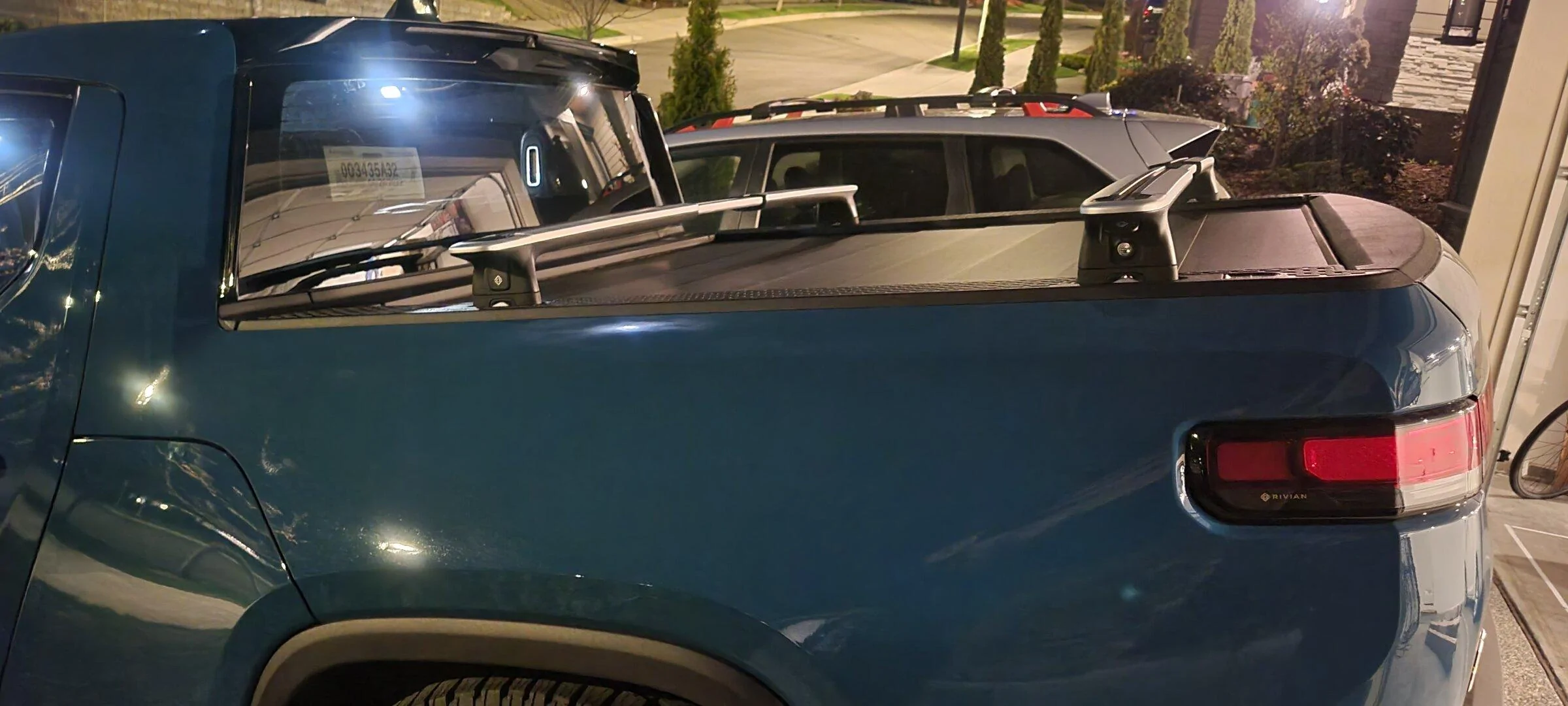

Wait...the tonneau cover slats are supposed to lay flat??? Mine are noticeably ridged after the 2 closest to the tailgate.
Rivian R1T R1S R1 issues for new owners 20220413_230034
Can anyone show a side profile picture of their flat tonneau cover?
