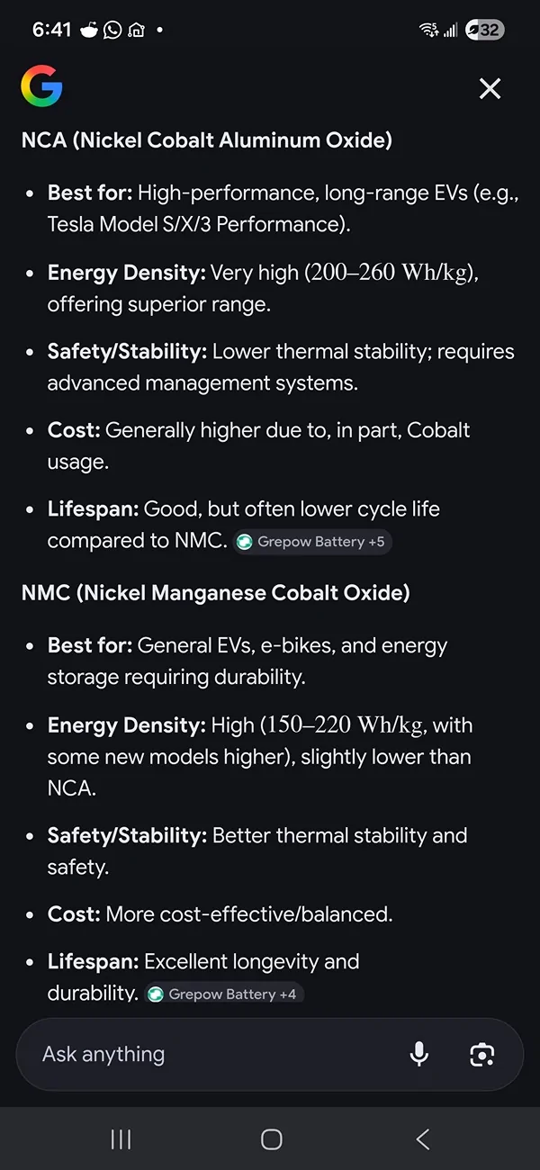

Each chemistry has its pros and cons, as you touched on, but here's the old AI overview.
Rivian R1T R1S R1 Switched from NMC to NCA? Screenshot_20260414_184122_Chrom

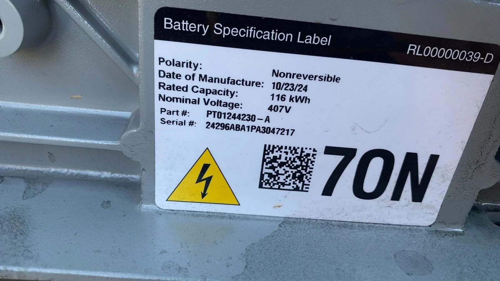

It's interesting that the values here don't align with the specs on the packs themselves. `Rated Capacity` in the tables matches the capacity that Rivian market the usable capacity at - which is lower than the rated capacity printed on the actual packs. Also weird that they have not specified model year at all - leading me to suspect this is all preparing for 'how do we deal with folks being upset that their SOH is not 100%`.
I was also surprised to see these are all NCA - all media has talked about these as being NMC forever AFAIK.
Edit: added image to show label from PT01244230-A - which in the table shows a `rated capacity` of 109.8 kWh.
Rivian R1T R1S R1 Switched from NMC to NCA? 1776266897592-8c

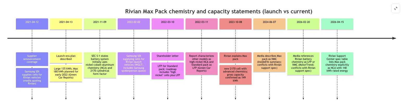

I asked one of my GPU buddies to help, and it looks like NCA has been there since the very beginning - with the media consistently at odds with Rivian's own reporting, the report produced is around 30 pages, but the following timeline probably summarizes it best:
Rivian R1T R1S R1 Switched from NMC to NCA? 1776273232086-k4
