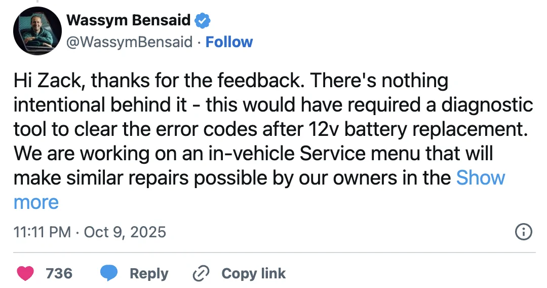

third party service
$350 each, plus cost
Rivian isn't paying retail cost for batteries - not for the AGM batteries, or for Lithium batteries (if they chose to install them). However, the cost to Rivian to replace any battery as a service item is far, far higher than the cost to install a somewhat more expensive battery on the production line. How many millions of dollars do you suppose that Rivian has spent to replace 12V batteries under warranty? Which also adds to their backlogs in service. And also contributes to the impression that their vehicles are unreliable - which will (has) definitely reduce sales.
