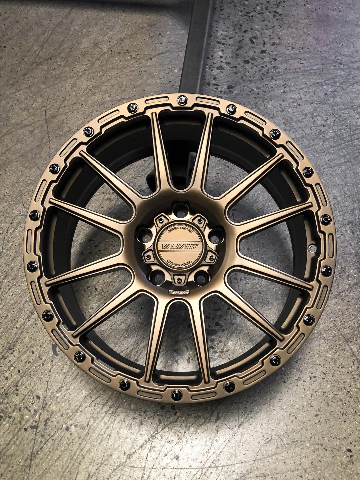

Update......Looking good......should be on the truck by next Saturday assuming powder comes out good on all the wheels....hardware is gloss black....
Very cool! Thanks for blazing the trail!
Can you post under your pic wheel size and width, weight, offset, and price and public availability?

Once the wheels are on the truck and fitment is confirmed, I'll post all the details and Robert from Element Wheels (Variant is the house brand) will set pricing, color and availability. He is absolutely going after the Rivian market and it's a niche that suits his business well. They are headquartered in Chandler, AZ and I have no personal inside relationship with them, they have just built me wheels for other vehicles before.
Because of the huge dish required to build these (clear the caliper), they are monoblock design, which is more affordable and offers great design possibilities. They will not be inexpensive, but hopefully not over $1500 a wheel either.... (I hope)...although Forgeline TR11's are $1550 each and are one-piece, forged monoblock wheels (but they don't fit the Rivian).
The challenge is the market for the short term is quite small....so until someone like Method takes this on, it'll be the arena of custom wheel builders.

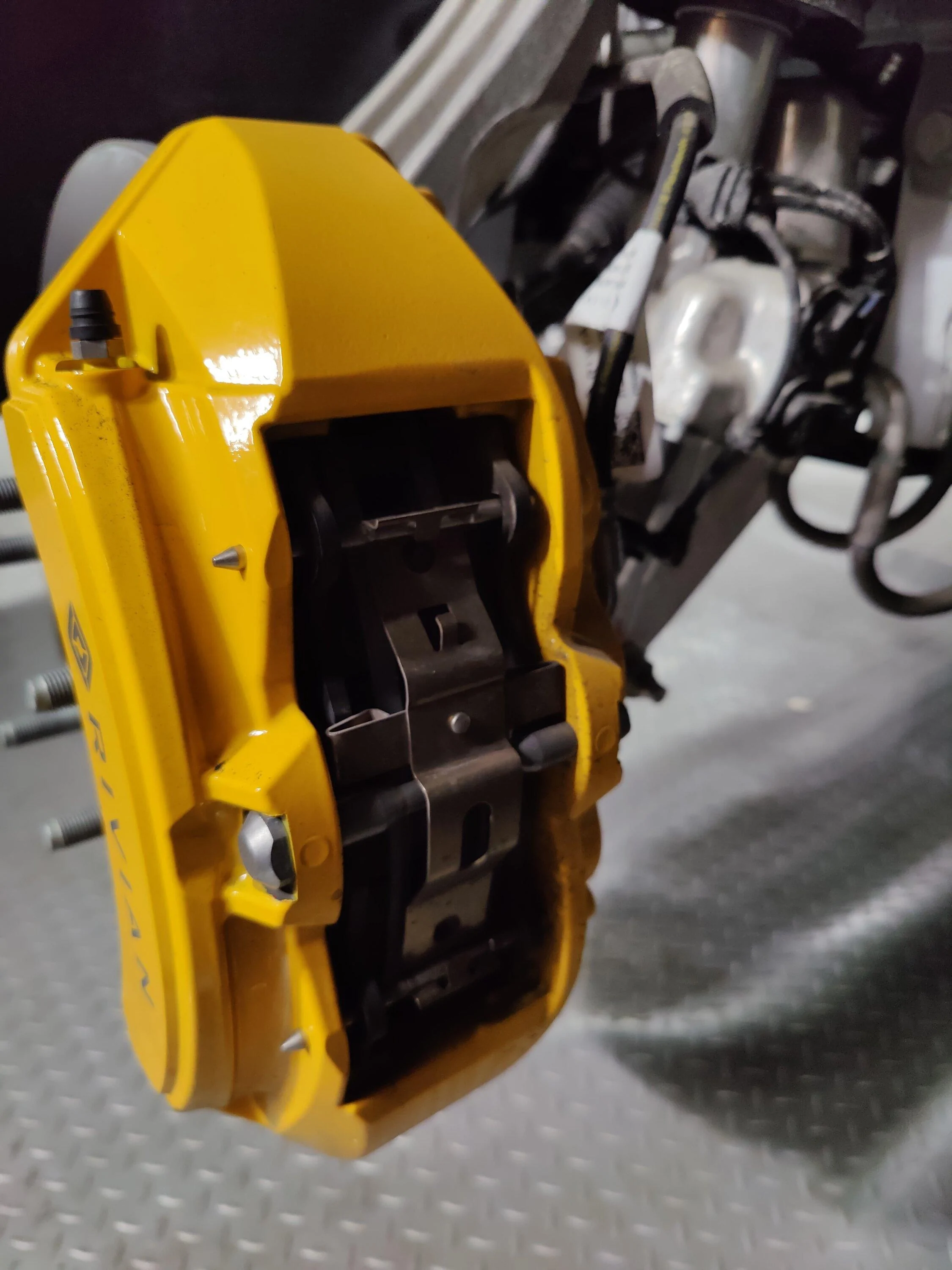

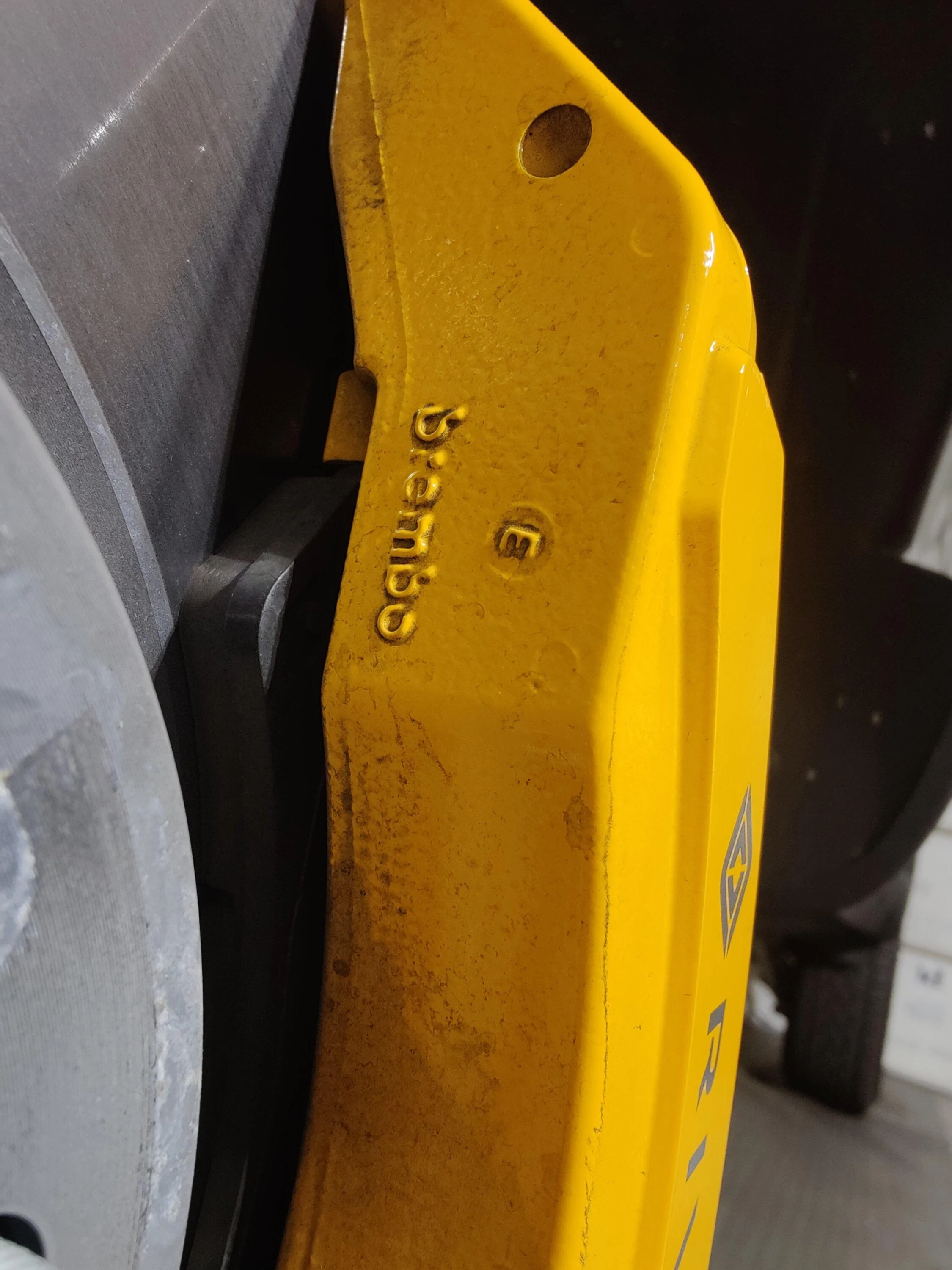

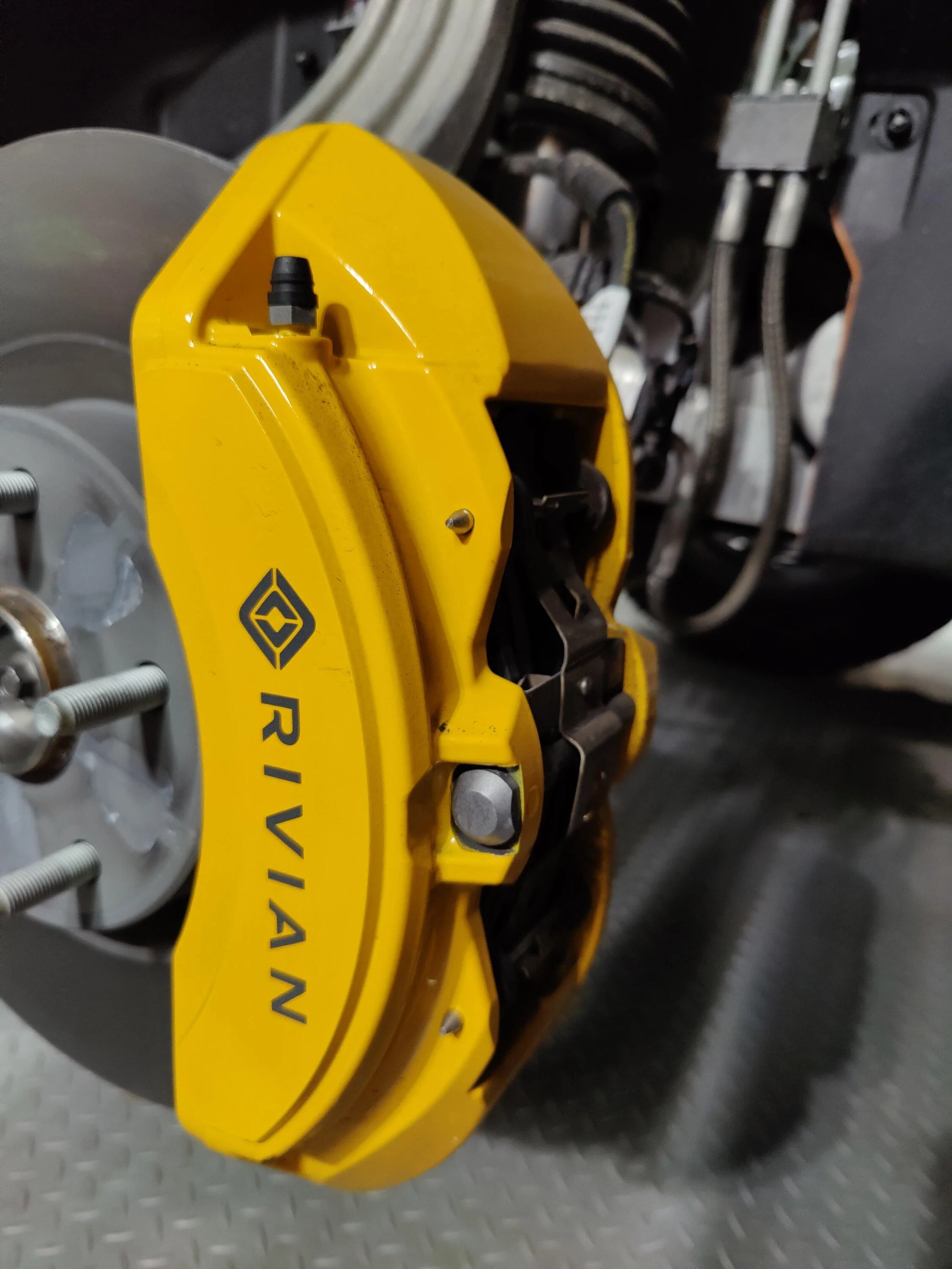

Because of the huge dish required to build these (clear the caliper)....
Is designing the wheel to clear the calipers going to be less of an issue for 21"+ wheels?
Probably not, the caliper is still the same width
So it is the thickness of the caliper not the diameter/length that is making the fit tricky?
It's a combination of the two and also the way Rivian tucks the entire wheel and tire combination up inside the fenderwells with the vehicle in the lowest ride height settings.
As it is now you can rub with AT tires at freeway speeds on compression dips, especially on turns. All of this limits the width of the wheels and complicates the overall designs.
