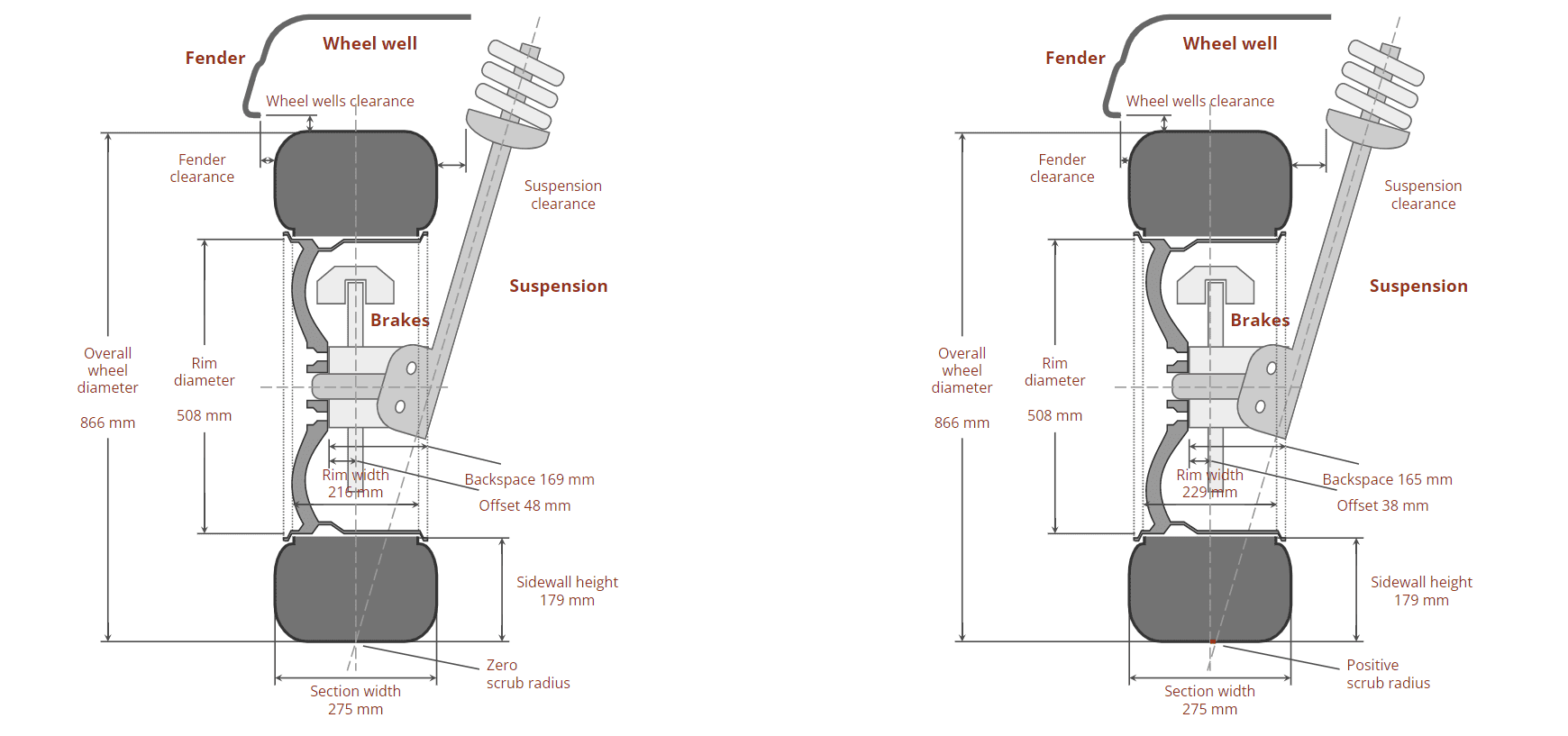

What’s offset at least? Curious the limits of the fender
38mm on the new Variant wheels. 48mm OEM. That pushes the wheels out 10mm more over factory.
16mm more over factory.
20x8.5+48 to a 20x9.0+38 is moving the wheel/tire assembly 16mm to the outside. ;)
Misquote from me. The tires move out 10mm and the wheels 16mm (you're correct). I'm starting to feel that Rivian spec'd the incorrect wheel dimensions for the tires and the suspension geometry and heights......
