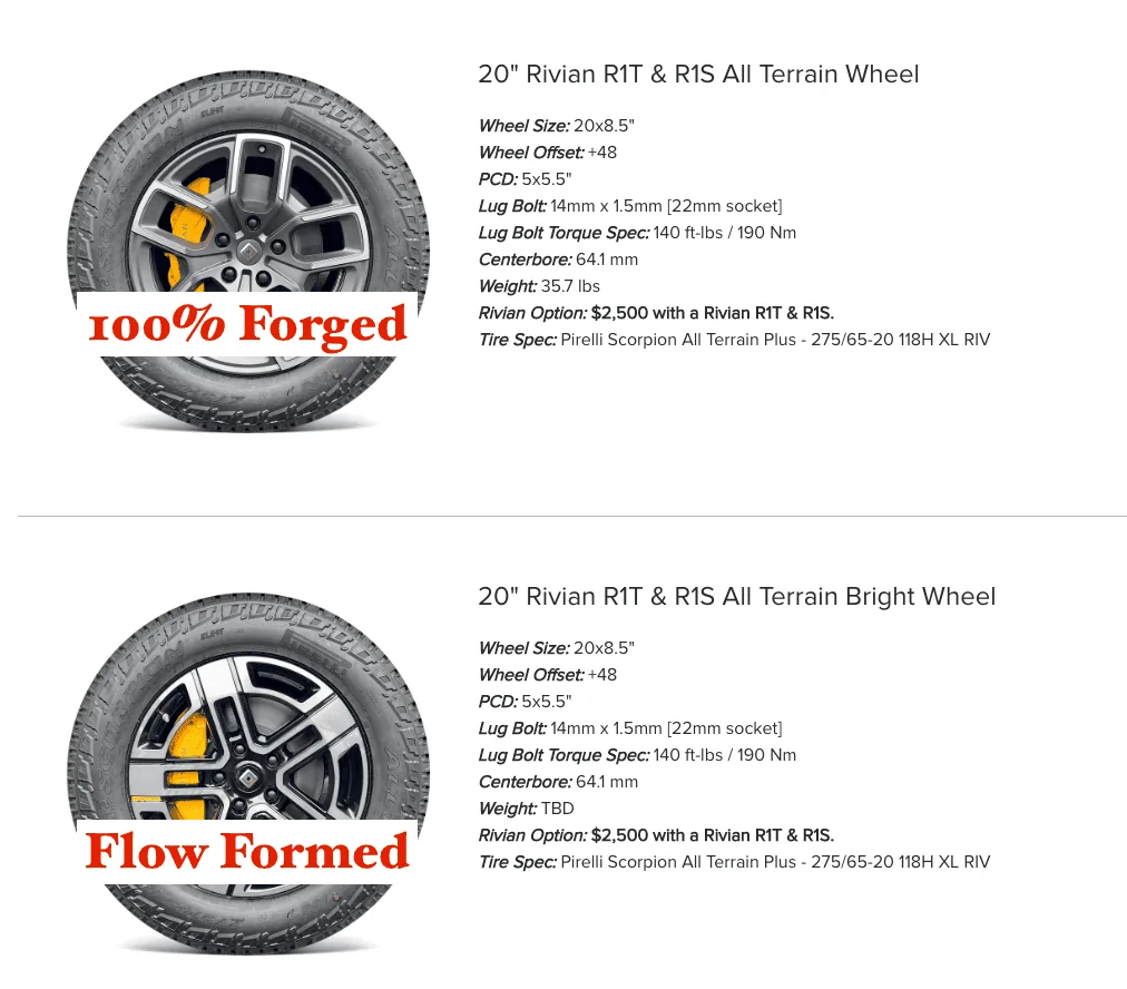

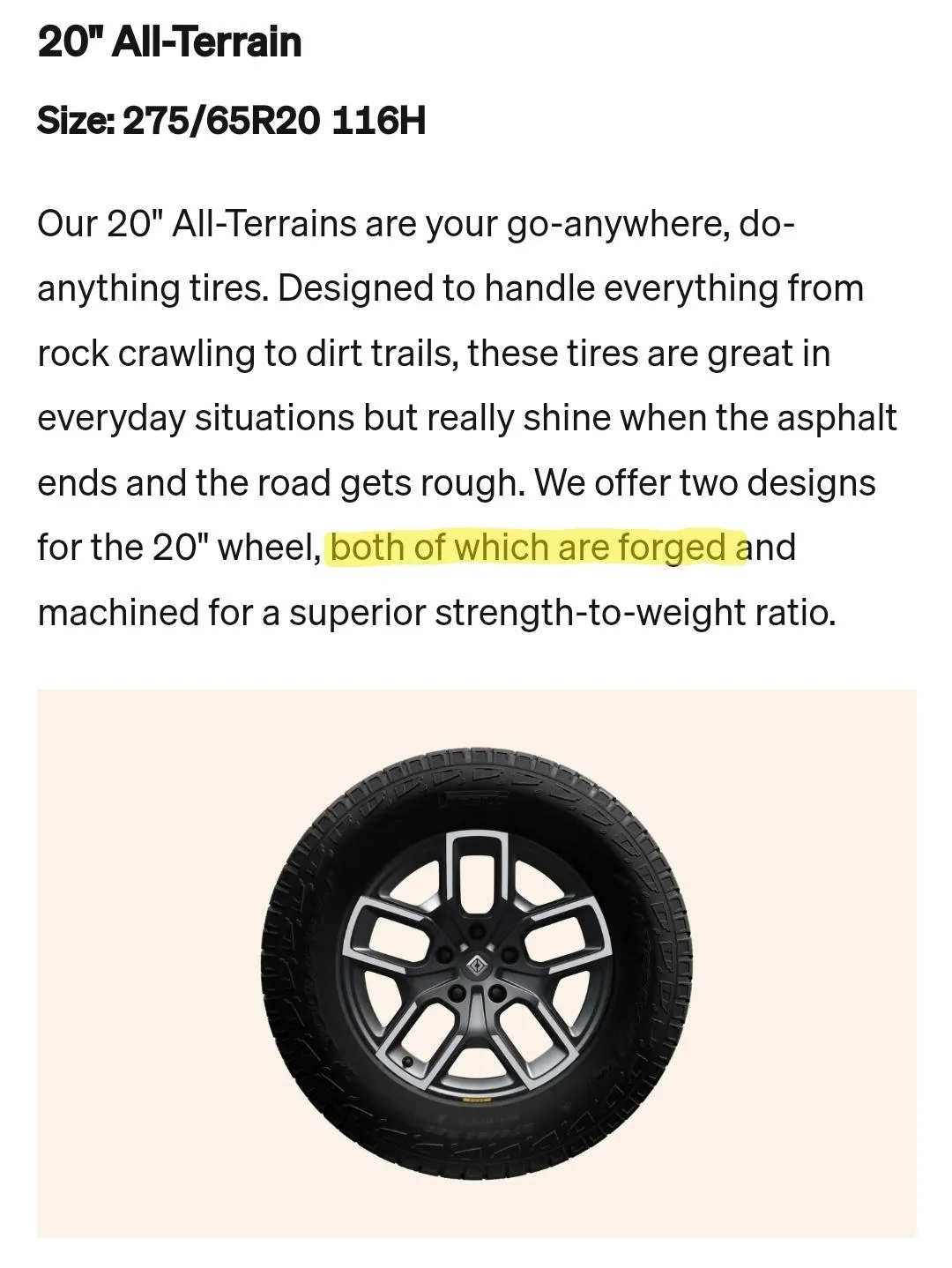

That's not true:
@zymolysis, all 20" factory options are forged.
Pretty sure the 'bright' wheel is flow formed, not fully forged. Haven't seen one for a while, the early one we saw was not fully forged.
Maybe. I don't have the Brights, and I'm no engineer. Just going off the word of the manufacturer that clearly states they are forged.
Yes, makes sense. I recall Tesla call(ed) their wheels 'forged' too....and they are not fully forged. Once we get one off a current car, will share updates!
