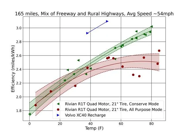

Budman thank you for sharing your graph. I like your avatar.
