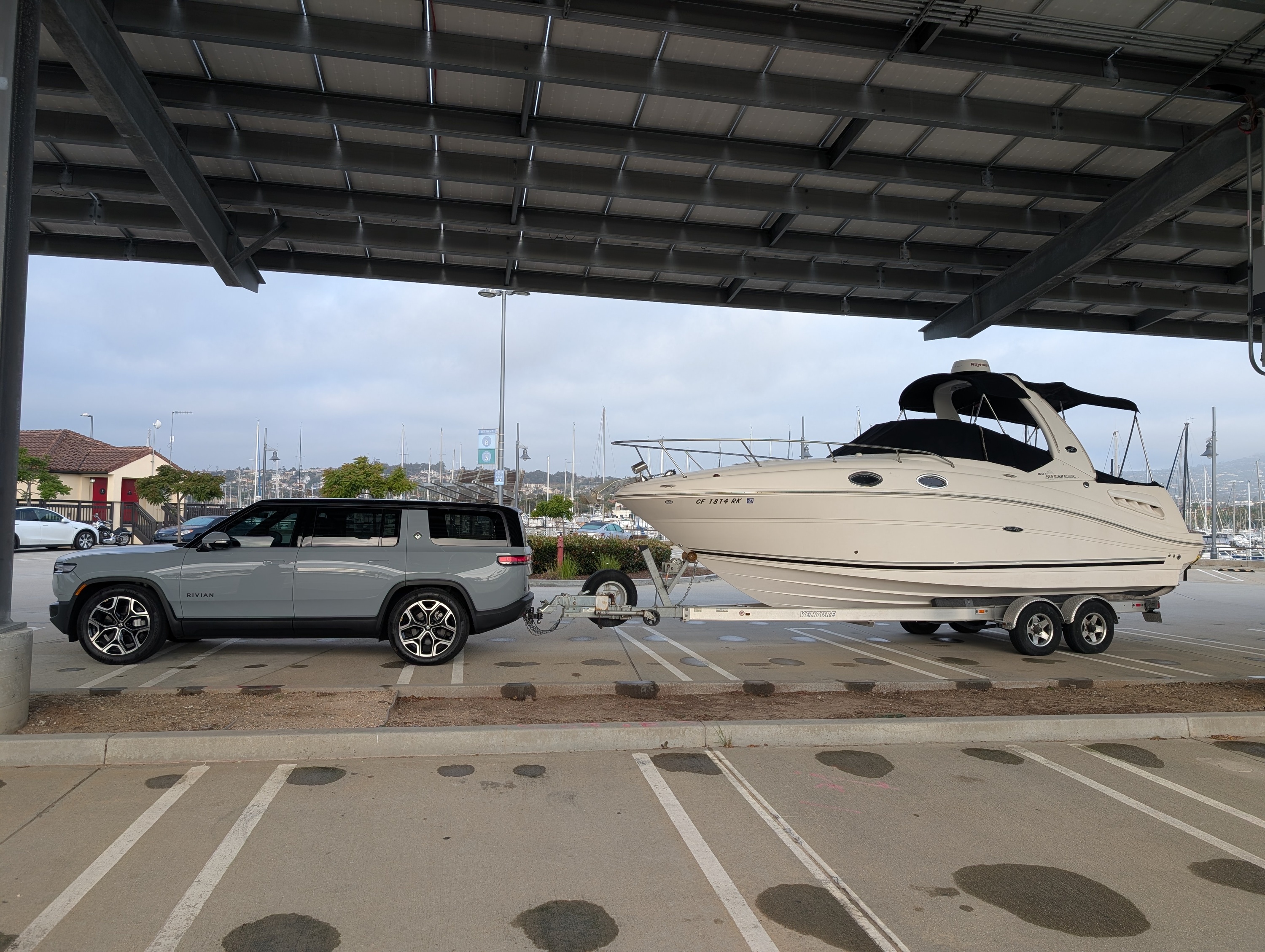

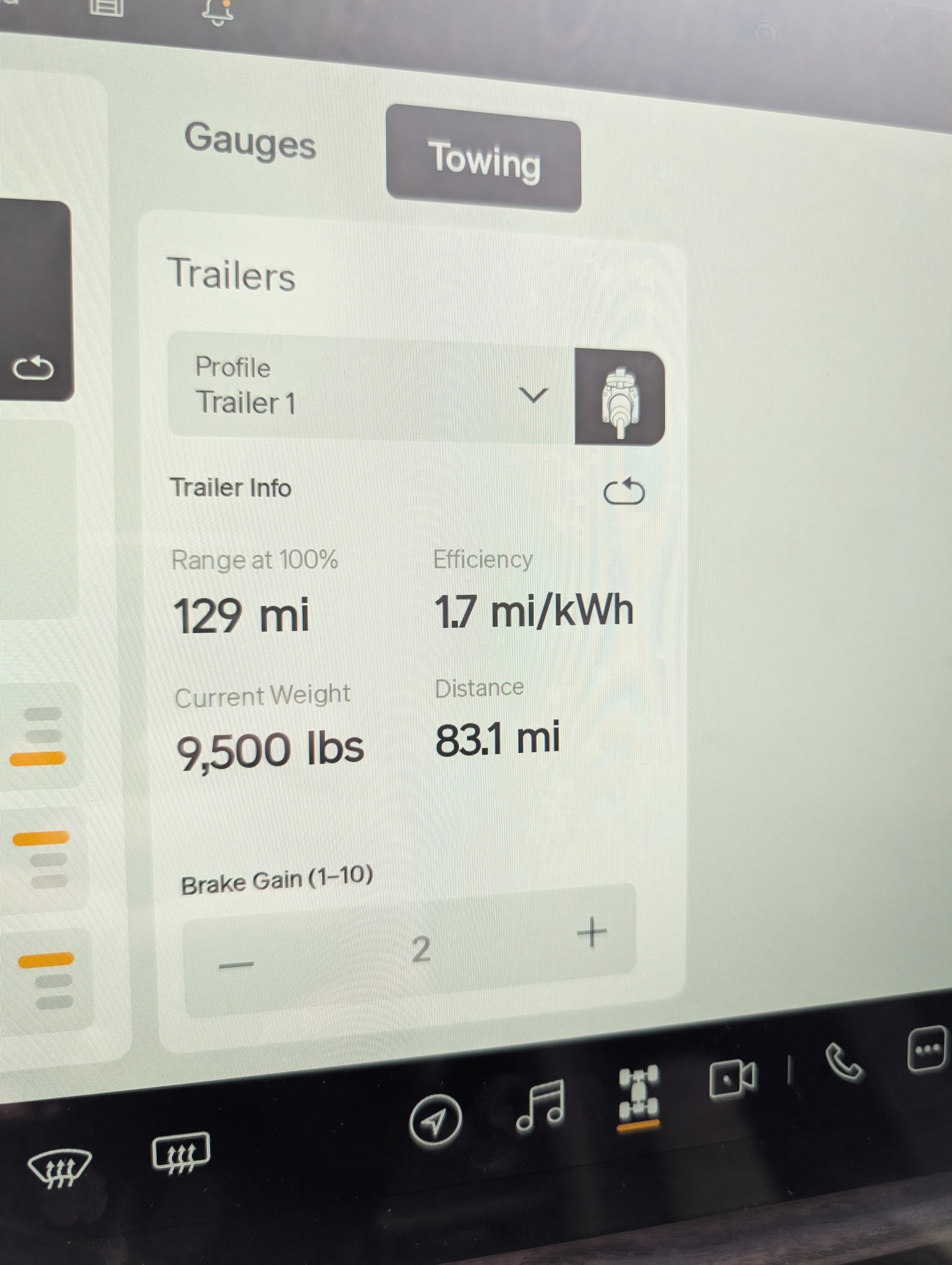

I have a boat that I occasionally (once every few years) need to tow from the marina it is normally stored at to my home or a shop. The weight is over the max tow rating, but I only tow it on surface streets at an average of 35mph and never really exceed 45mph. I'm lucky in that although the total distance is close to 40 miles, almost all of that is straight on a single street. I'm in no rush so just take it easy.
I usually rent or borrow a 3/4 tom truck to do this. This year I towed it home with a friends beast of a GMC Diesel. Once home I decided to hook it up to the R1S and just take it around my neighborhood. It pulls it so effortlessly. The car calculated total weight at 9500, which is likely close. I know the boat weight 8500 since it goes in and out of the water via a crane. Not sure exact trailer weight.
After the neighborhood trip, I took it a bit farther to a shop to get the hull stripped and then eventually took it all the way back to the marina. I don't know that I ever even used the brakes and the regen was able to easily slow and stop. Really both getting going and stopping was much better with the R1S, which isn't surprising. I have no intention of ever towing like this on a highway or at higher speeds. The low speeds I was at the car was easily able to control and never really felt the trailer pushing around the car or unsettling it.
I'm certainly not recommending others do this but just sharing how it went for me.
