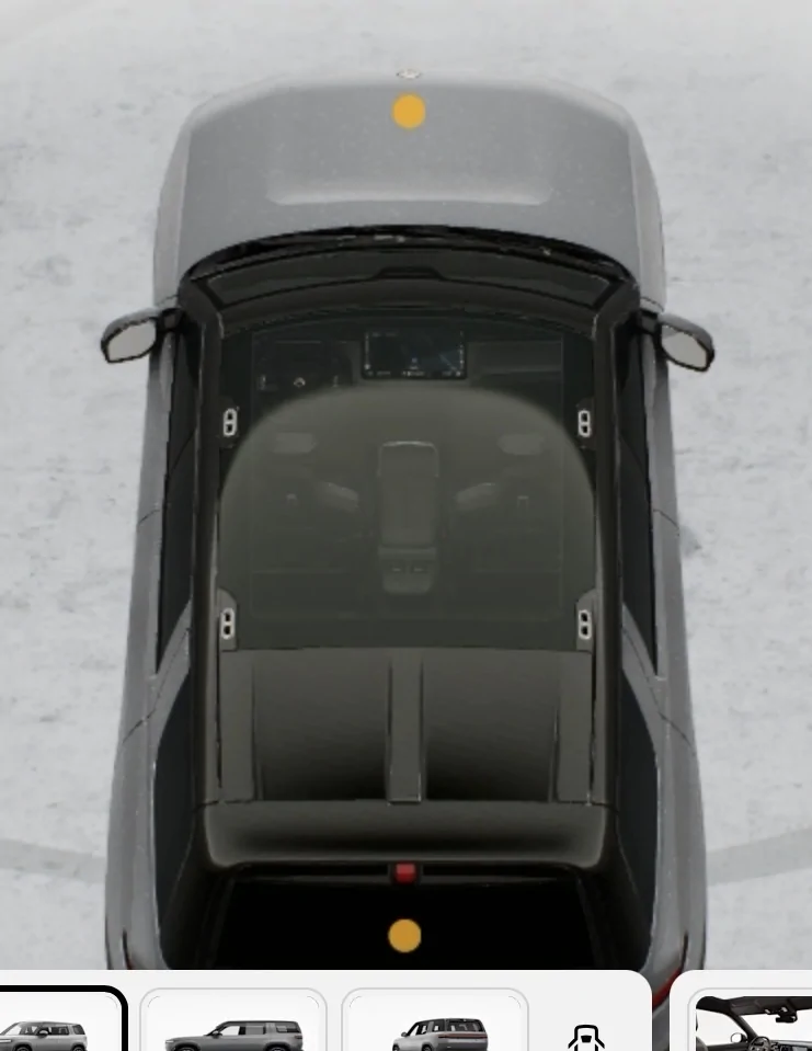

The glass ends at the back seat, the cargo area will get some sun at an angle from the glass but not direct.
Assuming the glass is similar to the R1, I’ve never had any issues with heat on my bald head in my R1S and have been in the southwest deserts with temps over 110 in full sun.
Rivian R1T R1S R2 cargo area air flow for dogs IMG_4714
My neighbor is biased... back in 2021-2022 when testing in death valley, he had to cut out a piece of cardboard to protect his head from the heat coming through the glass roof.
