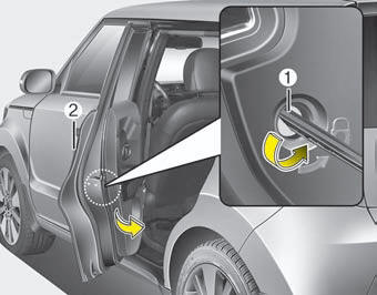

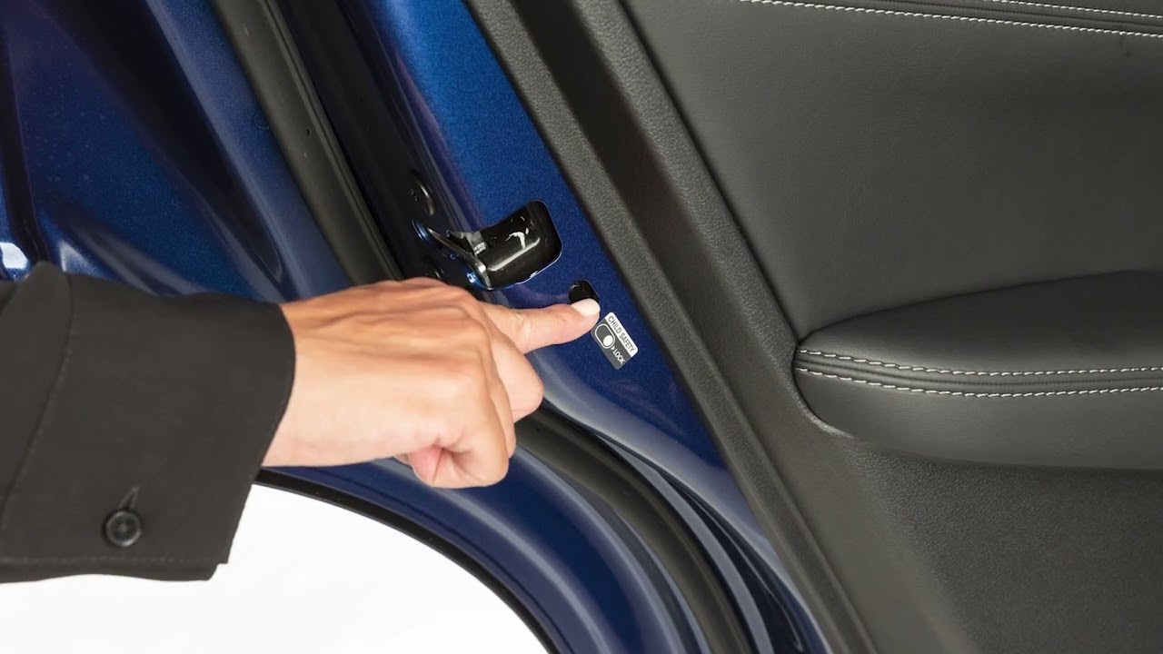

Every other vehicle sold in the U.S. has rear door child safety locks — it’s a safety requirement that’s been around for FOUR decades.
In most vehicles, it's a little latch/switch/key cylinder on the rear edge of the door. This isn't rocket science.

If you are going to do electronic child locks, rear physical door handles should be MANDATORY in the rear seats. That way, if the child locks are activated, the crash will unlock it immediately, allowing the rear passengers to escape WITH the handle.
I also don't understand your comment about a child overriding a software-driven lock while stationary or while in motion. Even with physical rear door handles, they can only open the doors if the parent has not enabled the child safety lock feature on the rear door. If the parent was dumb enough not to enable the lock, of course, they could fall out.
And adding on to that, many cars won't even let you open the door once you reach a certain speed anyway -- even without child locks enabled.
