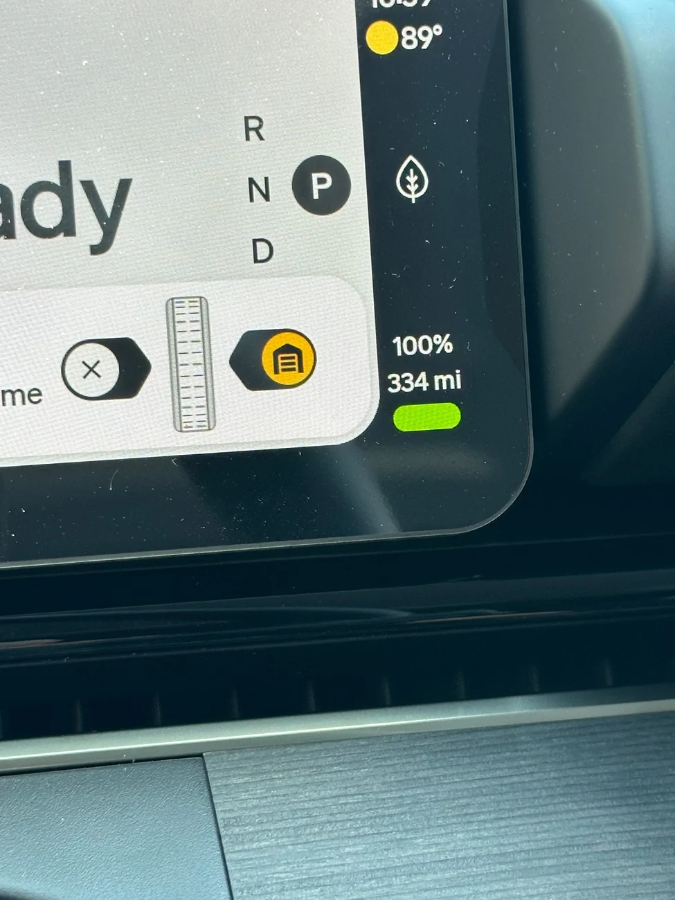

Now for the drive. Used conserve for the entire drive, at 100% it estimated 334 miles.

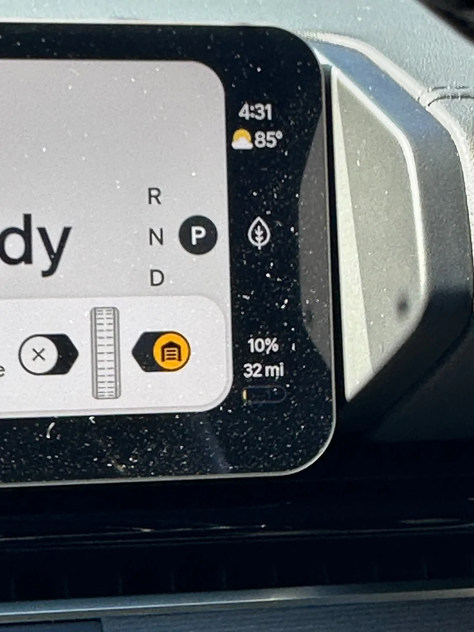

The drive was 252.9 miles, all was highway except for 9 miles. If anyone is familiar with SoCal freeways were 405/55/91/60/10. Drive was North Orange County to the Coachella Valley and back. Arrived back with 10% with an estimated 32 miles of range left. That could get me around 285 miles in normal highway driving.

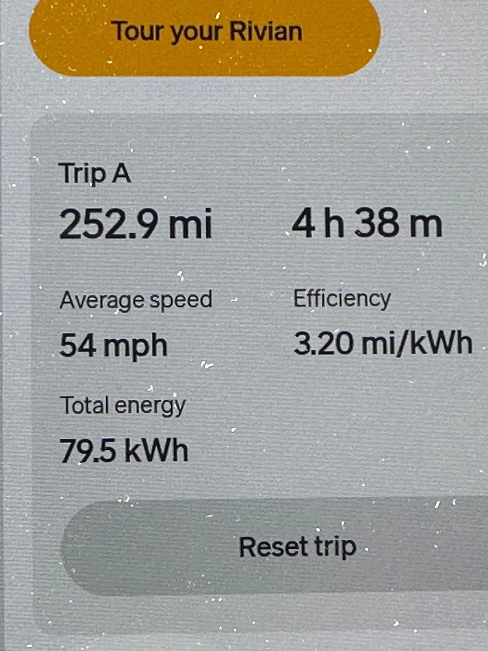

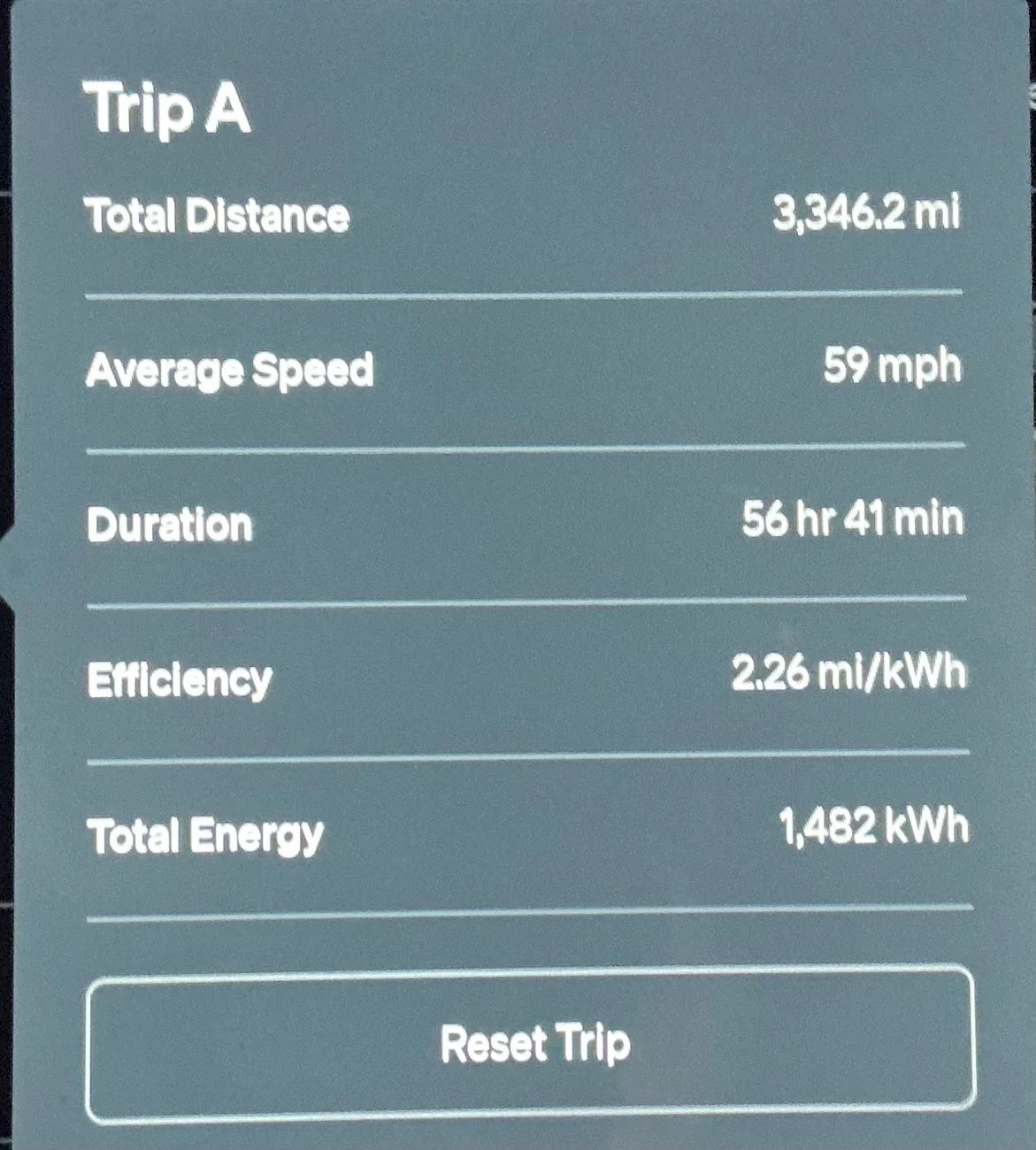

The car was comfortable and quiet, we used the soft suspension setting in conserve, it smoothed out expansion strips but still held the road well. Based on this test (no charging today) I think it will be a decent road trip vehicle for us. I was hoping for a 2.8 m/kWh average, it ended up at 3.2 which is almost 1 full mile better than the 2.25 I usually see in the R1S.

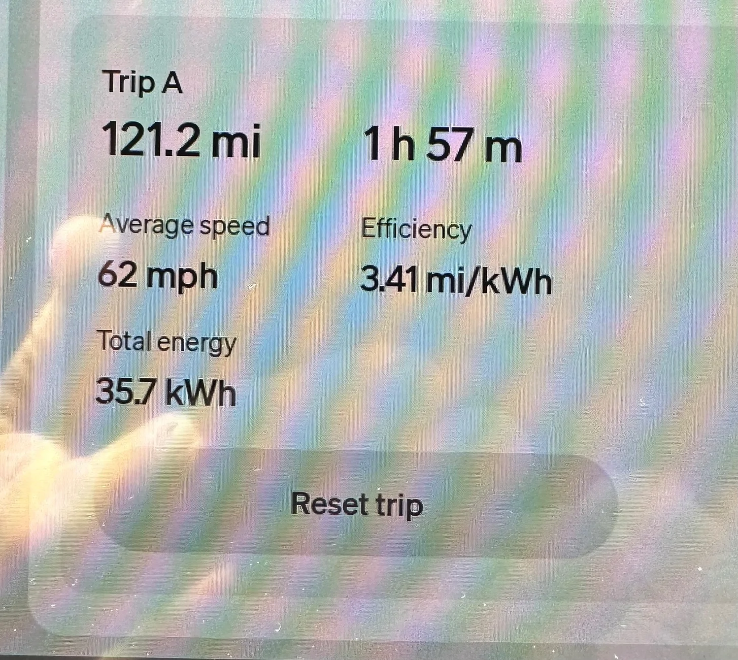

this was the destination total at the turn around

The first part of the trip out had a higher average speed and a better m/kWh.
It was over 110 out there, The 8 miles driving around there and the high temps hurt the average speed as well as the m/kWh with the BMS maintaining the systems. I usually park in a garage out there but was running errands so the vehicle was baking in the sun.

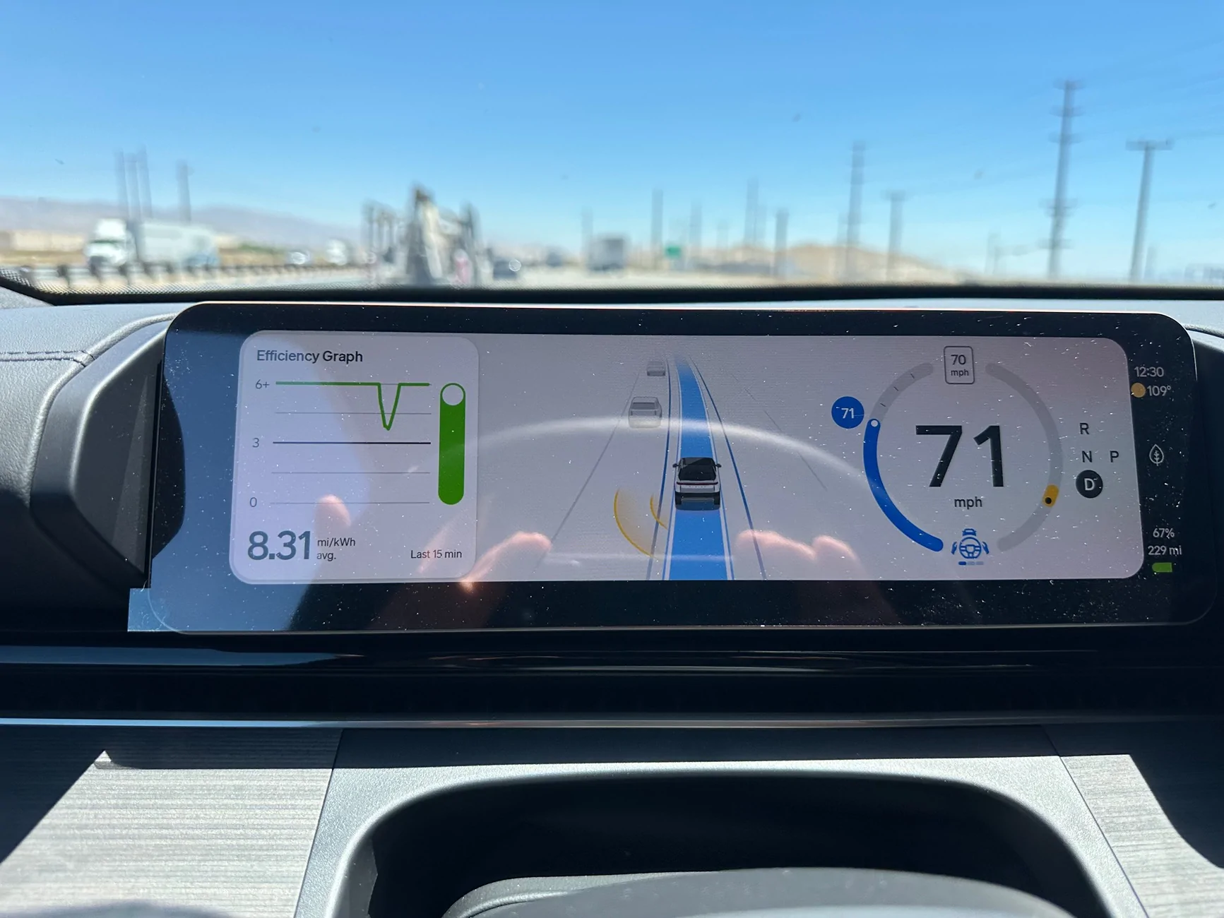

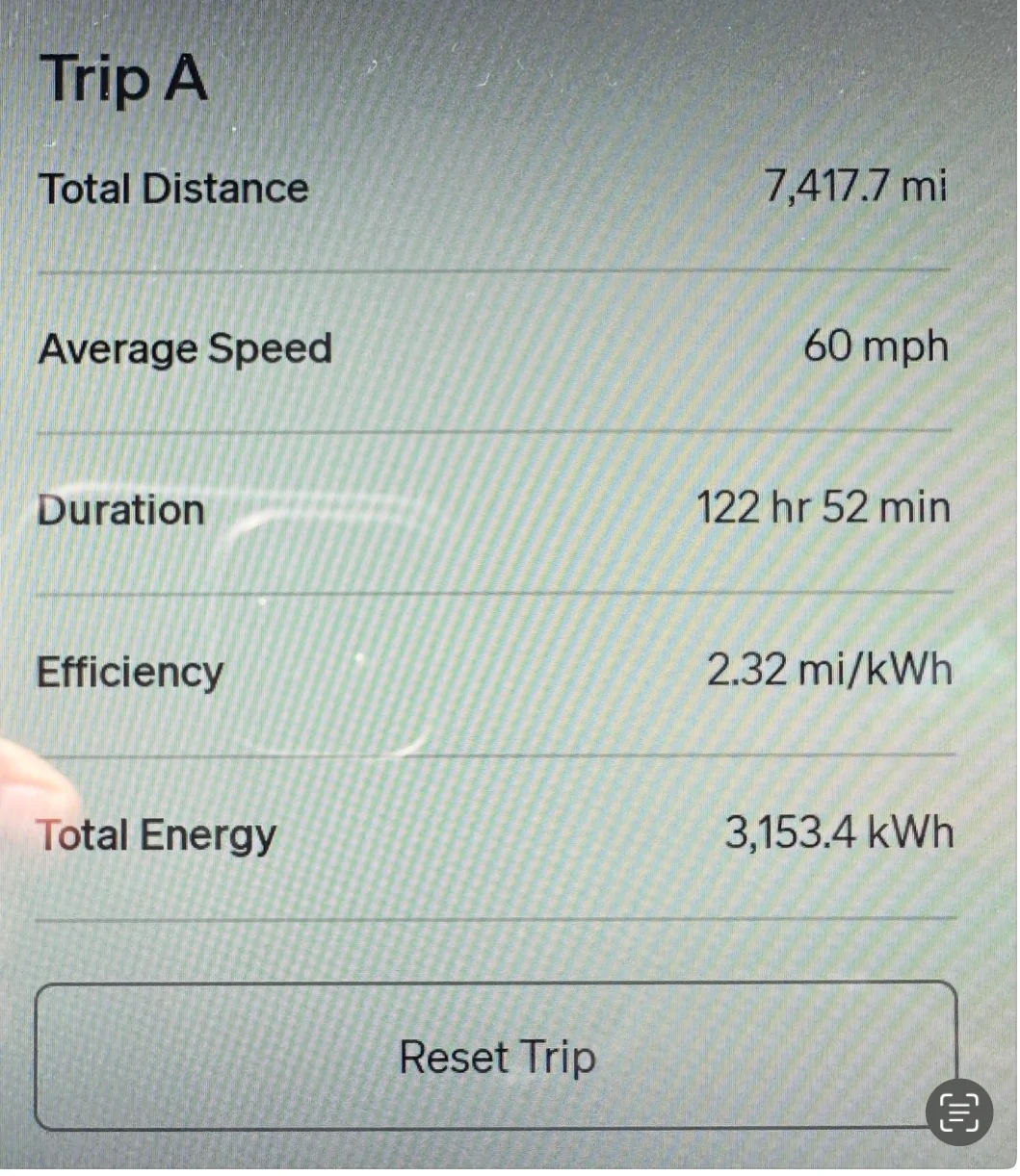

Many of my trips average in the mid 50s low 60s by the time I get home. These are a couple of R1S trips.
