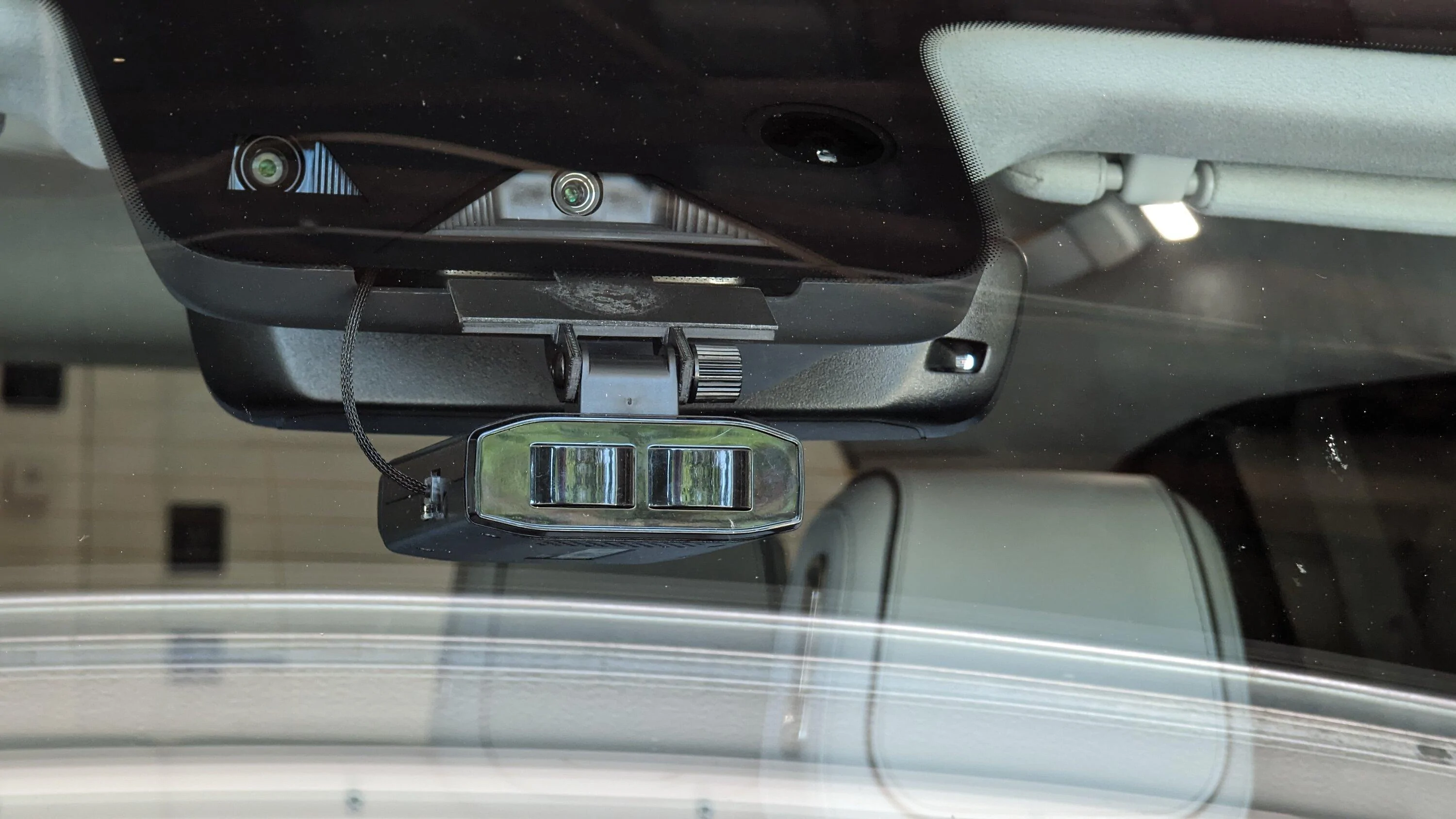

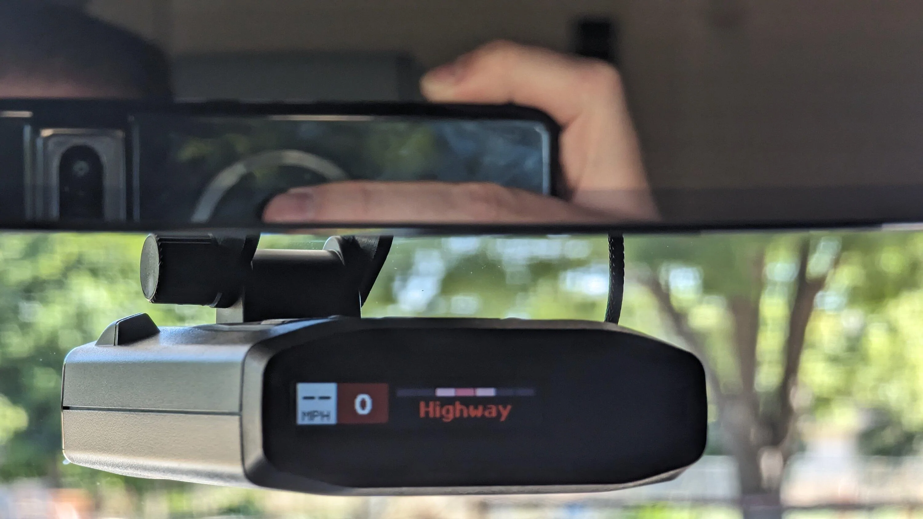

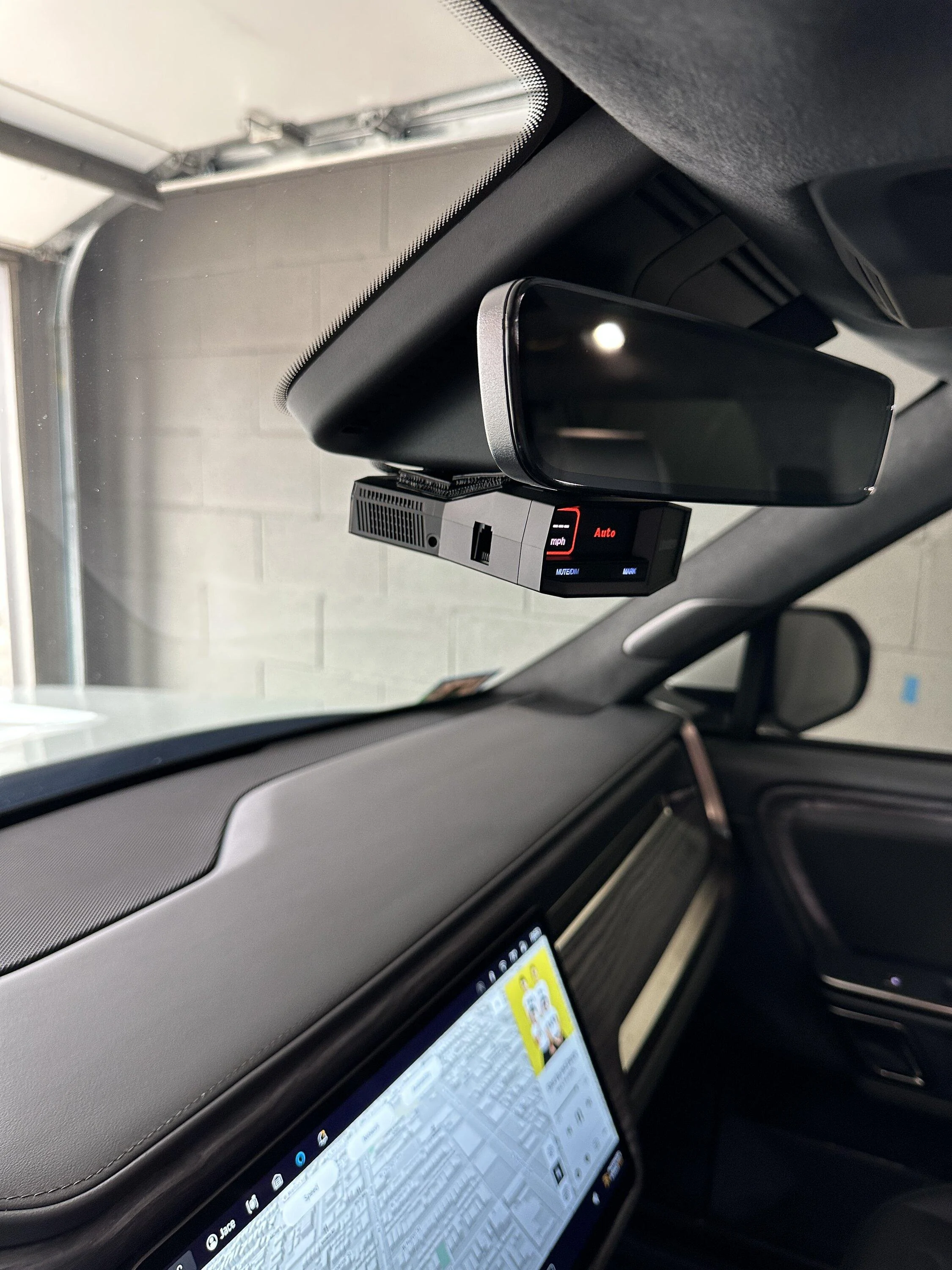

I got my Uniden r8 mounted perfectly and hard wired to the rear view mirror. Follows tips on this short YouTube using blend mount wire taps and some 3M Velcro (similar to big EZPass strips pictured below).
Rivian R1T R1S Radar Detector hardwire, who has done it? IMG_6116
Rivian R1T R1S Radar Detector hardwire, who has done it? IMG_6119

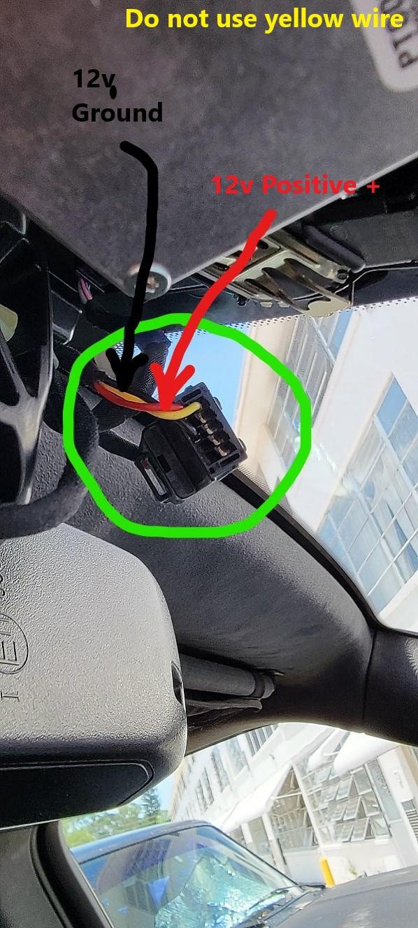

Hello. Maybe it's because it's past bedtime, but I'm confused by notes written in the image. The detector requires a power lead and a ground. There is a note saying not to use yellow wire, but also a note indicating yellow wire as ground. Tap red for power, I get that. What do you do with ground lead for the detector cable?
Never mind. I see now the black arrow is actually pointing to a black wire (which isn't just something black in the backdrop. Definitely time for bed.

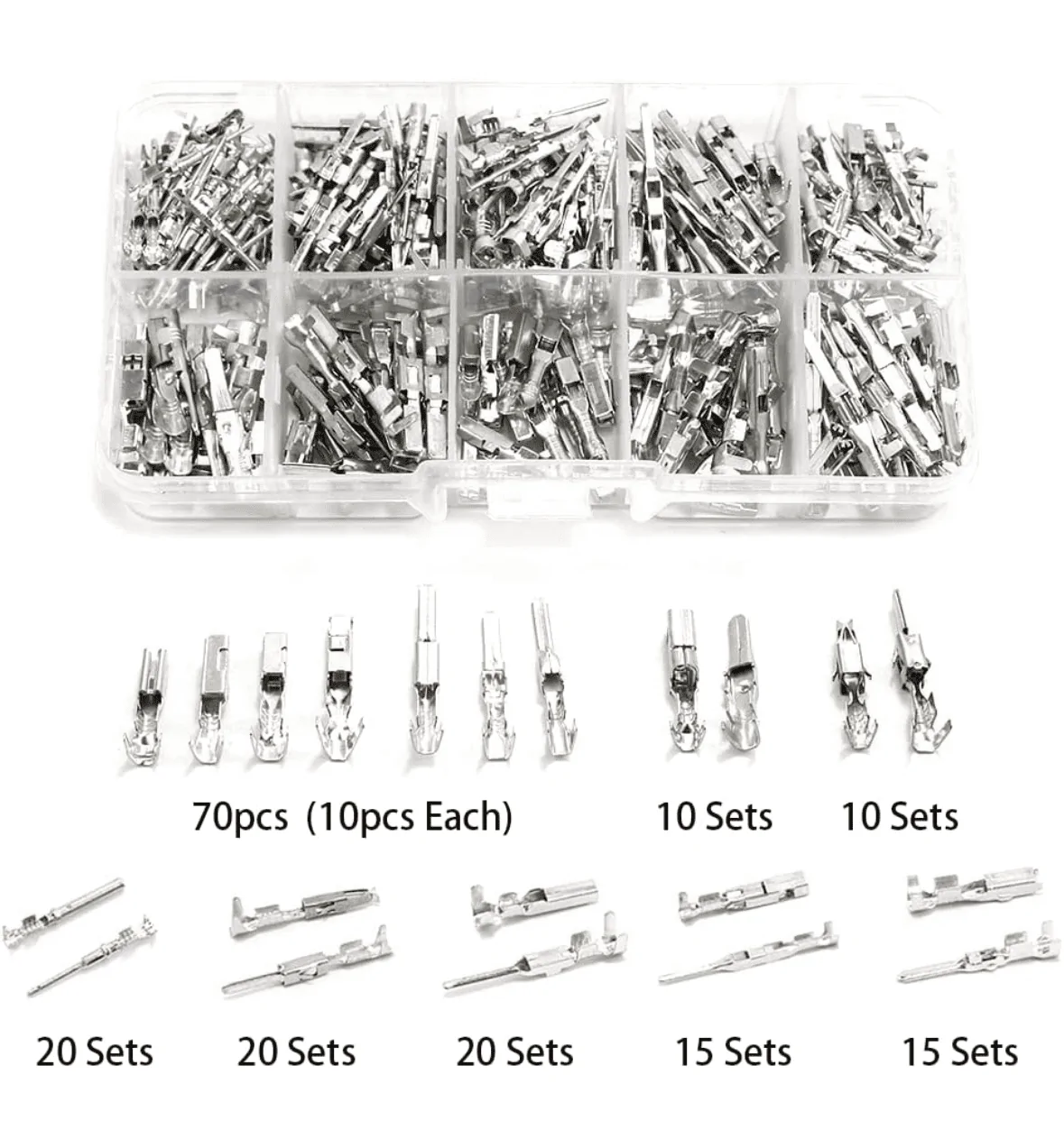

Will need to add my own male crimp pins. I noticed for the radar detector cable products, most folks were using the smallest provided pin.
Wondering if any of these might fit the bill? Obviously can’t really tell what size they are from the photo though. But hopefully I can narrow down an end profile?
Car Electrical Wire Terminal 1/1.5/1.8/2.2/2.8/3.5mm Auto Electric Connector Non-Insulated Plug Removal Male Female Crimp Pins (Color Name : 290PCS Sample) https://a.co/d/8EXng0W

this is what I used :Gikfun 100 Pairs Suitable for 22AWG Cable Male and Female Pins Connector Kit fit for Connector Housing Jumper Wire Cable DIY Kit EK8284 https://a.co/d/glulncG

Great! Thanks for the quick reply. Just ordered.

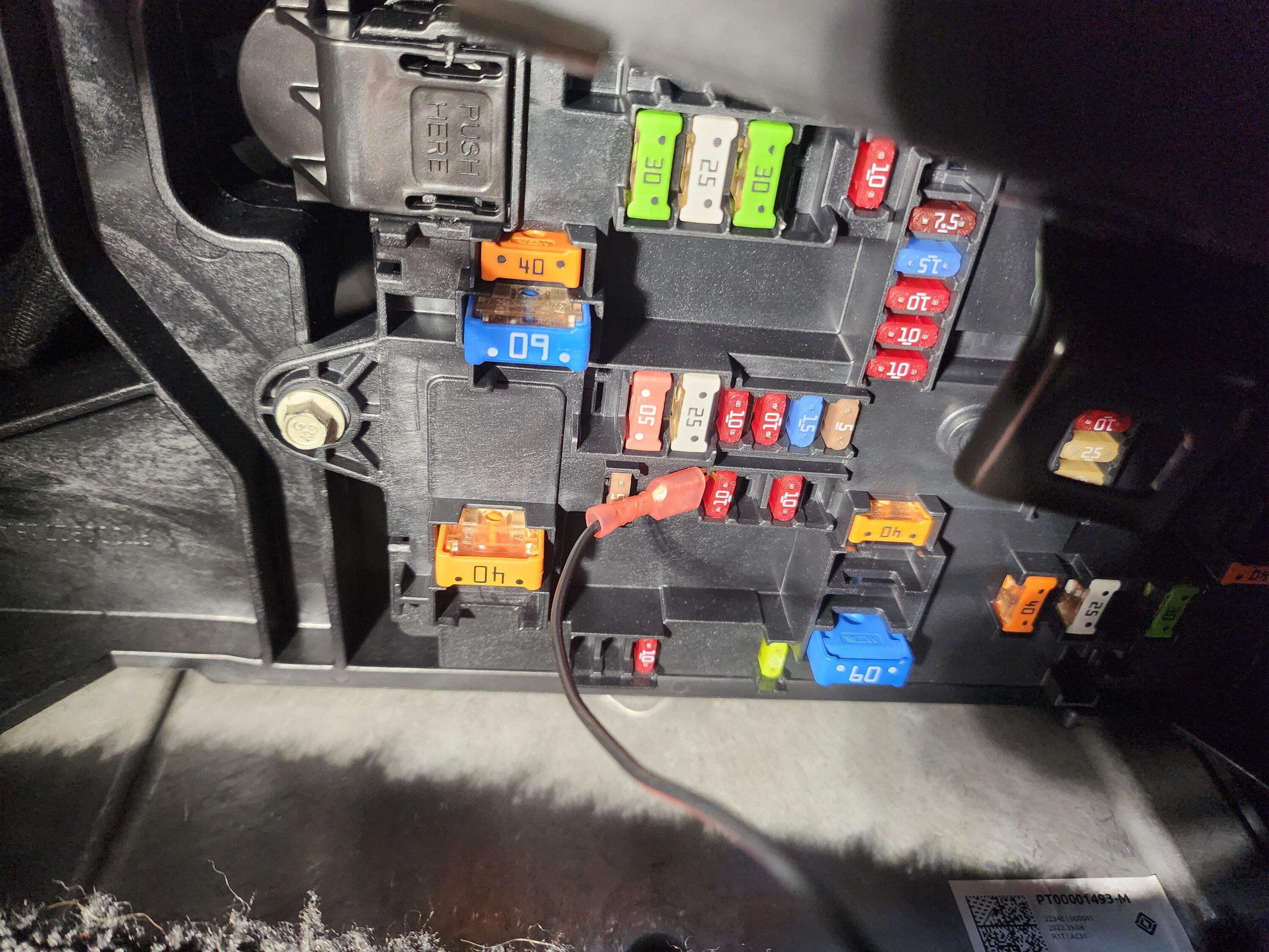

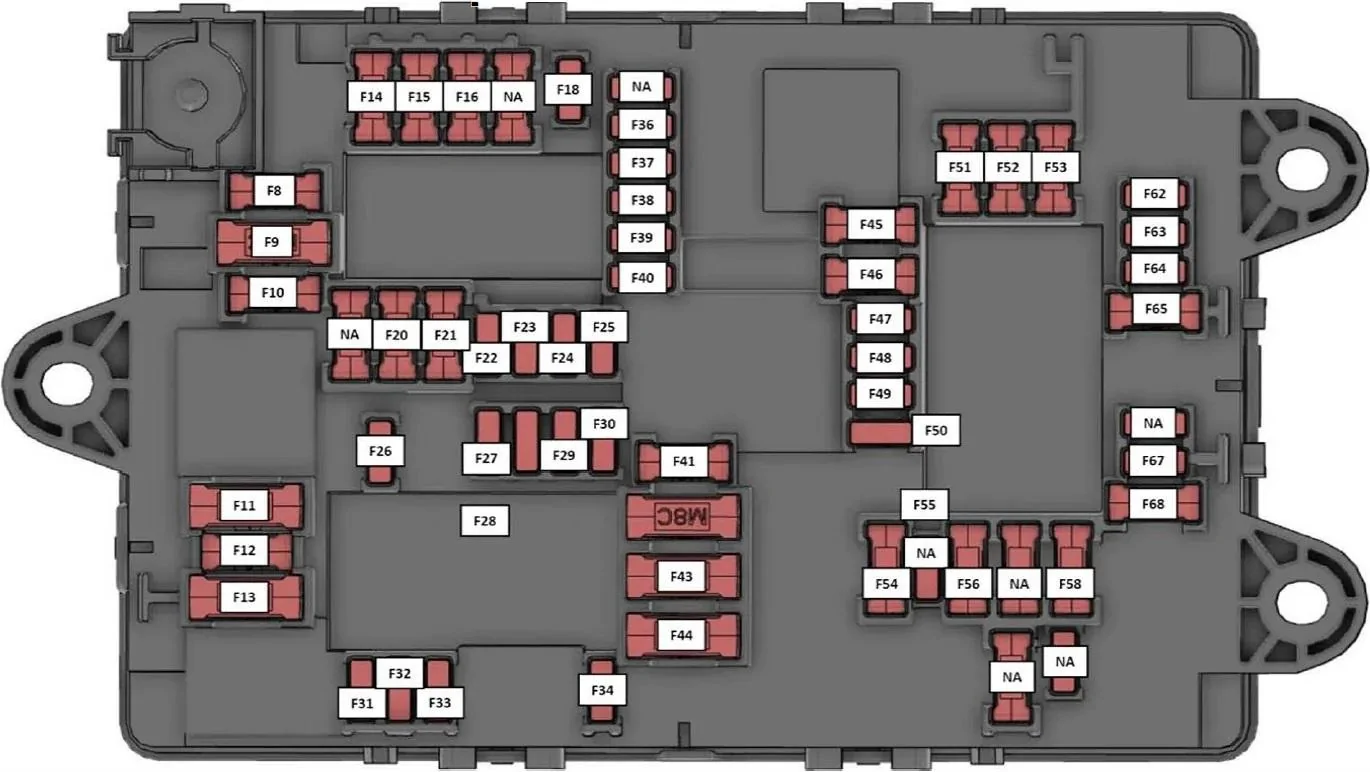

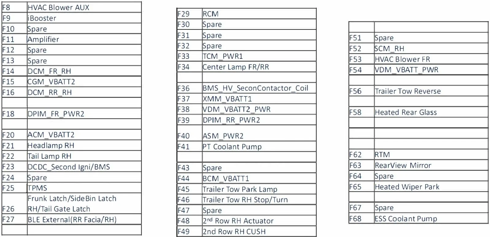

I am sorry I haven't gotten back to moving the fuse yet. Yes, I tapped into an always-on fuse and plan to move it to F25 TPMS mini fuse 5Amp (or F62 RTM or F63 RearView Mirror). See, attached pictures for locations.
I plan to use whichever gives me the best access.
And, yes the fuses used on mine are "mostly" standard mini fuses. Given Rivian's track record on changing things on the fly, I suggest you pull your panel off and see what you have installed.
I have included a picture of my current install. It basically takes a T25 to take off 4 screws to get to the fuse panel.
Hope I can get to this project next week and I will post more info once done.
Lastly, I plan to move the wire from the windshield side of the A-pillar to the door side after talking to a Rivian tech. The windshield side is not easily pry-able to hide the wire where the speaker is located and the Rivian tech suggested going on the other side and then fishing it through once I get to the roof liner.
Rivian R1T R1S Radar Detector hardwire, who has done it? 20230621_154116
Rivian R1T R1S Radar Detector hardwire, who has done it? Passenger Side fusebox
Rivian R1T R1S Radar Detector hardwire, who has done it? Passenger Side list of fuses
