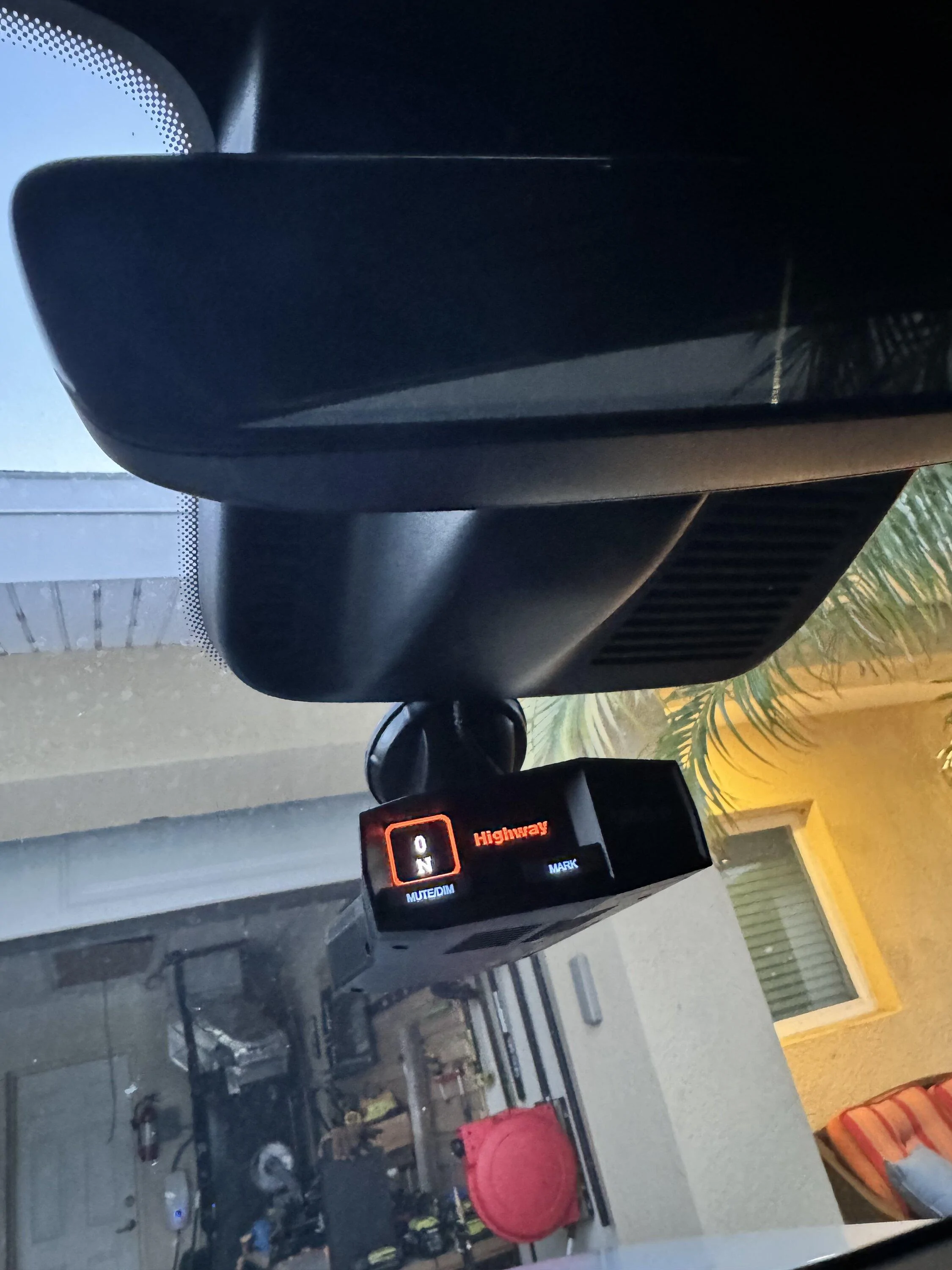

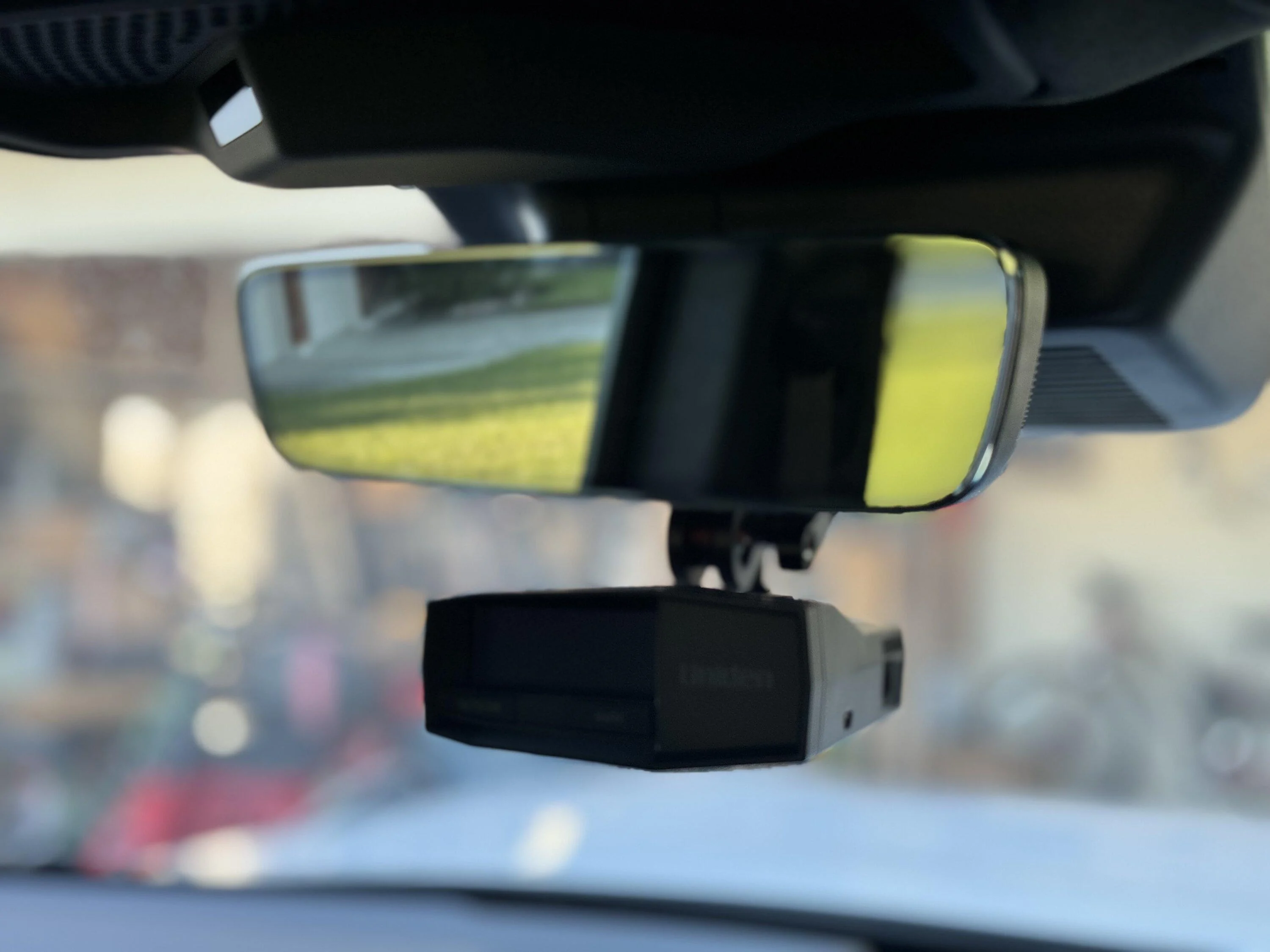

I just wanted to post my experience in trying to mount my Uniden R8 in my R1T. I bought this mount off Amazon and got it to work by turning it sideways which was actually better because it kept it closer to the mirror. But it wasn't a good look for me so I ultimately went a different direction with the R8 sunction cup but I did want to just show that it worked WHEN MOUNTED SIDEWAYS. And my mirror was perfectly aligned the way I wanted too. WARNING: It is metal so it will likely scratch up behind the mirror so just be aware. And this mirror tap worked great!
Rivian R1T R1S Radar Detector hardwire, who has done it? IMG_0100
Rivian R1T R1S Radar Detector hardwire, who has done it? IMG_0099
What I ultimately went with:
Rivian R1T R1S Radar Detector hardwire, who has done it? IMG_0106

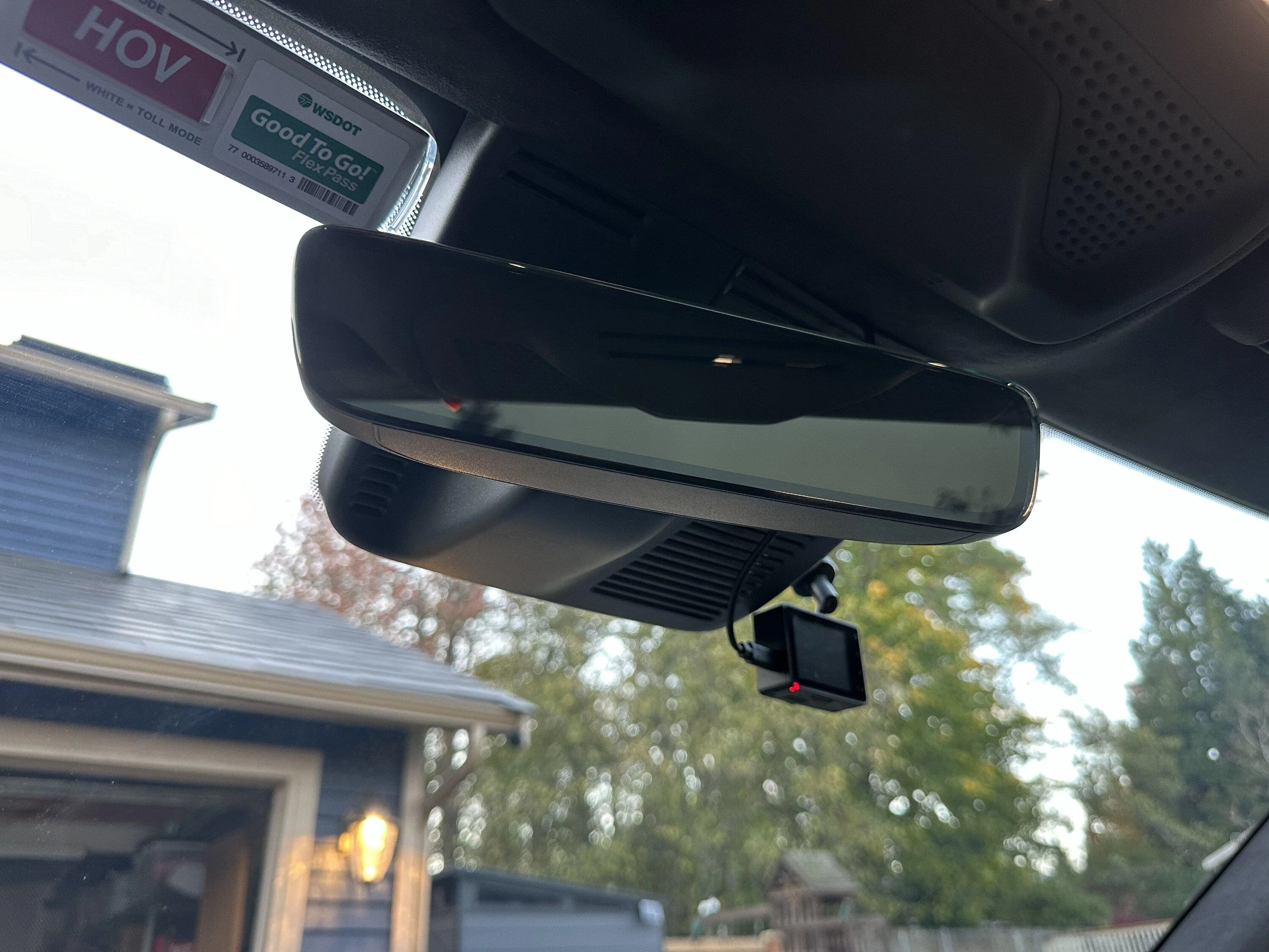

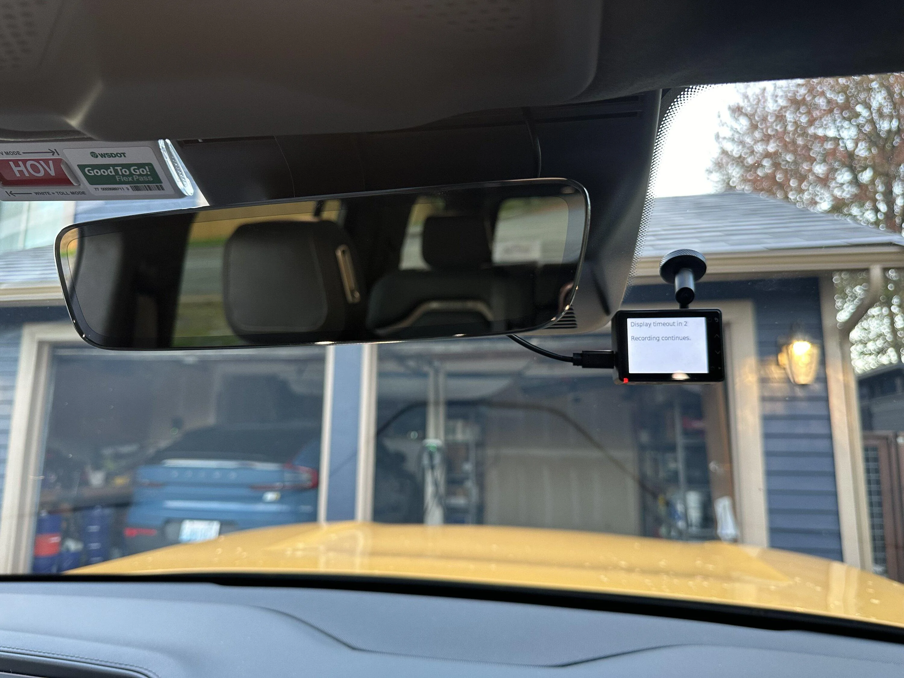

It’s no radar detector but my dash cam is installed thanks to this thread - thanks to all!
Used a step down converter to come from 12V to USB 5V was able to tape it up in the space behind the mirror cover.
Rivian R1T R1S Radar Detector hardwire, who has done it? IMG_0744
Rivian R1T R1S Radar Detector hardwire, who has done it? IMG_0748

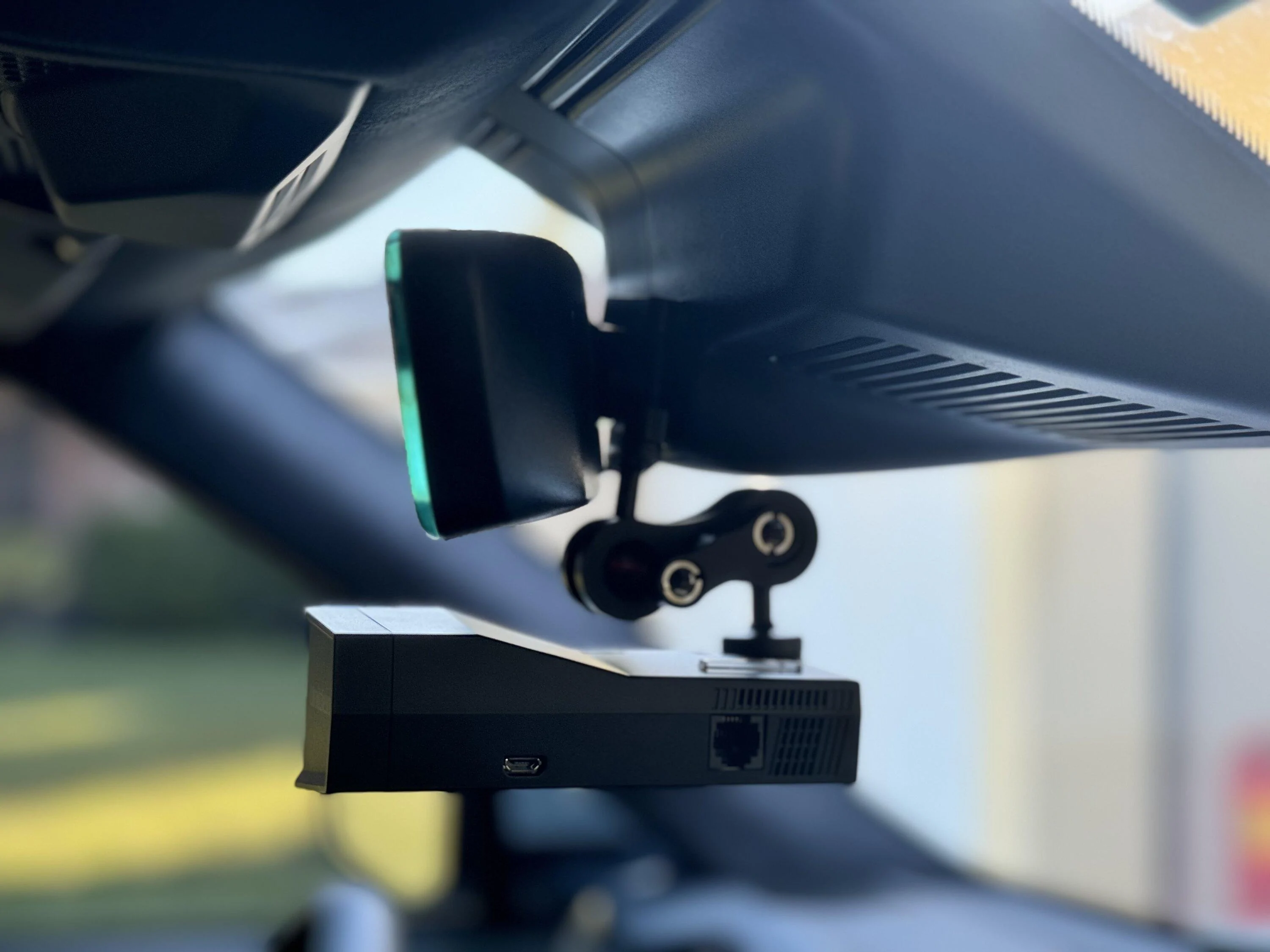

I looked up pricing for a replacement cover before I decided to go this route (In case I messed up), and I'm glad I did. It's super clean, but unfortunately, my RJ11 mirror tap doesn't provide power anymore, and I tested two radar detectors. I ordered a new one, but I'll also check fuse F63 as well. Thank for for providing all this helpful information, especially the fuses!
Rivian R1T R1S Radar Detector hardwire, who has done it? 20230623_145917
Rivian R1T R1S Radar Detector hardwire, who has done it? 20230623_145912
