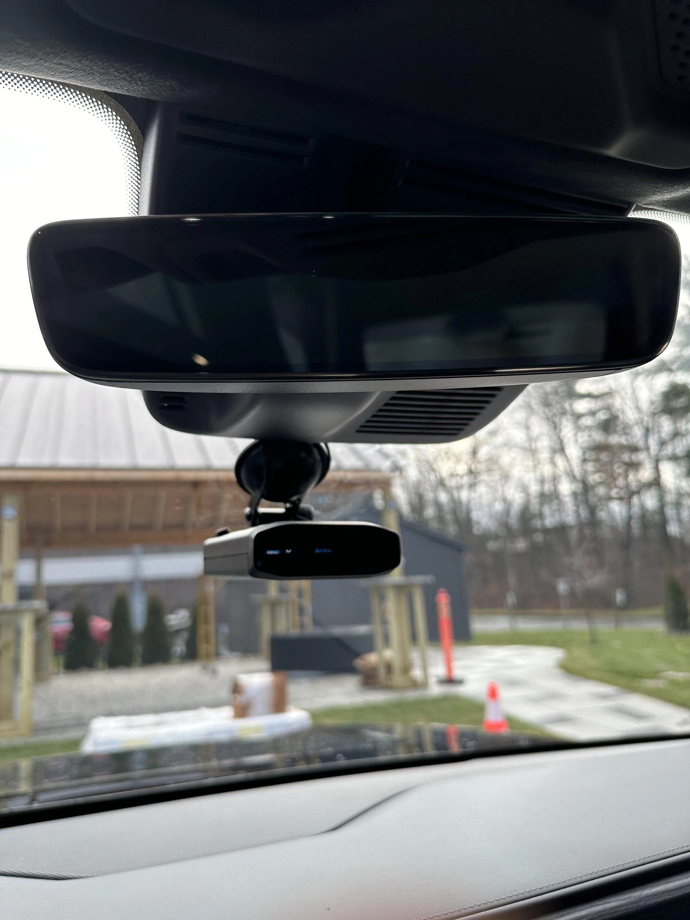

themazzman
Dec 30, 2023
Saratoga Springs, New York

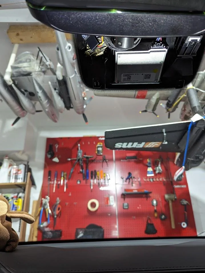

I followed this thread to (successfully) install my Escort Redline 360c. I just want to add that I used a long flathead screwdriver to pop the clips out.
I went in through the bottom opening. Started with passenger side bottom. Then driverside bottom, then passenger side top, the finally driverside top.
THROUGHOUT THIS PROCESS, while I was prying with the screwdriver towards the floor, I was pushing the rearview mirror towards the window to prevent it from coming off.
I ran the wire through the bottom for a very clean look.
Worked for me. Hope it works for you.

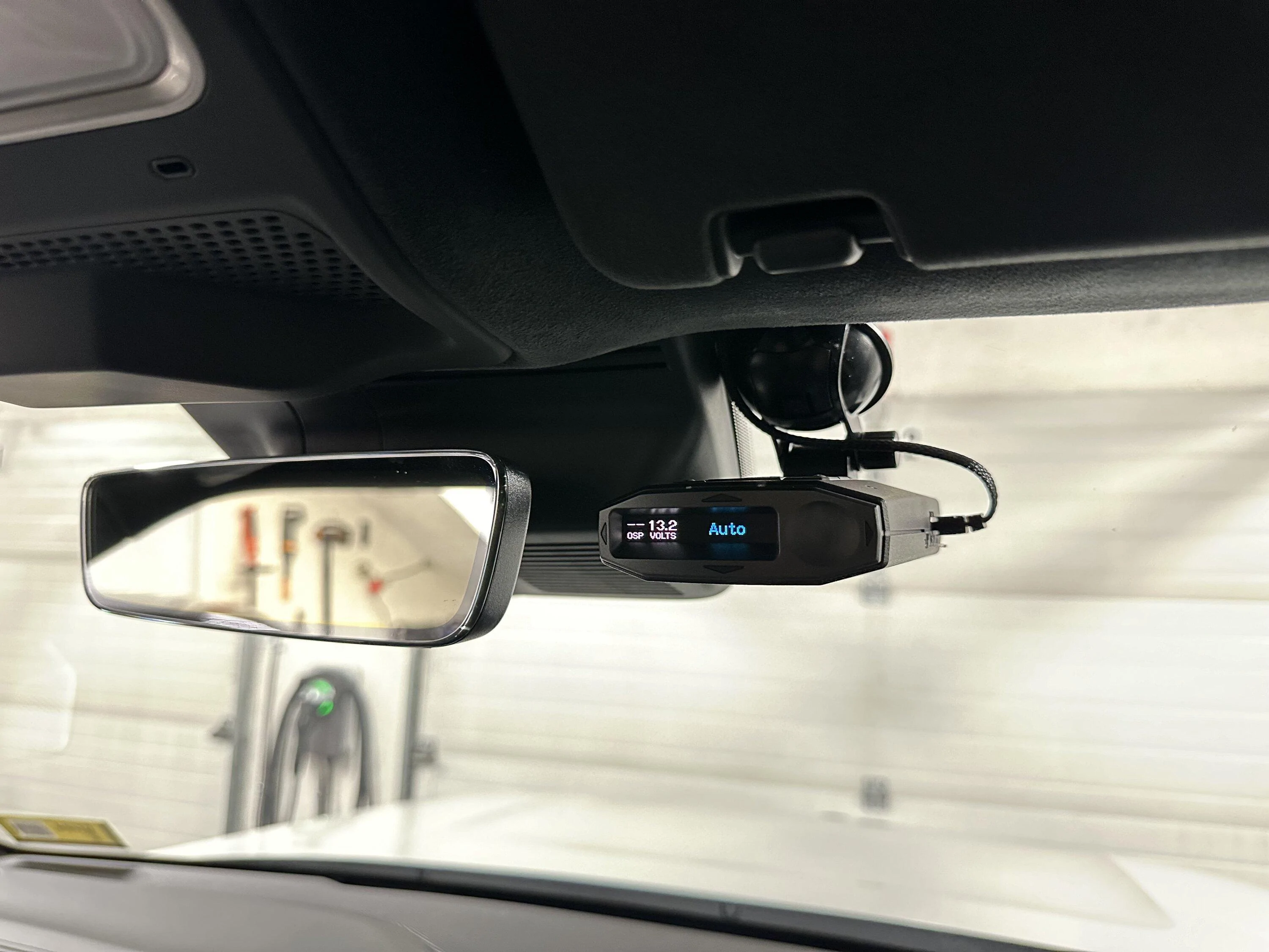

I appreciate the great resource this forum has been. I was able to quickly install my radar detector hardwired, and mounted using the BlendMount from my X3. It isnt perfect but it’s solid and I can’t do the suction cup anymore.

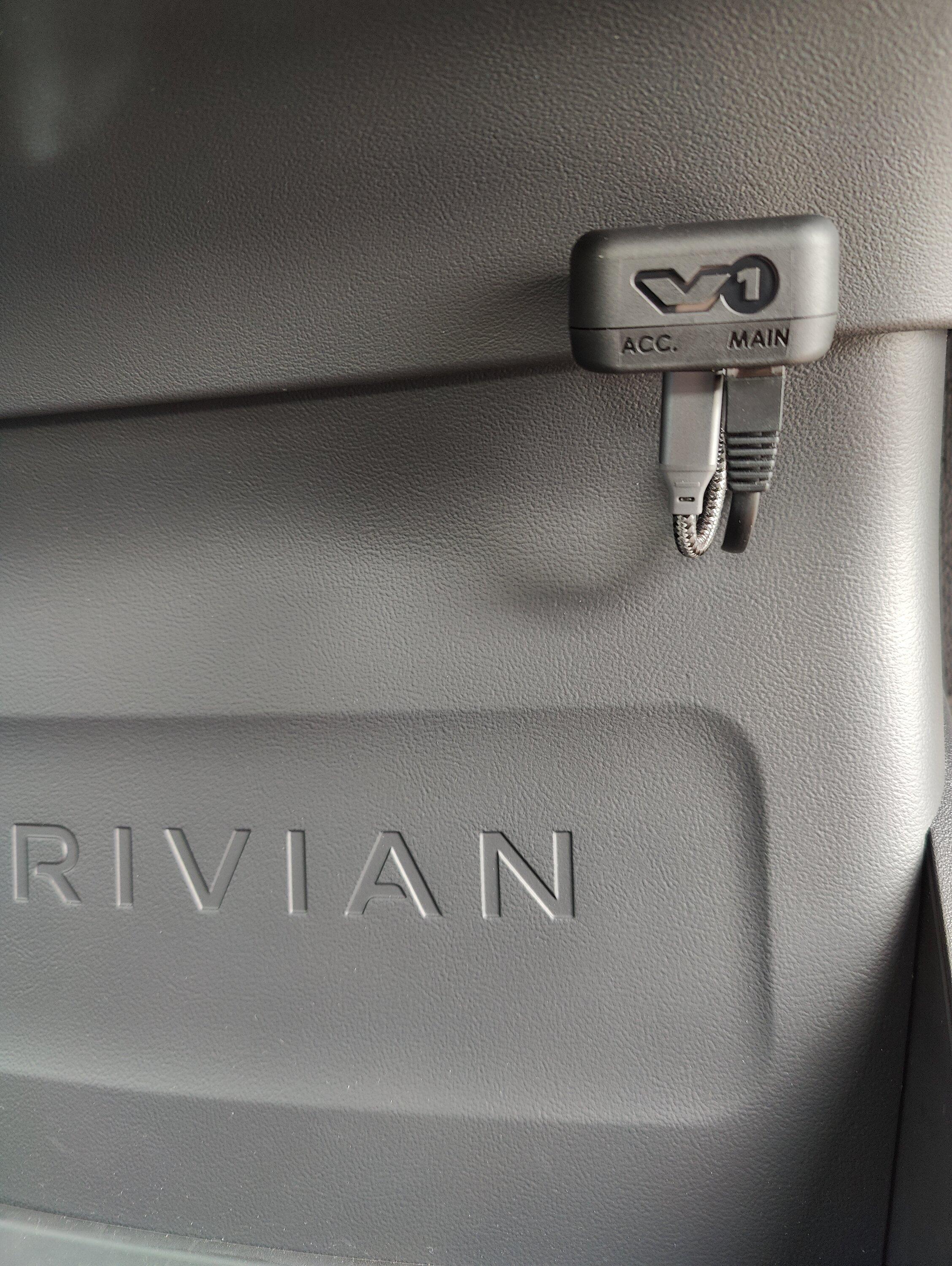

WHTEVO
Aaron
Jan 4, 2024
Self

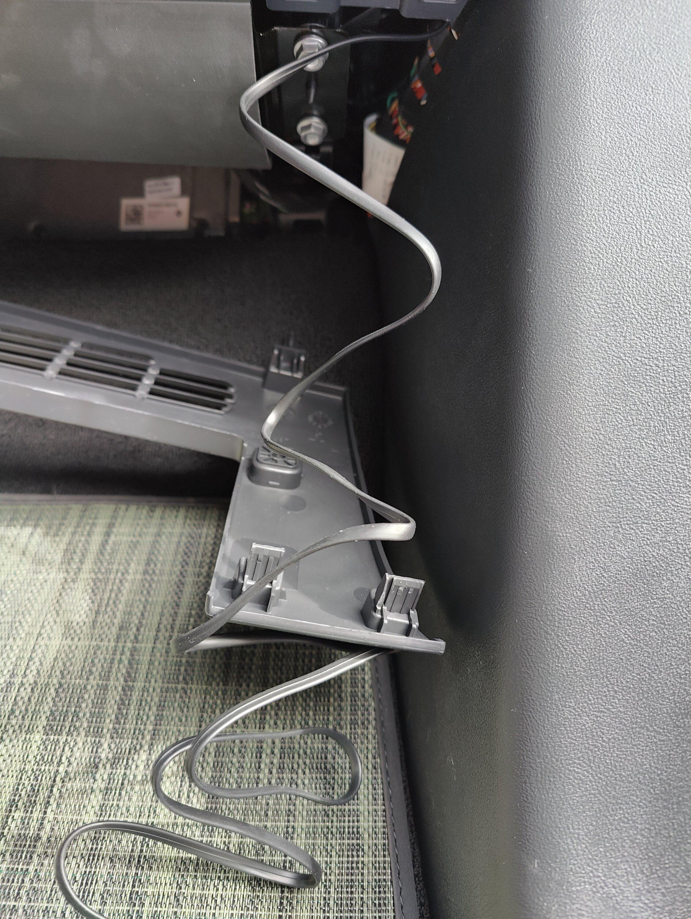

I ran mine like this. Ran the V1 cable behind the dash, down on the passenger side, under the footwell paneling, and mounted the V1 USB adapter where you see it in the pics. Then took my USB-C cable from the center console, put it into/ behind the trim running along the center floor "storage" area and up into the adapter. I didn't want to tap into any actual wiring like I normally do in case something pops up and they try and deny any sort of electrical warranty.
Rivian R1T R1S Radar Detector hardwire, who has done it? IMG20240107113042
Rivian R1T R1S Radar Detector hardwire, who has done it? IMG20240107155008
Rivian R1T R1S Radar Detector hardwire, who has done it? IMG20240107125513
Rivian R1T R1S Radar Detector hardwire, who has done it? IMG20240107113049

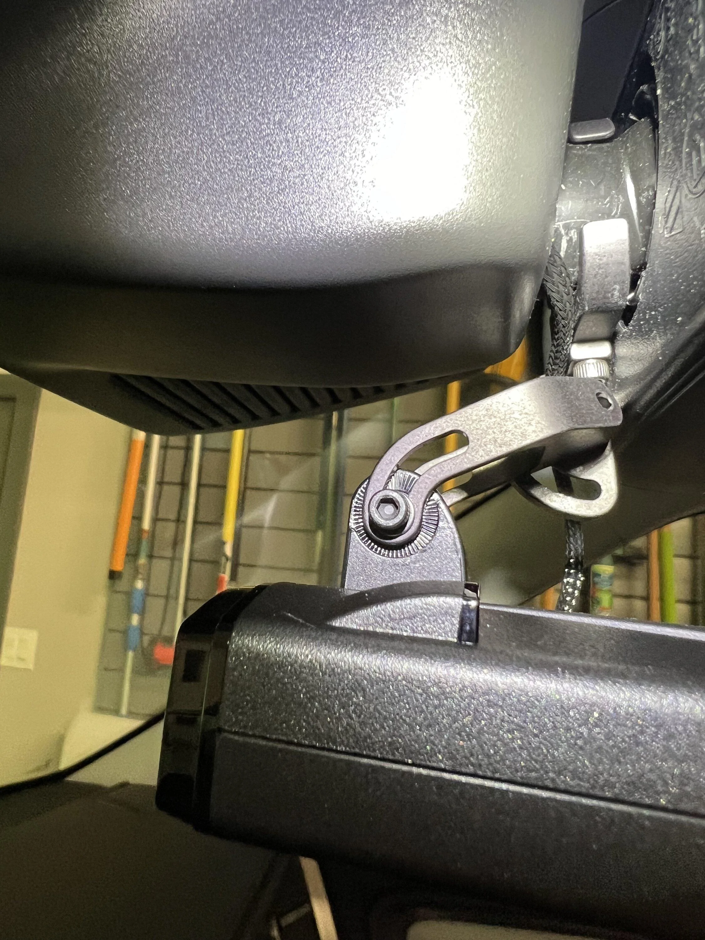

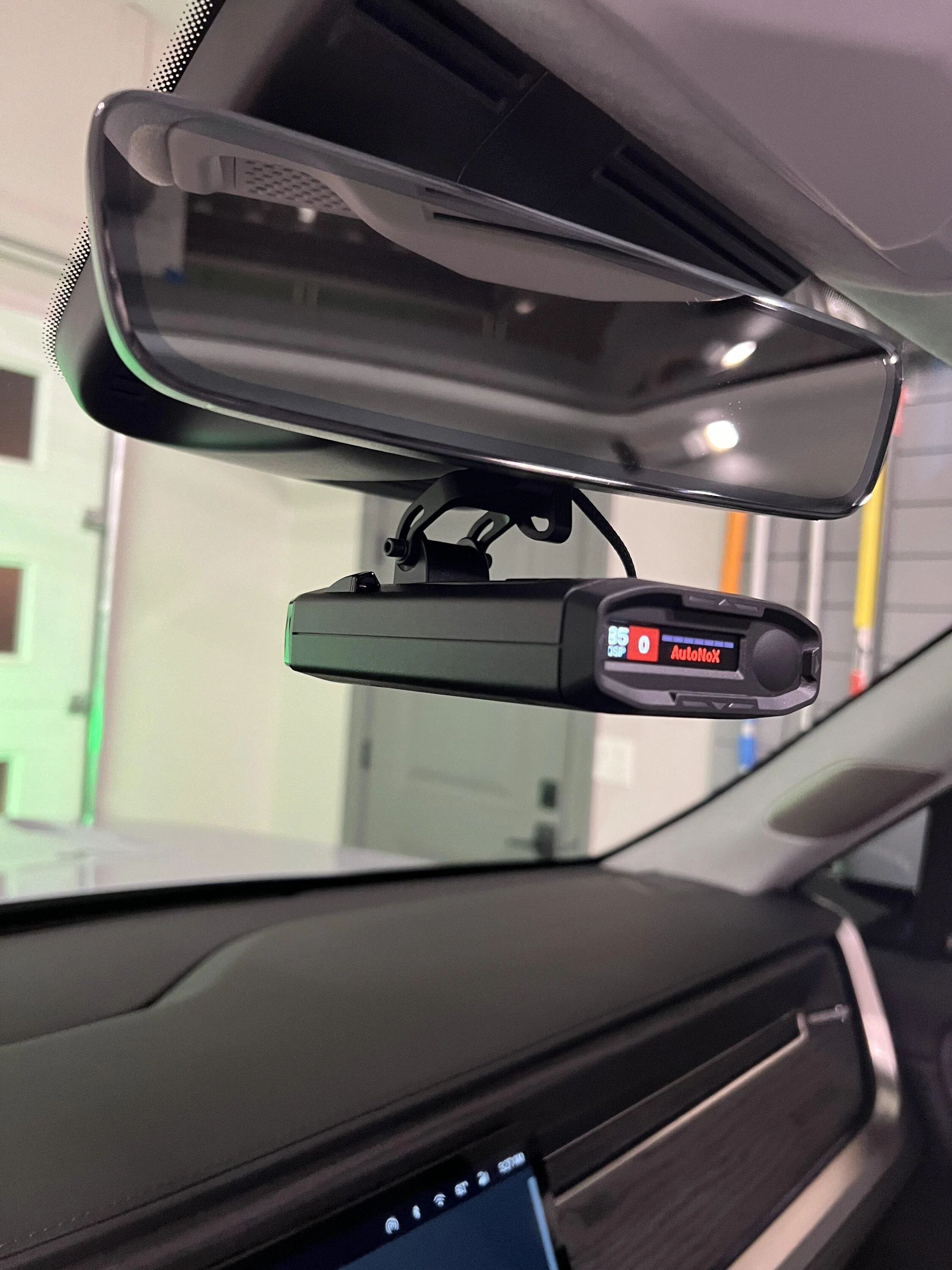

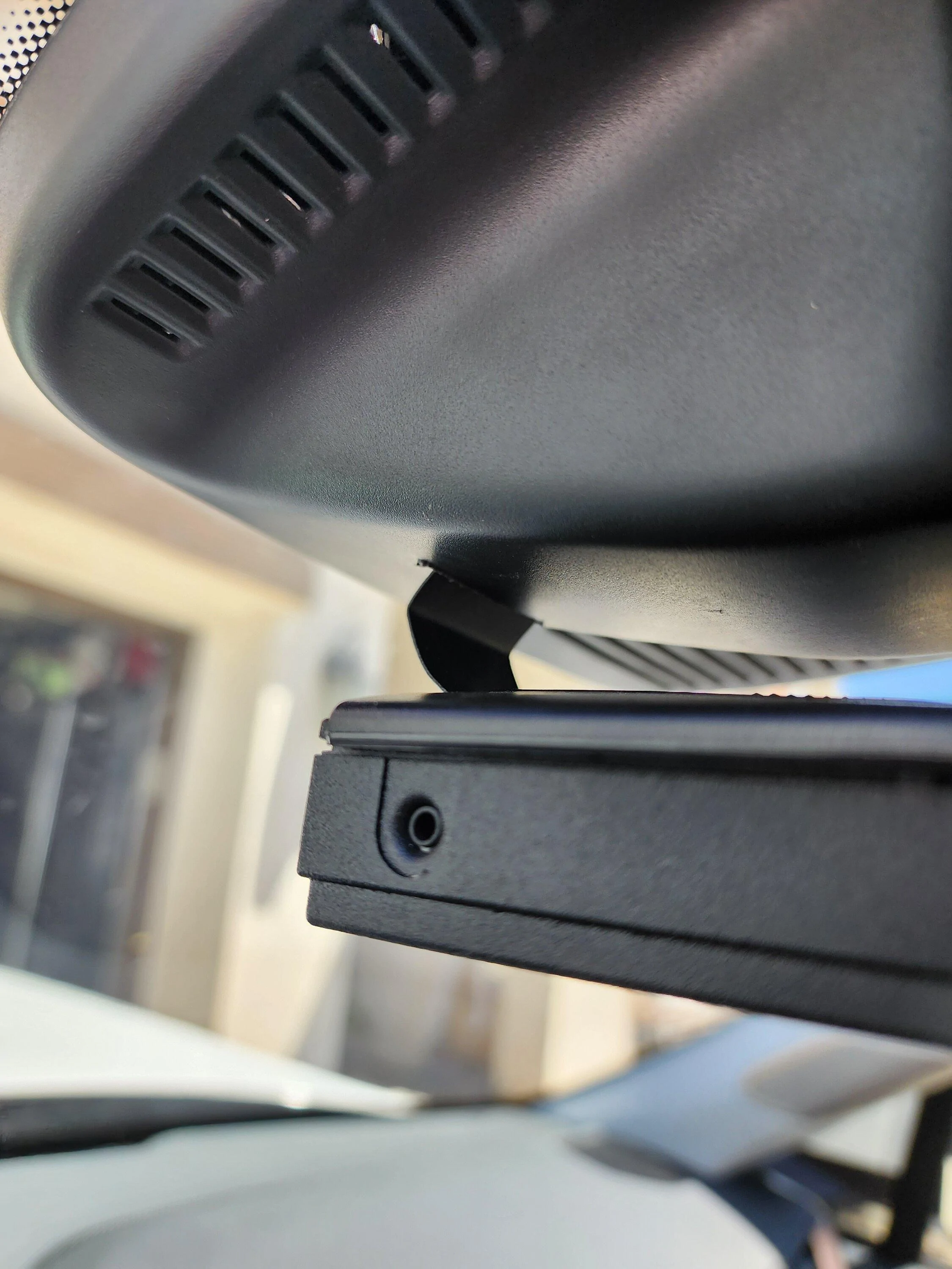

It was for a 2019 X3 using the Escort Redline 360C detector. Part numbers below copied from the order.
Aluminum Radar Detector Mount BMG-3032 Compatible with EZ Mag Mount Custom Fit
BMG-3032
Radar Model: Escort RedLine 360c, Vehicle Info (Year/Make/Model): 2019 BMW X3​
Here are a couple pictures of it mounted.
Rivian R1T R1S Radar Detector hardwire, who has done it? IMG_5932
Rivian R1T R1S Radar Detector hardwire, who has done it? IMG_5931
Do you have more details you can share on how you did it?
WHTEVO
Aaron
Jan 4, 2024
Self
Any particular detail you are looking for? As far as getting the cable down the back of the dash, I just used a fish tape, or you can use a metal hangar, then pulled the lower paneling to open up the area behind/ under the dash, and pulled the wire through that area. Mounted the V1 accessory adapter ( https://store.valentine1.com/store/item.asp?i=20240 ) where you see it in the pic, which can be used for any radar detector since the power plugs are the same. Then used a long USB-C cable to plug into the center console area and ran that cable between the inner and outer trim that runs along the center, which just pulls out from the clips that hold it in place. Hope that helps. Good luck.

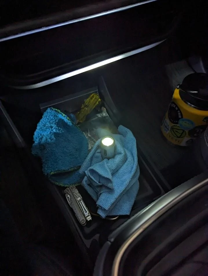

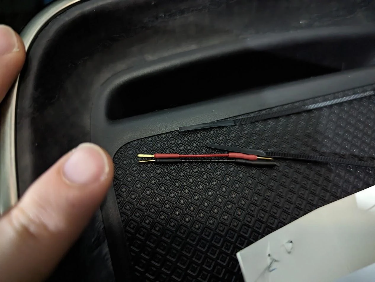

Hey all,

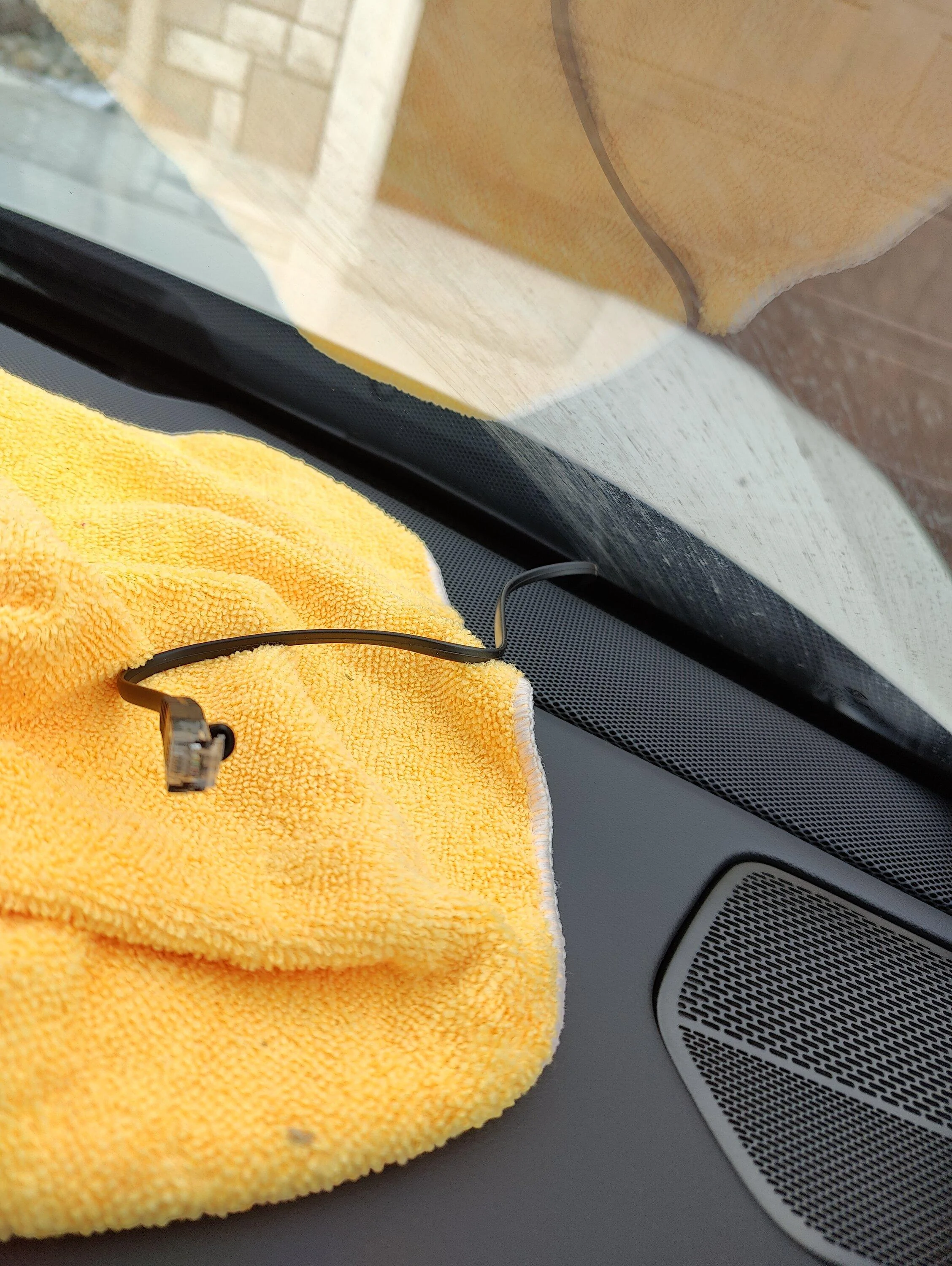

First I wanted to just thank you all for your knowledge and posting, I was able to knock this project out in no time.
I used this mirror tap: https://www.amazon.com/dp/B00L2SVV2U?psc=1&ref=ppx_yo2ov_dt_b_product_details
Use the smallest pins, by the way here are 2 images for scale, they're pretty dang small.
Rivian R1T R1S Radar Detector hardwire, who has done it? PXL_20240224_122629502.MP
I also discovered that if you set the Rivian Torch up on the floor pointed up, it perfectly spotlights the area of work, without blasting yourself in the face with a light.
Rivian R1T R1S Radar Detector hardwire, who has done it? PXL_20240224_123058879.MP
Rivian R1T R1S Radar Detector hardwire, who has done it? PXL_20240224_123109148.MP
Anyway, I hope this helps future modders.
