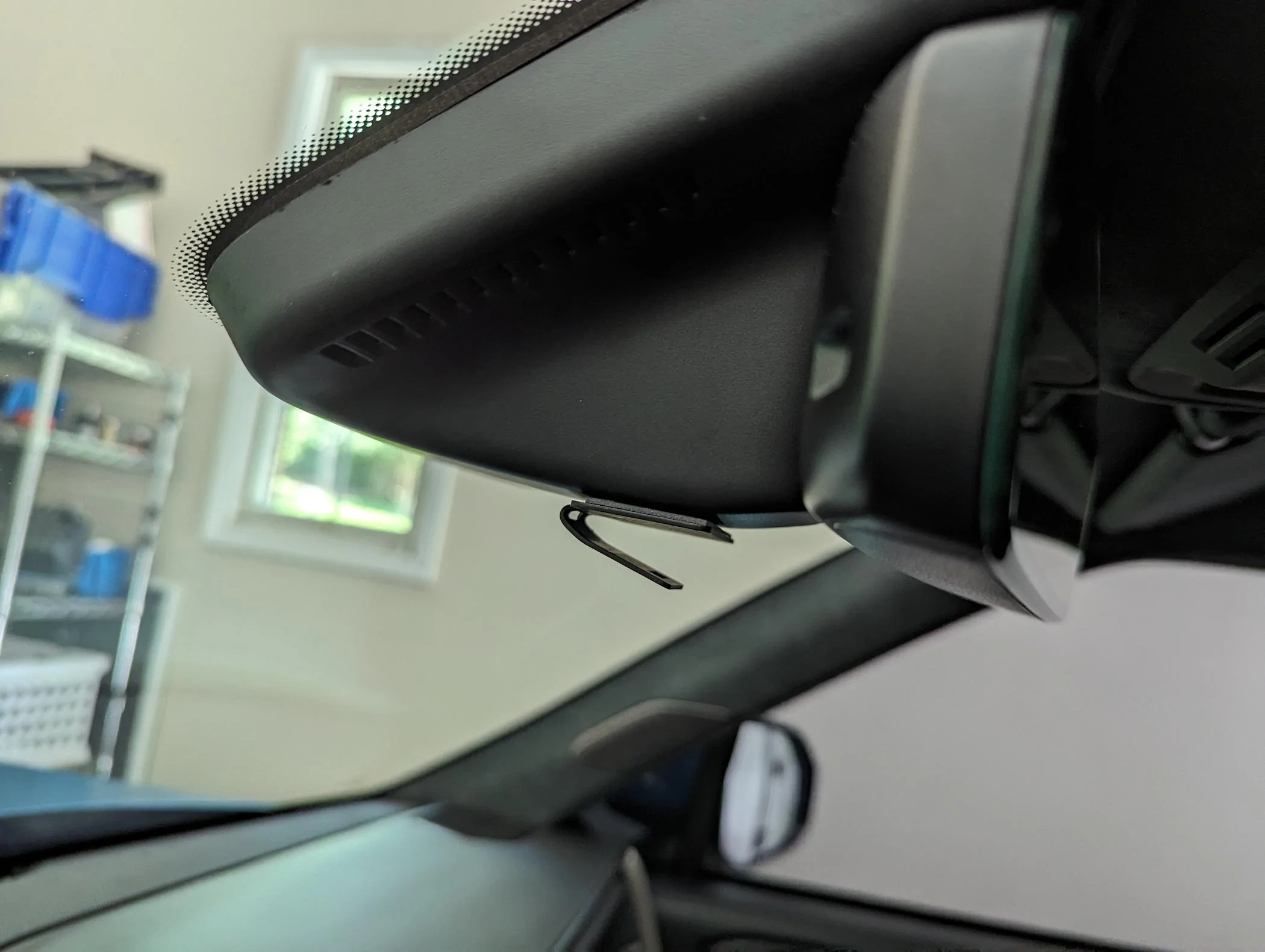

Hey all,
First I wanted to just thank you all for your knowledge and posting, I was able to knock this project out in no time.
I used this mirror tap: https://www.amazon.com/dp/B00L2SVV2U?psc=1&ref=ppx_yo2ov_dt_b_product_details
Use the smallest pins, by the way here are 2 images for scale, they're pretty dang small.
I also discovered that if you set the Rivian Torch up on the floor pointed up, it perfectly spotlights the area of work, without blasting yourself in the face with a light.
Anyway, I hope this helps future modders.
Phil

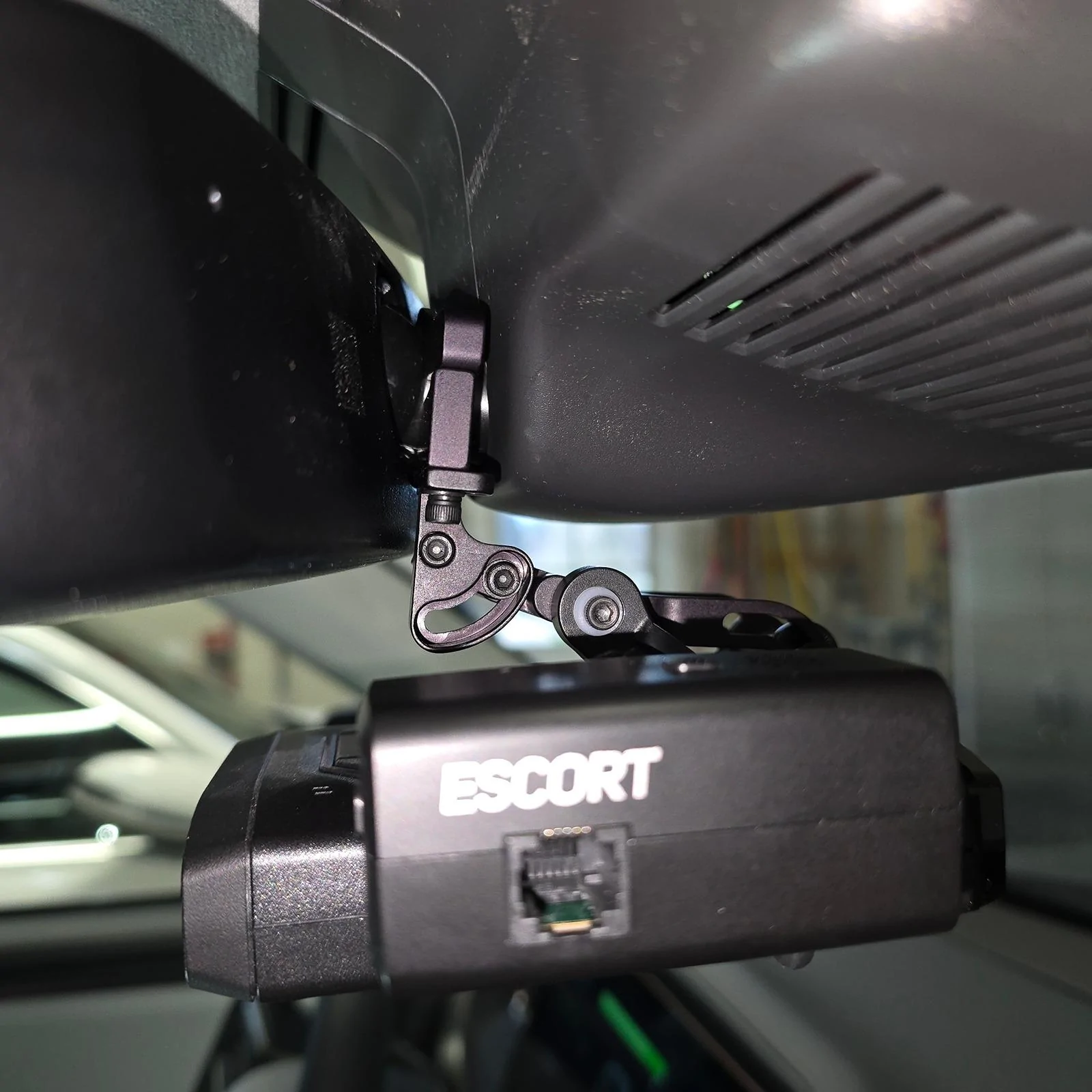

It was for a 2019 X3 using the Escort Redline 360C detector. Part numbers below copied from the order.
Aluminum Radar Detector Mount BMG-3032 Compatible with EZ Mag Mount Custom Fit
BMG-3032
Radar Model: Escort RedLine 360c, Vehicle Info (Year/Make/Model): 2019 BMW X3​
Here are a couple pictures of it mounted.
Ordered the same mount and it worked great! Thanks for sharing!

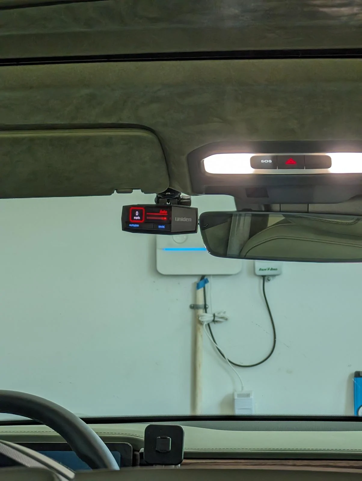

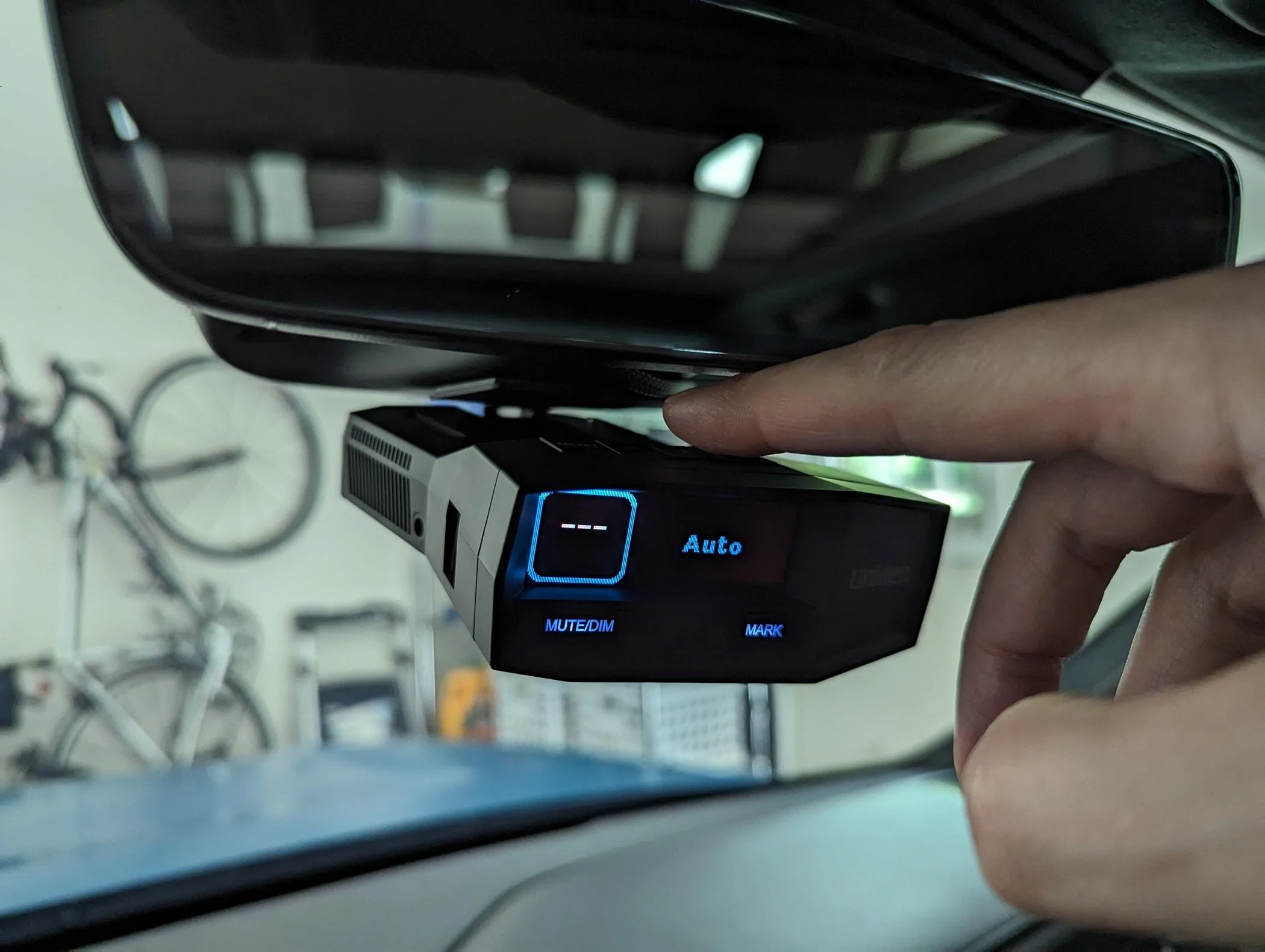

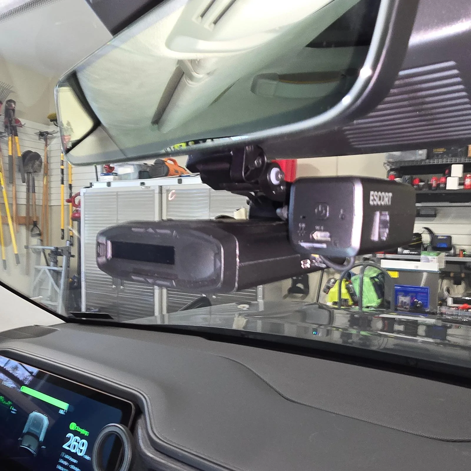

I tried quite a few solutions and oddly the simplest is my fav.
Uniden R8. Hardwired with a mirror tap kit. Mounted with a generic modified eBay bracket. Affixed to rearview with 3M adhesive.
Rivian R1T R1S Radar Detector hardwire, who has done it? 1000006748
Rivian R1T R1S Radar Detector hardwire, who has done it? 1000006750
Rivian R1T R1S Radar Detector hardwire, who has done it? 1000006752
Bend leaves just enough room to access top mounted buttons.
Surprised I liked this one the most. Simple, tight, and tidy.

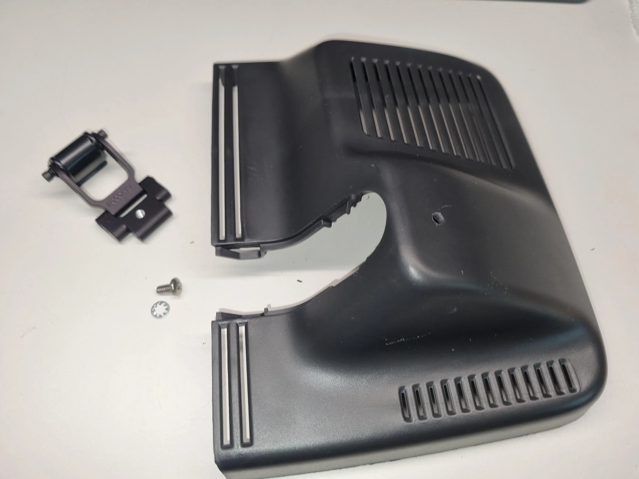

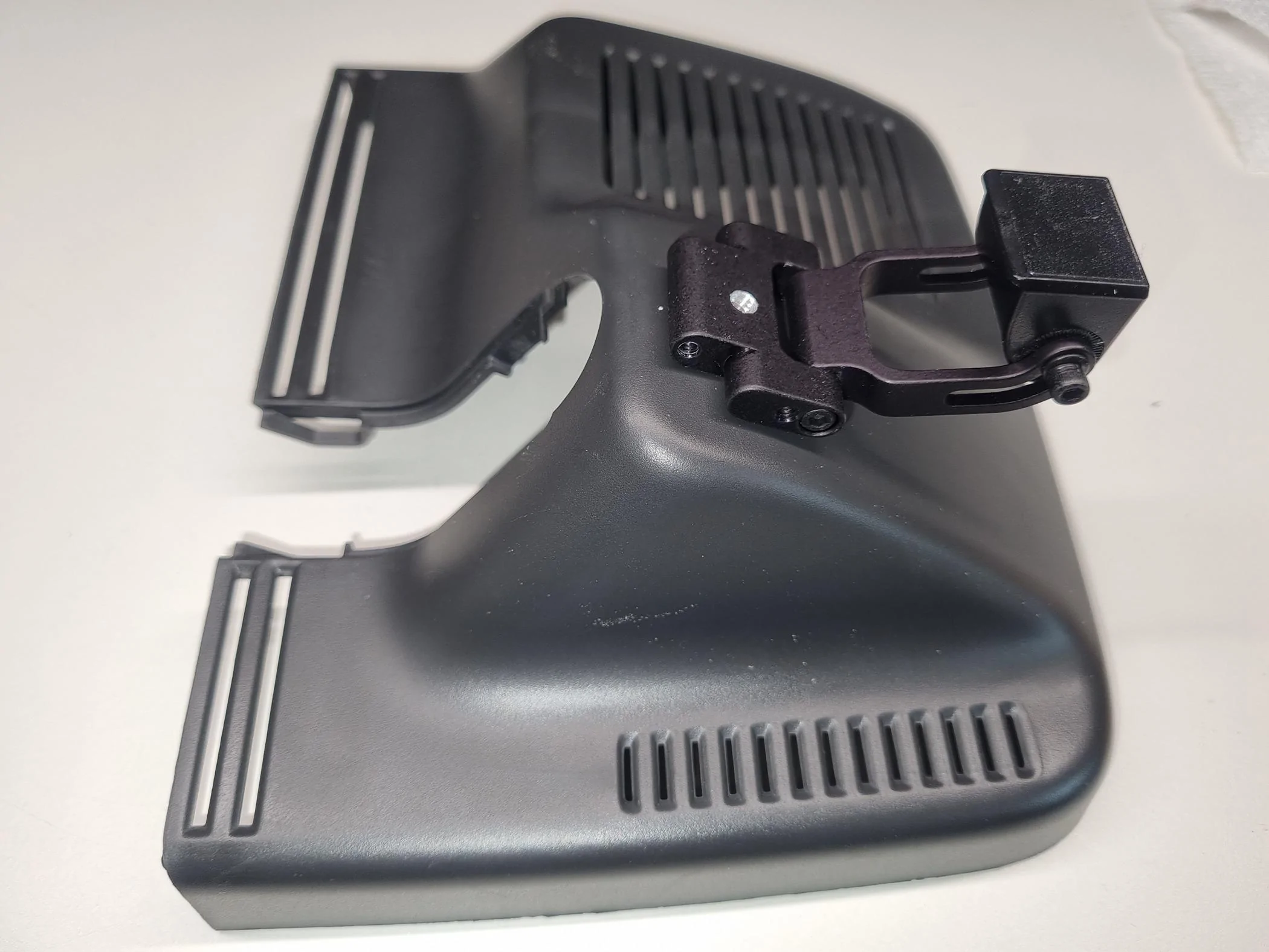

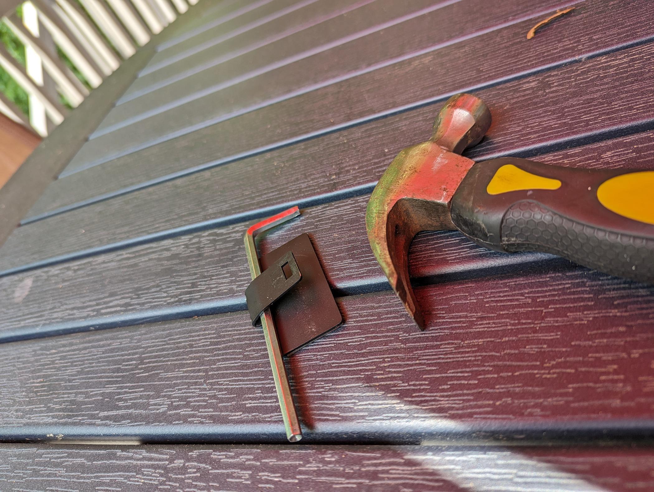

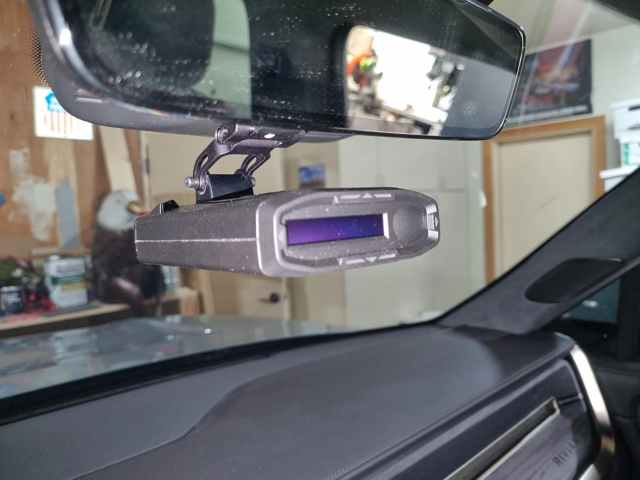

I opted to use the 'Blendmount' RD mounting bracket. However the ring clamp for the mirror arm is too think and severely limited the movement of the rearview mirror.
So I removed the ring clamp portion and drilled/tapped the center piece for a 10-24 screw. I then drilled a clearance hole in the cover and mounted the Blendmount to it.
A feature of this method is that the RD swivels towards the driver which was not possible when mounted to the mirror arm.
Rivian R1T R1S Radar Detector hardwire, who has done it? 20240427_144208
Rivian R1T R1S Radar Detector hardwire, who has done it? 20240427_144514
Rivian R1T R1S Radar Detector hardwire, who has done it? 20240427_145046

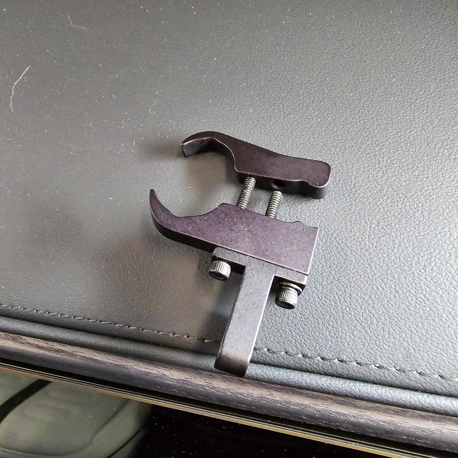

The exposed portion of the Rivian mirror arm is not enough for the Blendmount to work as designed. It would have to be really thin which would make it prone to breakage.
Except for the reality that @DiggingHoles shared his experience with Blendmount's BMG-3032 mount working on Rivian's short tapered mirror shaft, which I was able to repeat without any modification. It took some salty language as I struggled with gravity and tiny socket cap screws and washers, but it fit and works. YMMV, it isn't blessed by Blendmount and they disavow any responsibility of it working, but it works for me.

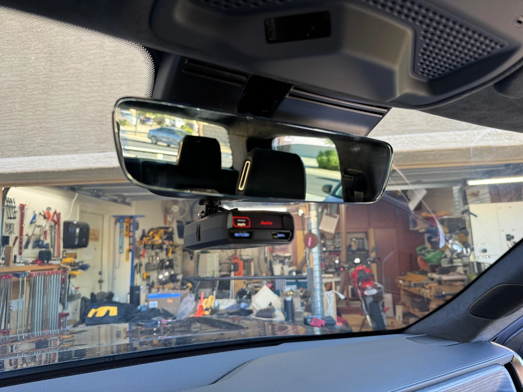

I like installing as high as possible for the greatest reach.
Rivian R1T R1S Radar Detector hardwire, who has done it? PXL_20240523_180517361
