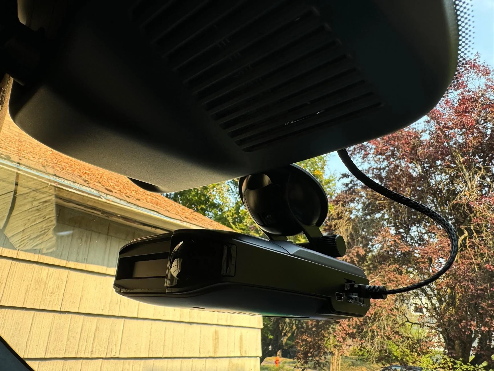

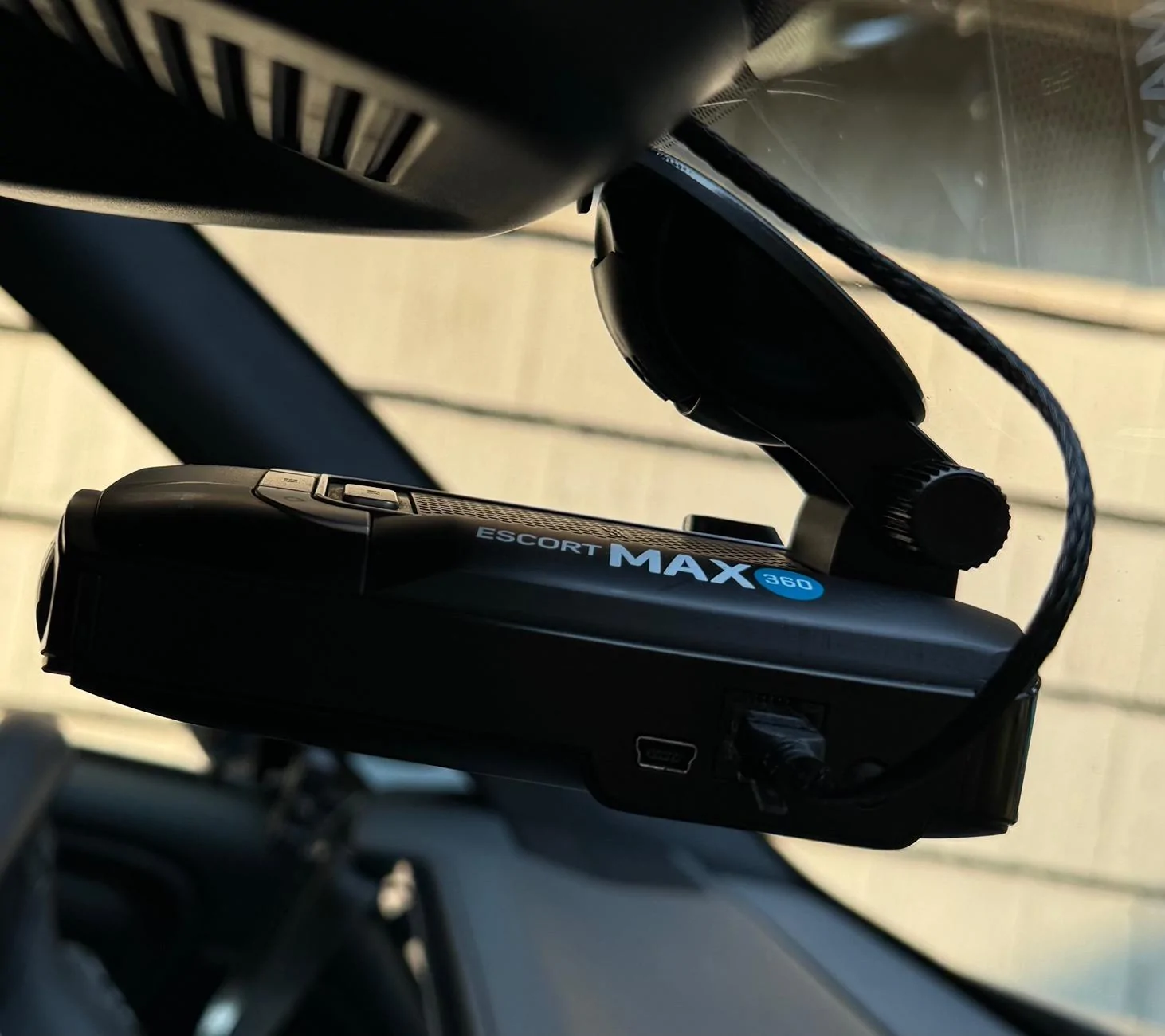

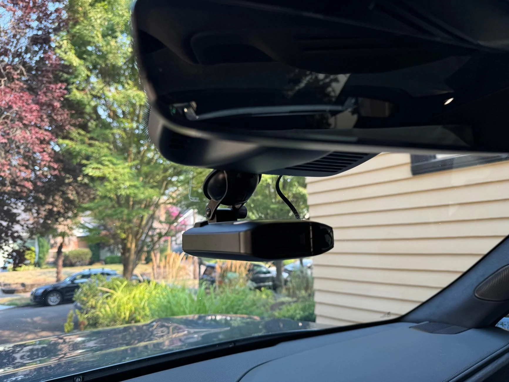

This is a "for what it's worth" post to say that I hardwired an Escort Radar Detector and it's worked great. Below is a link to the product as well as the YouTube video that walked me through it.
Radar Detector Hardwire Power Cord Kit (you get three in the pack, but the one to use is the one with the smallest ends): https://www.amazon.com/dp/B097MGX318?ref=ppx_yo2ov_dt_b_fed_asin_title&th=1
And, here is the video that made it possible (attention dude who made the video: I don’t know who you are, but I am SUPER grateful to you because your video and instructions were all I needed to do everything myself. Buy yourself a beer from me, you earned it!).
Installation video:
Like the video says, having the exact style pry tool he uses helps a lot and you have to pull down on the mirror cover like you’re trying to destroy your rig to get it to break free (it’s insane how hard you have to pull down). Just apply even force as you pull and trust it that will work out. As someone has pointed out elsewhere, it’s a $25-ish part. If you break it, it’s not going to break the bank.
