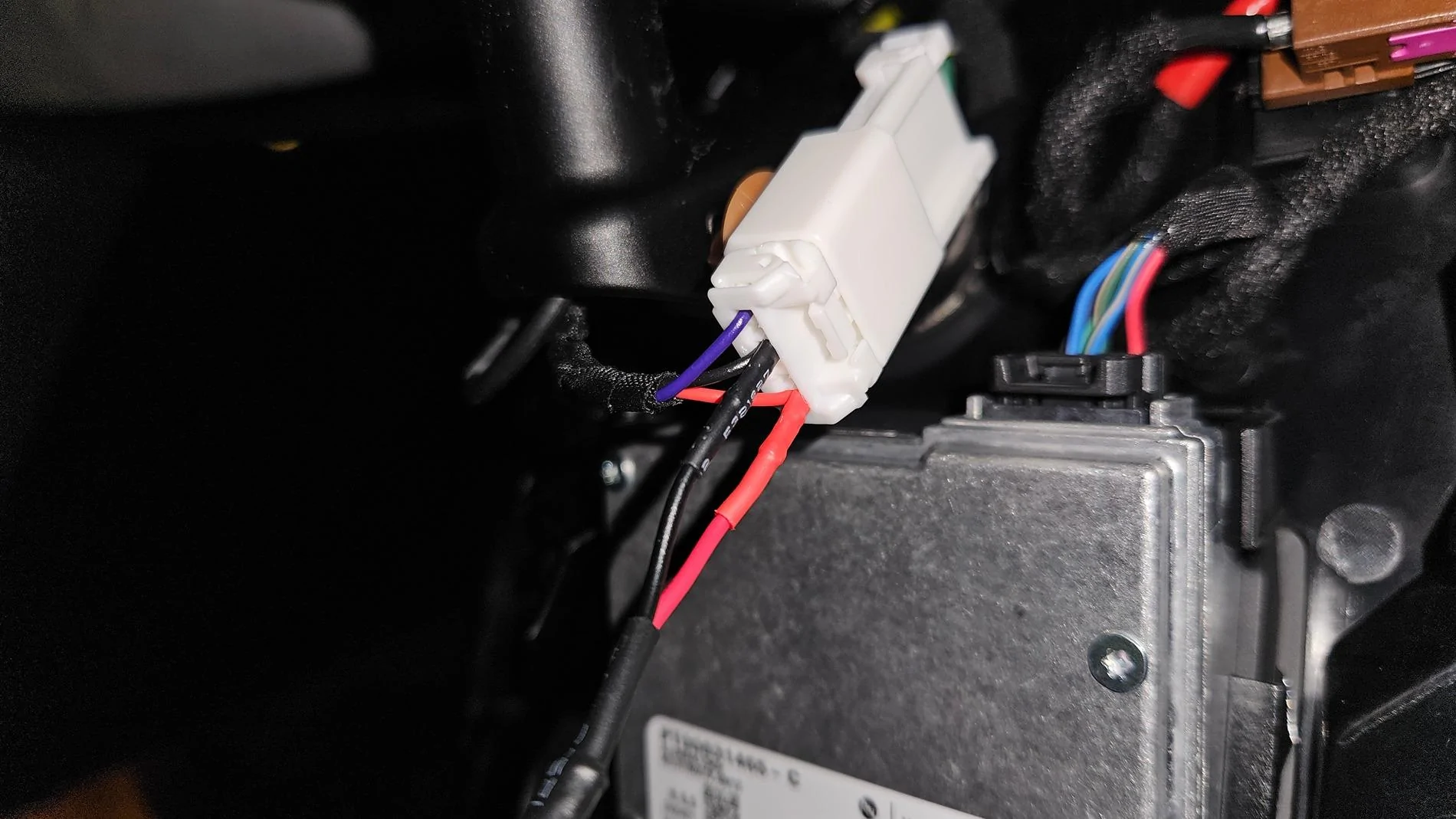

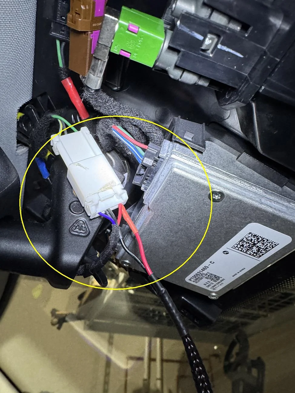

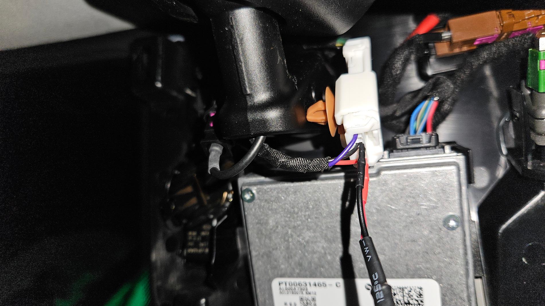

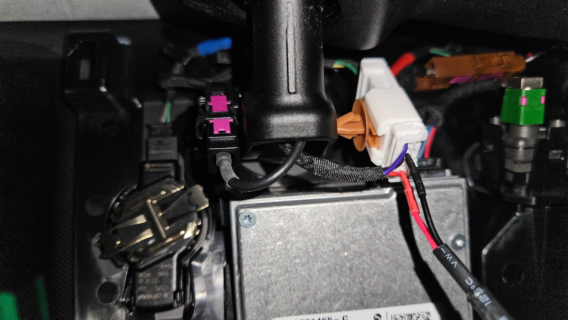

Just hardwired an escort 360 redline radar detector through the mirror power on a 2025 R1S. Worked perfectly. Here are the wires I tapped into.
Removing the cover was scary but actually easy, just pulled it from the gap in the front as the video suggested and it came right off. Didn't use any tools. Reinstalling it was even easier it just snapped right into place.
Thank you to all of you that were brave enough to go before me and share your journey on here.

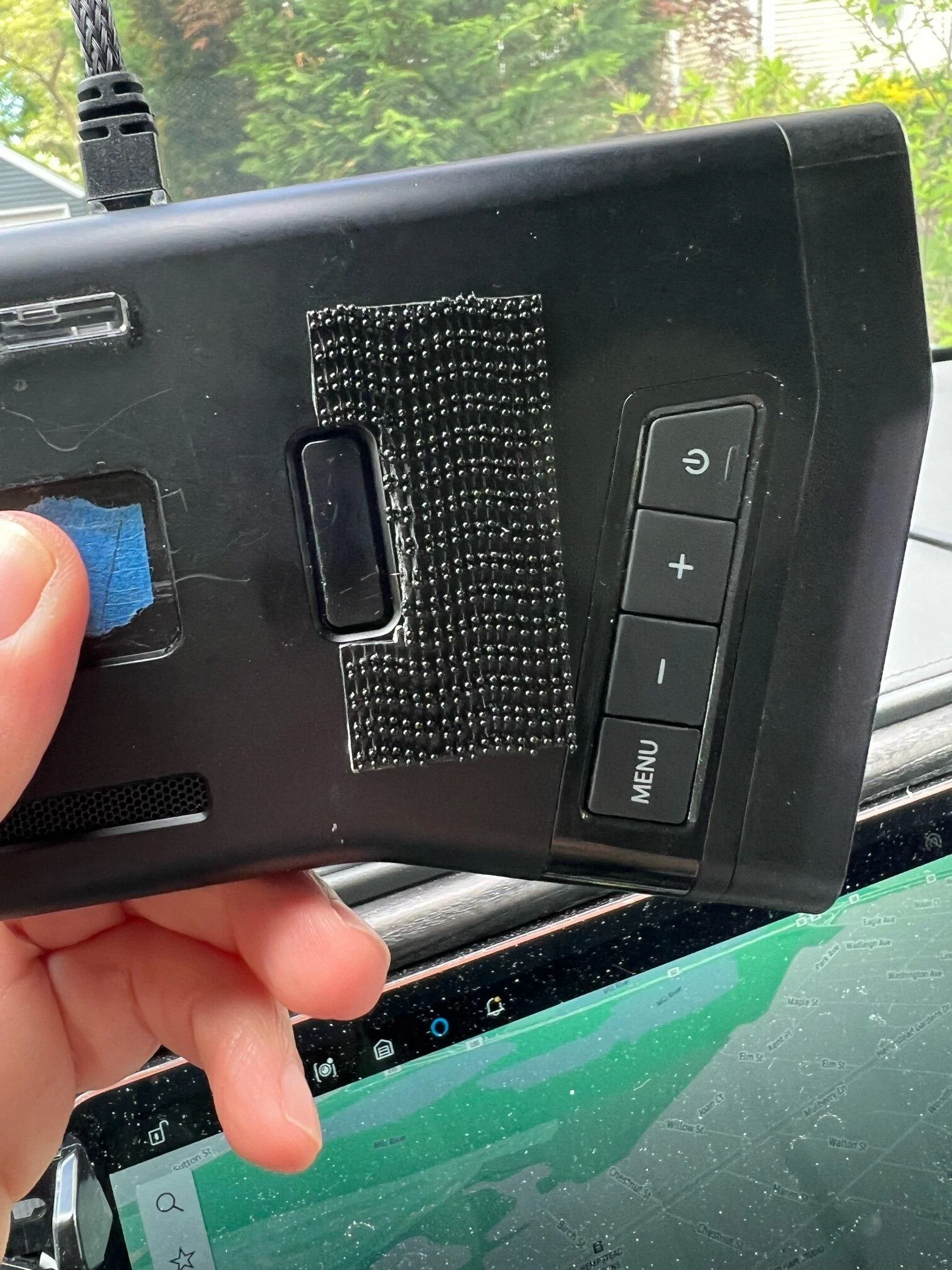

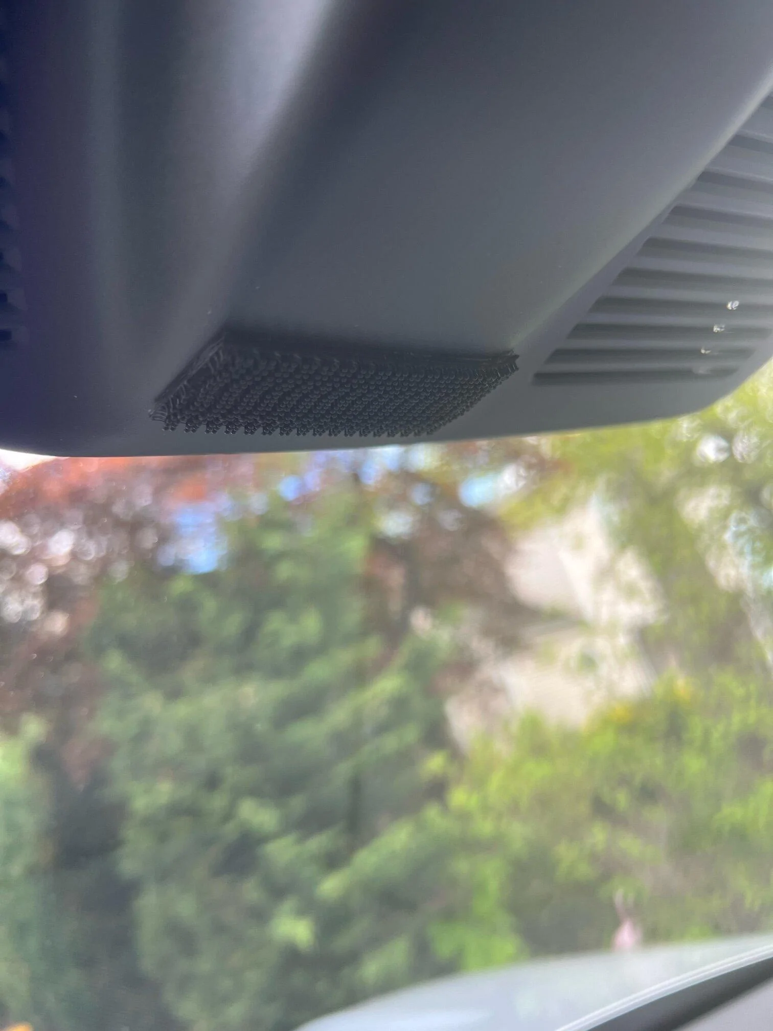

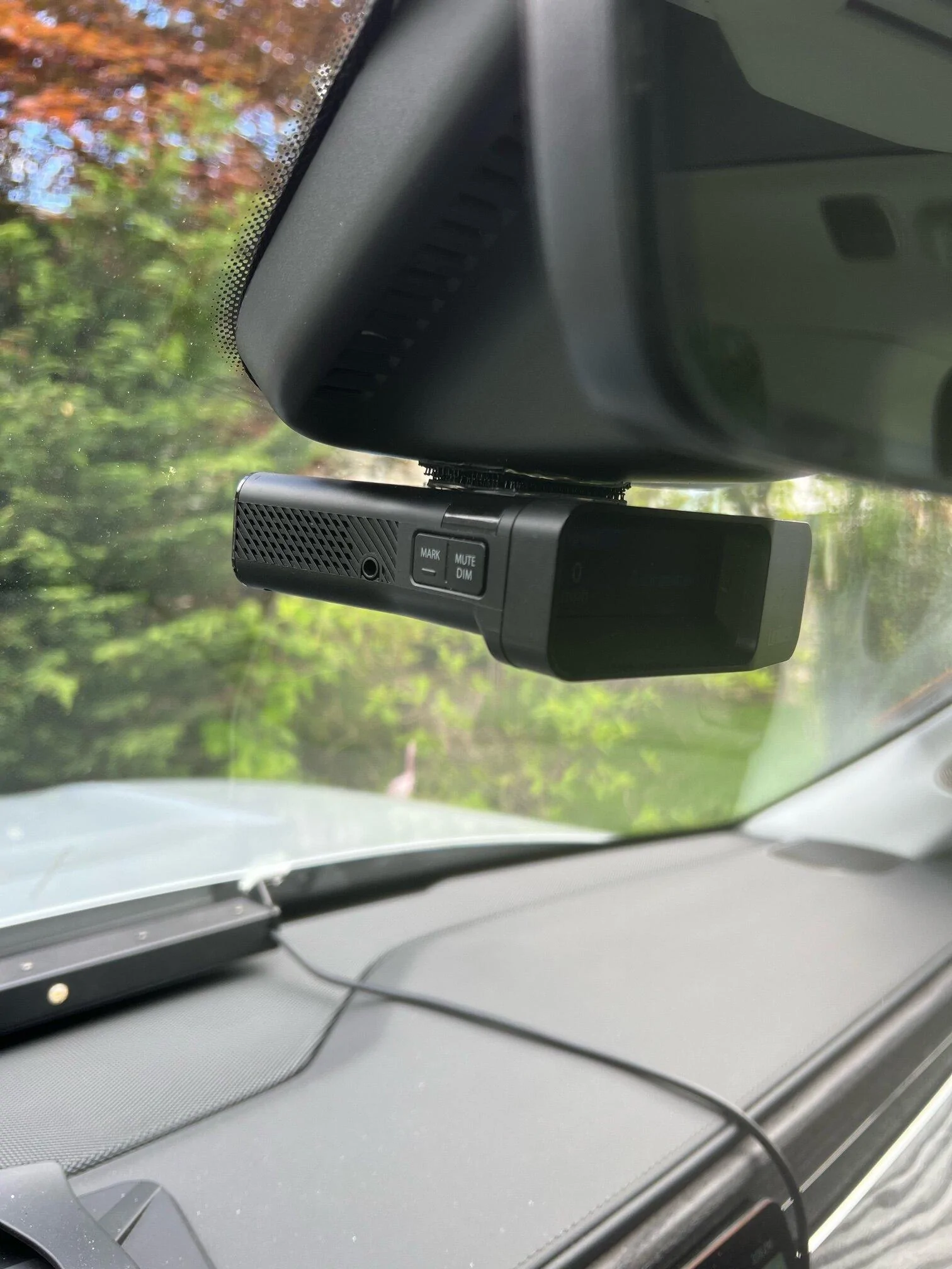

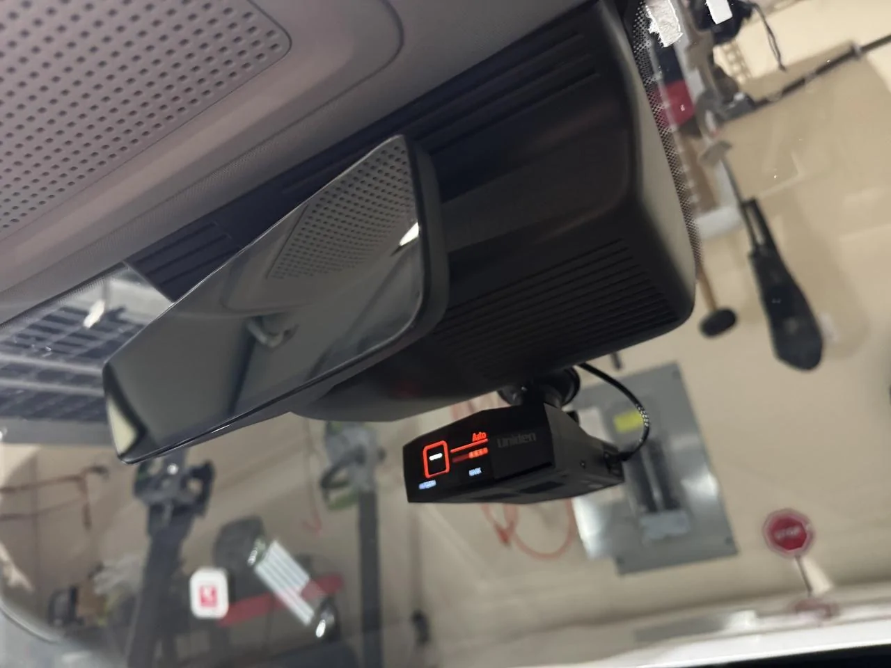

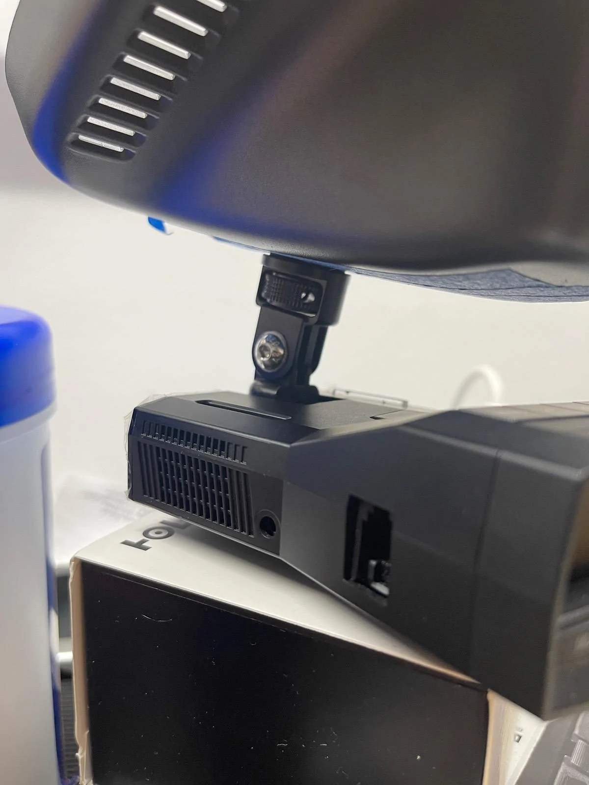

After seeing the poor built in dashcam quality I decided to install a regular dashcam. This meant relocating my radar detector.
I don't think anyone did this before and I thought it was kind of neat so here are the pics. So simple and works beautifully with my Uniden. The only button I hit on a regular basis is the mute which is on the side.
This is definitely the best way to mount the R7/8. I bought a few different clips people recommended but Velcro won and still going strong.

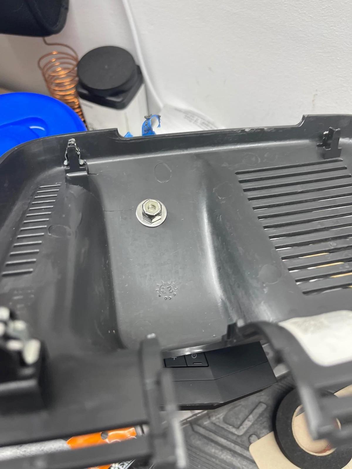

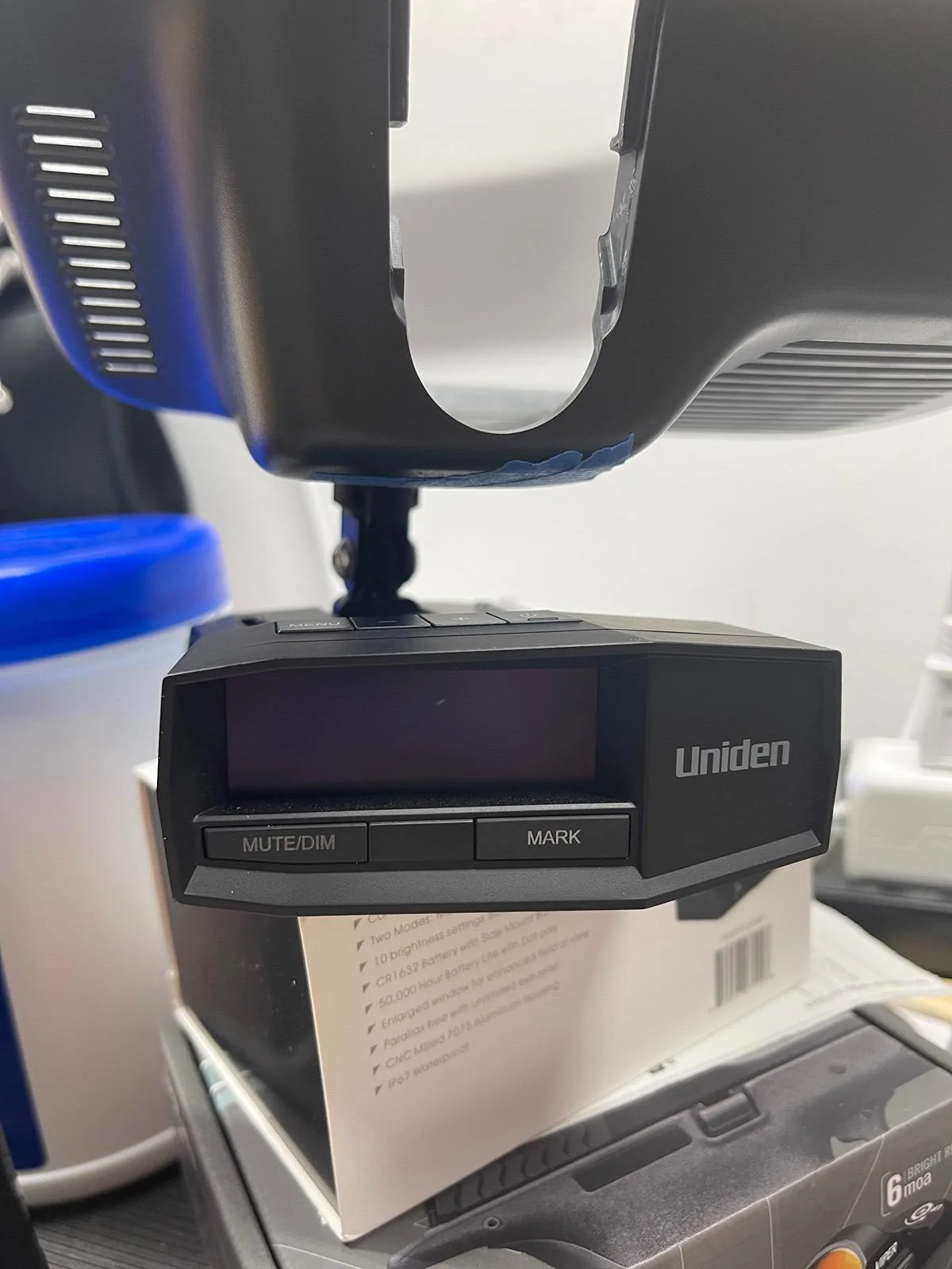

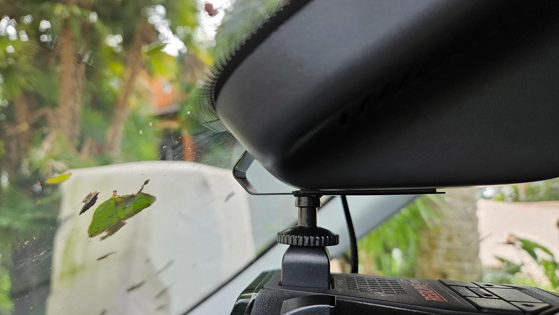

Thanks @SwampNut for the idea. Little to no vibration at all. All in for about $15-20 compared to blendmounts $170 +shipping
By the way, Rivian quoted that trim cover around $26. So nothing really lost if someone messes up and needs a new trim piece.
1/4” threads and drill bit, FYI
the socket set (metal threaded part)… idk what to call it wasn’t long enough to thread into the nylon part of the nut. I’m sure loctite will work too.
edit
Amazon link and Home Depot link for the locking bolt
https://a.co/d/0ex7M3V
https://www.homedepot.com/p/Everbil...-Steel-Nylon-Lock-Nut-3-Pack-800131/204274167
I know this was a while ago but if you're still around, what did you do to get the mount to go in far enough for the nut to have enough to grab onto?

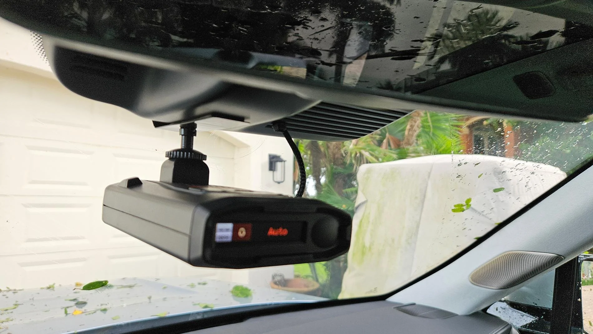

My $15 mounting solution, referenced in this thread, has been working perfectly for me. I recommend it.

Thanks to everyone in this thread, I wired it in my 2nd Gen R1T.
Getting the main cover off was no joke. When I did the last pull I knew for sure it had broken when it came flying off.
The plug was a little different than previous models it seems, there was no yellow wire. But it looked like the R1S pics above that Phazor posted.
And I zip-tied it in after this pic to make sure they don't come out.
